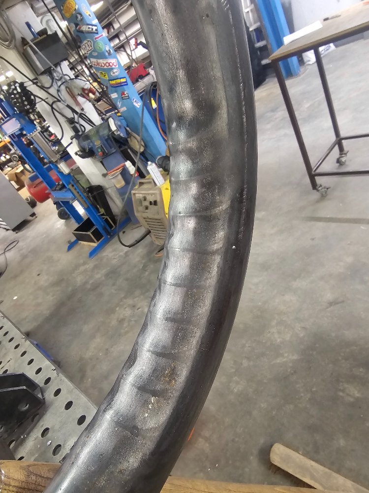

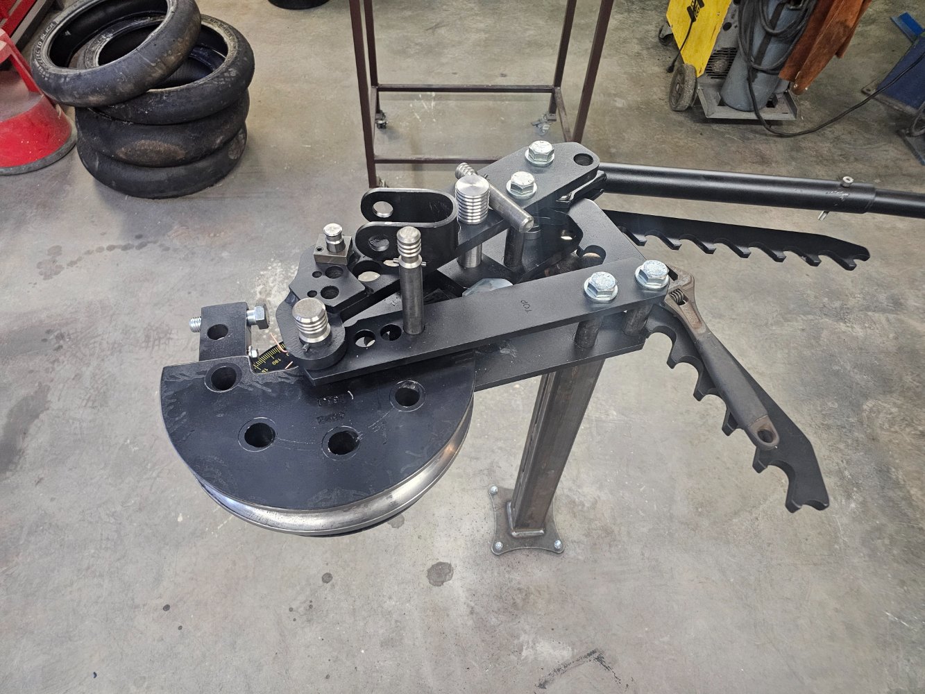

R Ruffian Member Messages 3,621 Location Devon UK Jan 27, 2026 #21 1¾ die with galv. So circa 4mm wall. Possibly your wall thickness giving you issues. 20211202_192341.jpg 100.9 KB · Views: 40 20211202_190800.jpg 236.7 KB · Views: 43 20211201_210319.jpg 293.4 KB · Views: 49

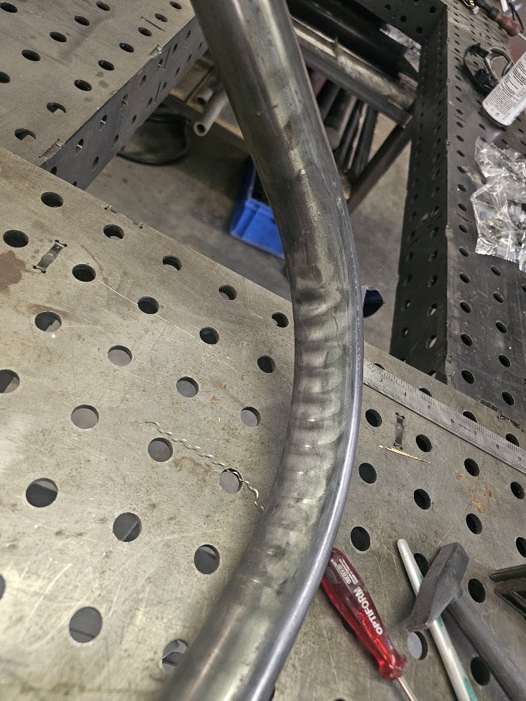

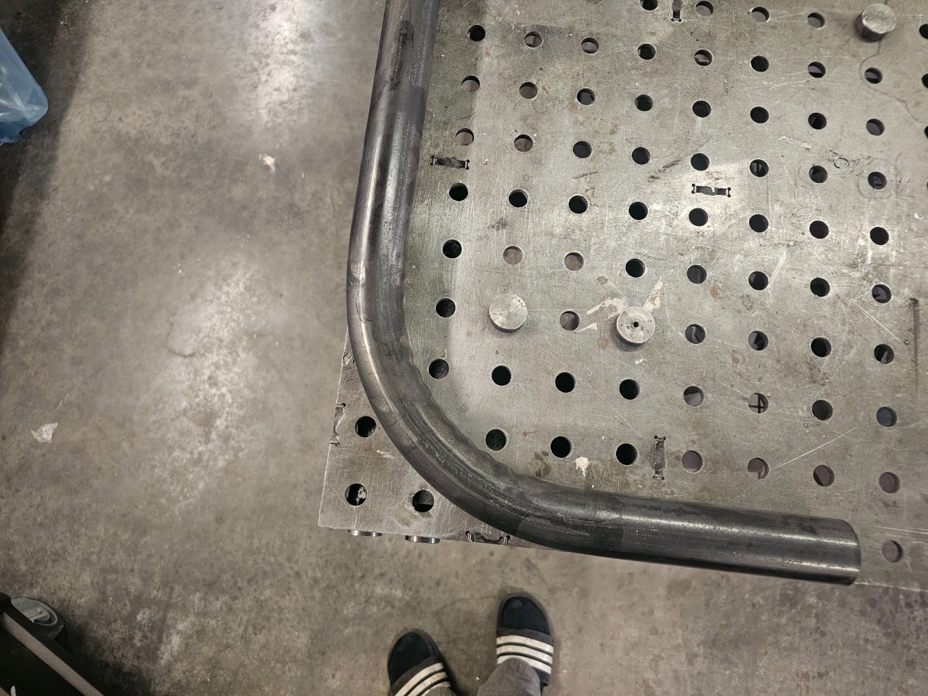

B BelgiqueB Member Messages 231 Location Belgium Feb 6, 2026 #22 Succes, did some ChatGpt research and turns out it was indeed the wrong tube, not only the wall thickness but also the composition. Ordered some EN 10305-1 E355 +N 45 mm tube and now it bends without issue
