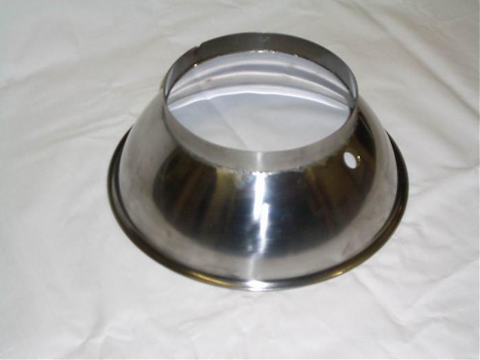

I'm trying to use my SIP Migmate 130T (yes, I know) to weld two stainless steel parts together. One is a ring or hoop made from 0.9mm stainless (316, I think), and the other is a bowl made of 0.5mm stainless, grade unknown. I don't usually have a problem with thin mild steel, and I had no problem welding the ends of the hoop together, but I'm having a real problem tacking the hoop to the bowl. I'm using 0.8mm 308L wire with pure argon.
If I turn the power down, the arc is unstable and spits, and the weld material doesn't stick to the bowl. If I turn it up it spatters a lot without penetrating, or blows a hole in the bowl (or the edge of the hoop). The spatter is fierce enough that twice I've had a blob of weld metal jump away from the arc and weld itself to the side of the bowl a couple of inches away (and had to grind it off).
I don't know exactly what the bowl is made of. It's apparently been drawn rather than spun, the metal is magnetic, very ductile (I could form a flange on another piece of it) and doesn't harden when heated to red and then quenched. I guess it's some sort of ferritic rather than martensitic stainless.
Any suggestions? I've tried playing with the power and wire speed, obviously, and I've taken a file to the surface where I want to weld. Would putting a piece of copper behind the place I want to weld help?
