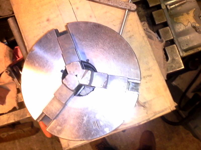

This is another Pratt chuck, came from the dividing unit going to pdg.
I decided that it would possibly be of use to me if I could clean the thing up.
It is 6 inch diameter and only has internal jaws, but it is a handy size for my own lathe as very similar to what I have, so the idea down the line is to make a backplate and use on the lathe when I have some rough jobs to do such as intermittent cuts, or where I run a risk of damage.

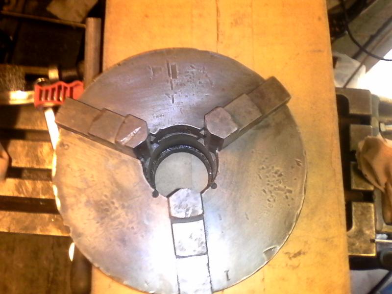

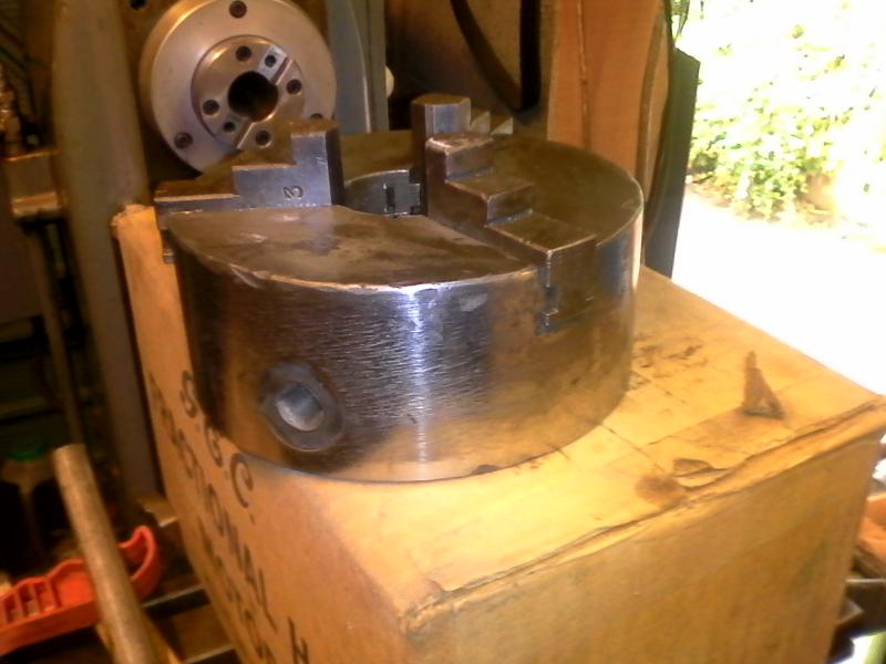

I forgot to take any pics of the strip down and clean out of all the old grease and shavings in there. It is a well battered unit with what looks like hammer marks in the side and face, even two small drill holes in the top surface.

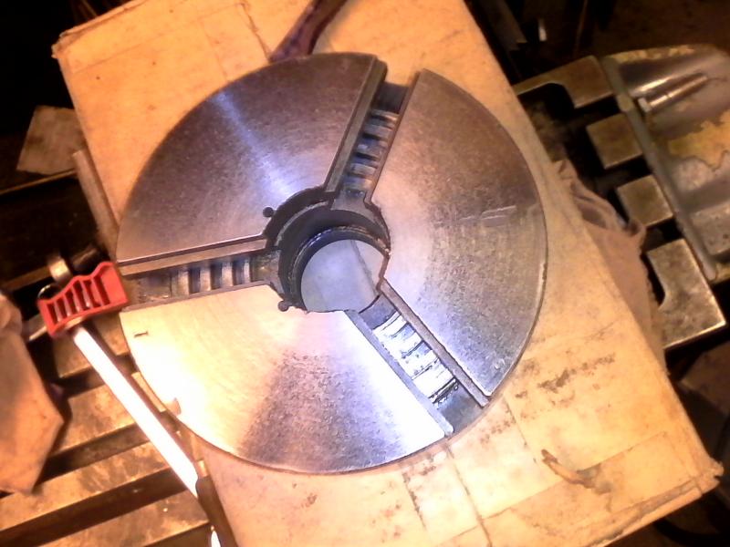

After clean it all moved freely and reasonably smooth, but I did not like all the hammer marks as mentioned.

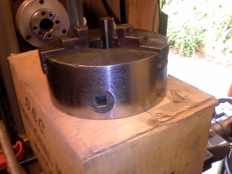

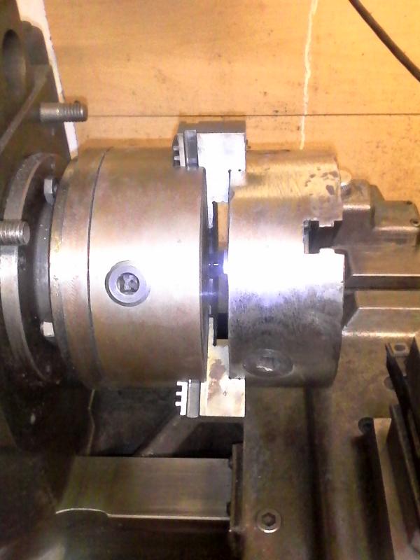

So with a bar in my lathe chuck and this one also on the same bar I took a 5 or 6 thou cut on the lathe of the outside to clean it up.

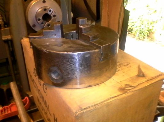

Even with the trim on the side there are still some marks left and as you can see the front face has also has some heavy marks.
But it is usable, the internal register on the back of the chuck is still OK. It can go back on a shelf after a squirt over with WD40.
