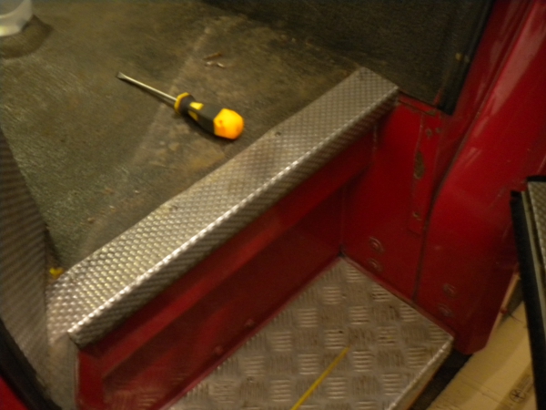

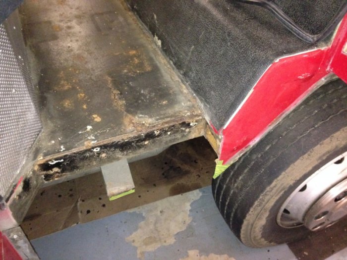

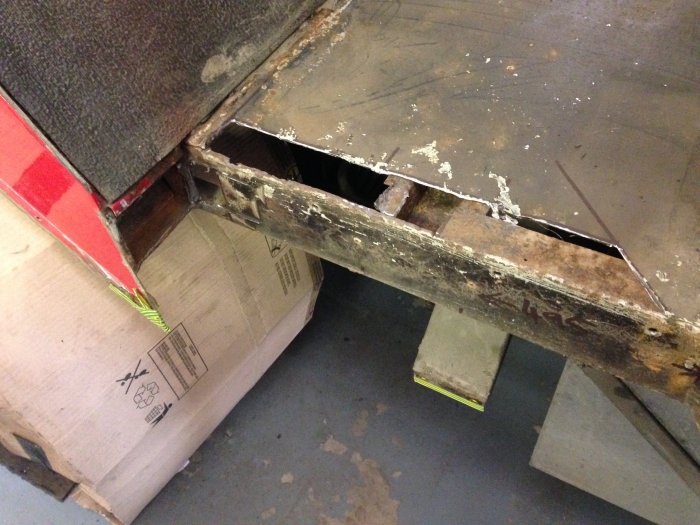

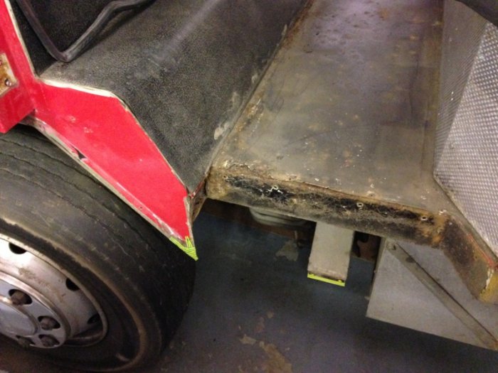

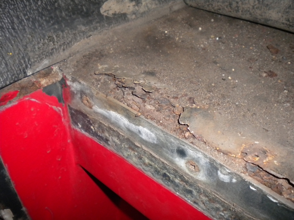

Thought I'd post up some images of my current project, refurbishing the undercab and floor of a 1993 Dennis fire truck. Initial assessments of damage were signs that the fibreglass steps were bulging in places from a buildup of rust behind them.

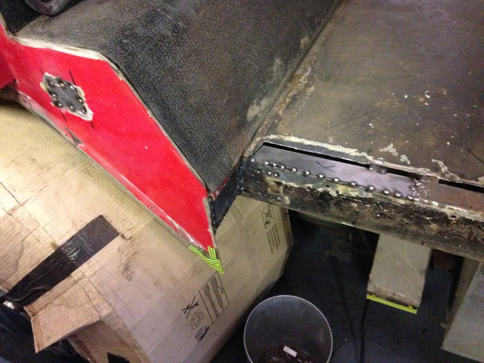

The first fight was getting the self-tappers out that were holding down the ally trim over the rear cab carpet and onto the fibreglass step that I wanted to take off. Most were welded in so the eventual solution was pulling the carpet out from underneath them and then levering the trims off.

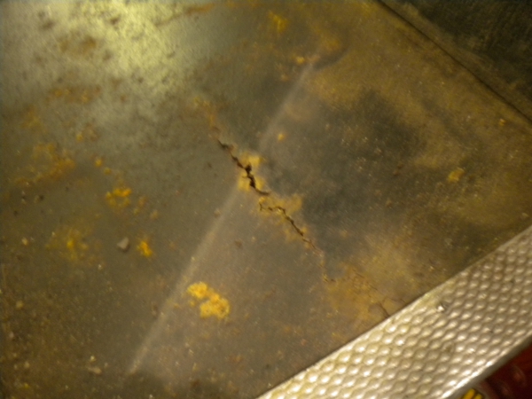

The second photograph shows the damage at the ends of the cab floor once the trims have been removed. The third photo shows a crack in the floor revealed after lifting the carpet.

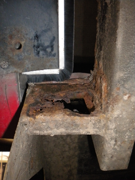

And the last photo shows the remains of the part that was bulging the fibreglass out after tapping the buildup out.
