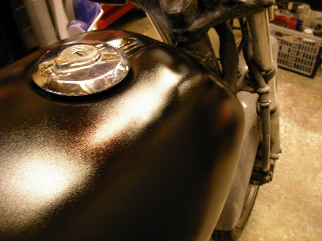

As you can see I pulled a big dent in the fuel tank, learned to do body soldering and am now painting it up. All was going well but I ended up with orange peel in the fuel proof lacquer coat. I should mention that the paint also had some orange peel which I removed most of with wet and dry but not competely (thinking the lacquer would fill it).
I did some reading on this and found the usual tactic is to use fine wet and dry, wet with soapy water then a rubbing compound. I bought 2000 grit paper and set about the tank this afternoon (after leaving 2 weeks since I applied the lacquer). The worst of the orange peel disappears quickly but then I am left with lots of tiny little dimples which appear as shiny bits from an angle or black bits from above (it is black paint). More sanding and for some of the marks I am getting into the paint. I need fuel proofing so was thinking of just putting another coat on top. BUT in some areas I have tiny white spots, it seems as if I have revealed little bubble in the laquer/paint and these have ended up filling with sanded lacquer juice. Even more sanding later and in some areas I am at the primer.
I'm really not sure what to do, I can't lacquer over the white dots but I'm not sure how to touch up areas where I go through the paint.
Help!
