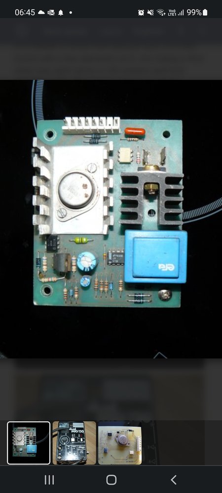

Some time ago my CEM seemed to have bad function of the triggar i.e. the fan is running but there is no feed of wire (but ok gas flow) when the trigger is pressed. Investigation shows that the tiny transformer and rectifyer on the controller pcb gives 17VDC, the wiring from the trigger is ok (the two inputs to the pcb from the trigger is shortened when the trigger is pressed) but there is no voltage to the wire feed motor and no voltage (+current) for the arcing...Does anyone have a circuit diagram or a tip regarding which component(s) that might cause this malfuncion? As both power to motor and arc is missing, some common part for both these functions is failing I guess..
