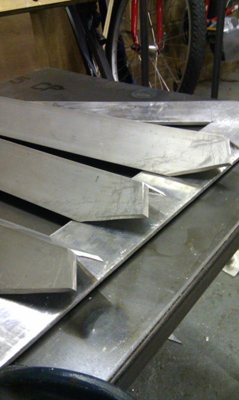

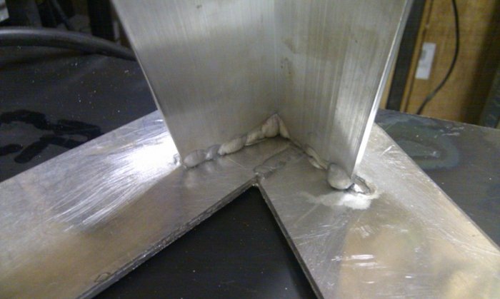

I spent quite some time prepping up aluminium angle to weld to the base I'd made previously (fit up was a nightmare, I'll be very careful with triangular pieces in the future - difficult to represent on 2D CAD!)

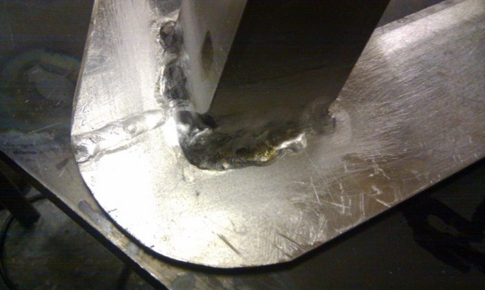

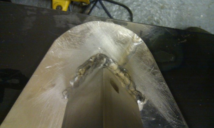

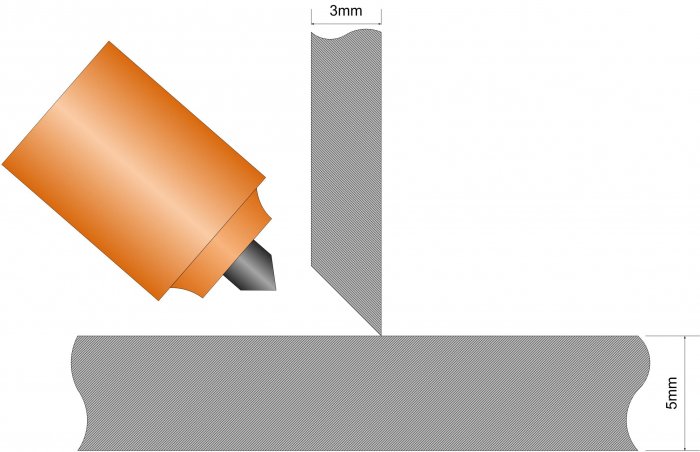

Anyway, I then moved on to start welding one of the legs ot the base, but had a lot of issues. The base is 5mm strip (and I'd got away fairly lightly trying to weld it with a lot less current than recommended), and to it I'm welding 3mm thick 50X50mm angle. For some reason I decided to put a chamfer on the 3mm section where it met the 5, thinking I'd fill it with filler wire.

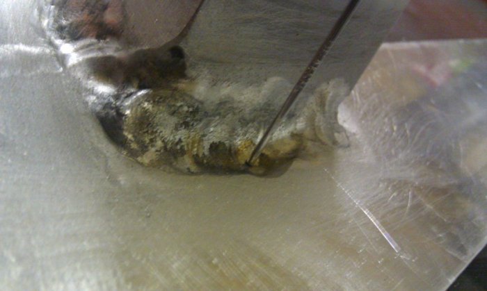

Looks like I underestimated the 5mm's ability to wick away the heat. It was both hard to get a decent pool going, and by the time I did it'd caused issues with the 3mm (I was trying to direct the heat onto the 5mm...)
So - any thoughts on better ways to make this weld work?
