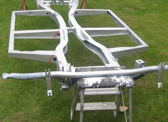

The offside front and centre outriggers on my Herald chassis have not be correctly fitted. The outboard edge of the front outrigger needs to be raised by about 25mm.
So my plan is to cut the outriggers as shown by the red lines, leave the top face uncut and then lift the outboard ends to the correct height and then weld-up the cuts.
I am assuming that each of the cuts will only open by 5 to 10mm max so what would be the best way to weld them back up? Should I cut out a bigger area so that I can then weld a large patch back into place. Or do I just use a sliver of new metal to fill the 10mm max gap?
Thanks
Chris
