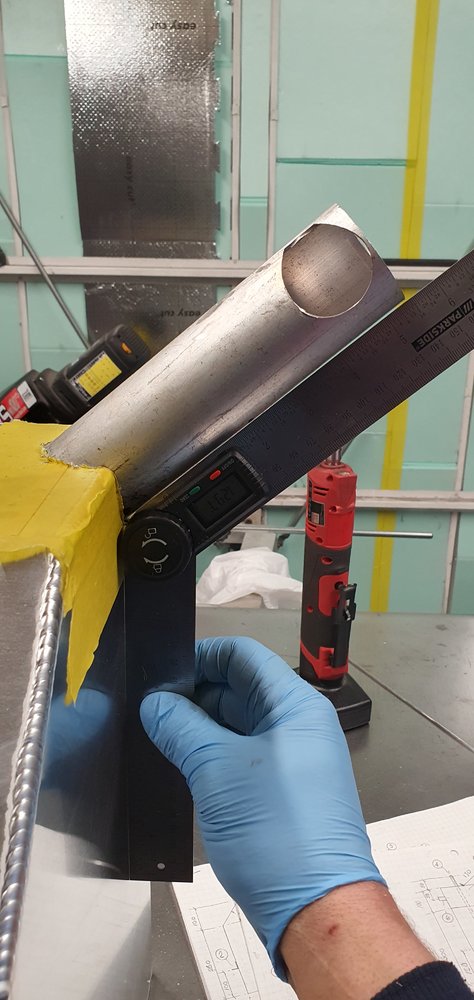

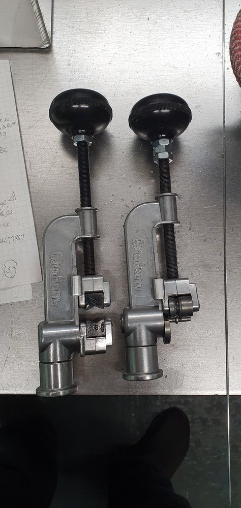

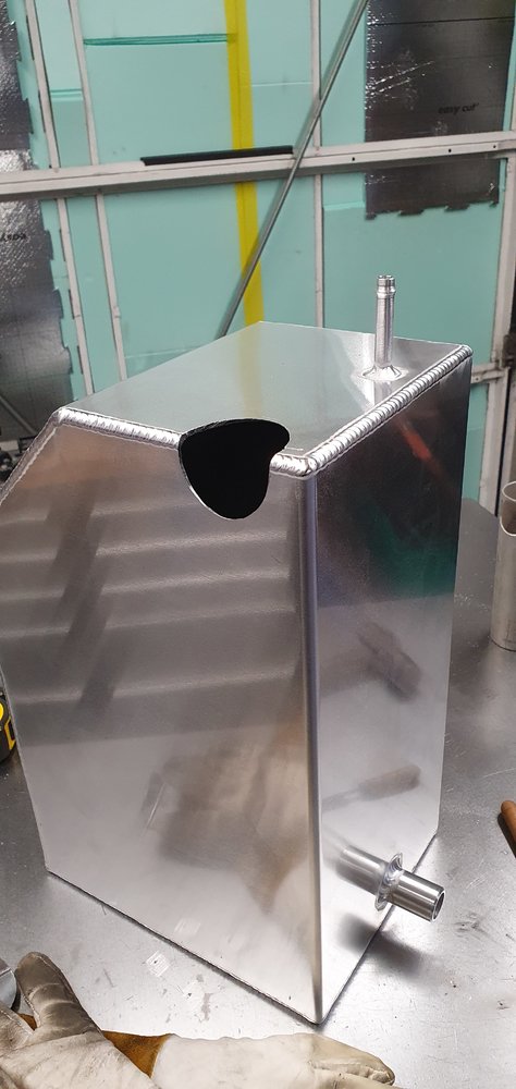

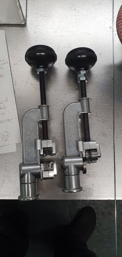

I have a tool for that I'll post up later does from 3/8 up to around 3/4 only good for 1.5mm wallHow are you putting the beed on the vent pipe off the top

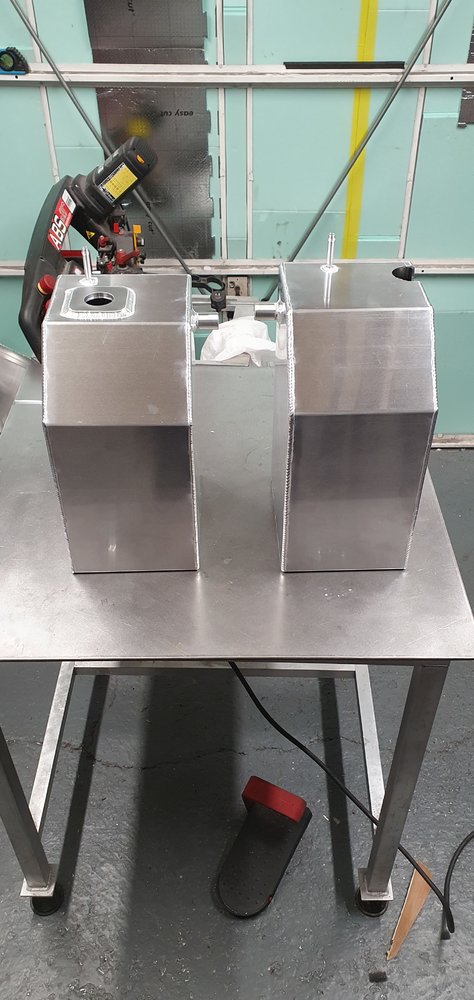

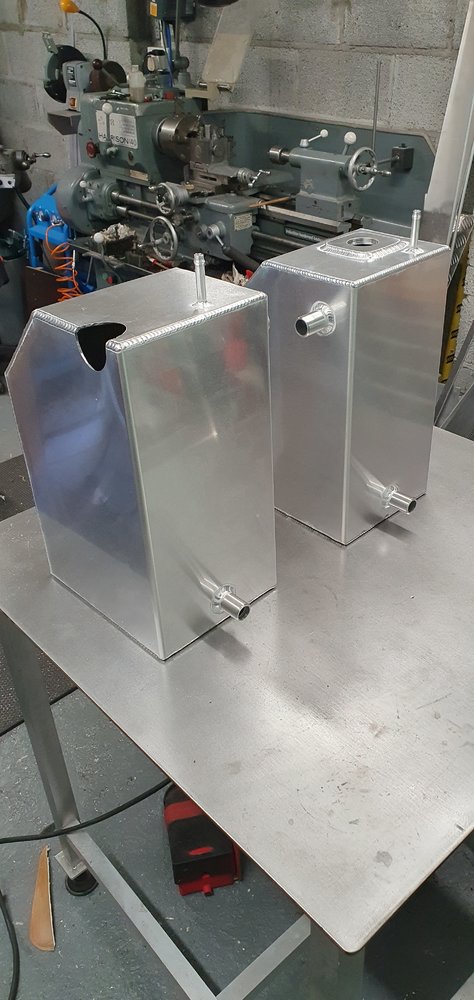

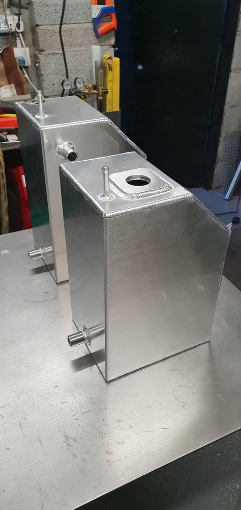

No baffles I always ask, baffles, race foam or nothing, these where done as cheap as could be hence the 25mm pipe without bead, he didn't want to pay for a full lengthare they baffled or small enough not to need internals ,,,

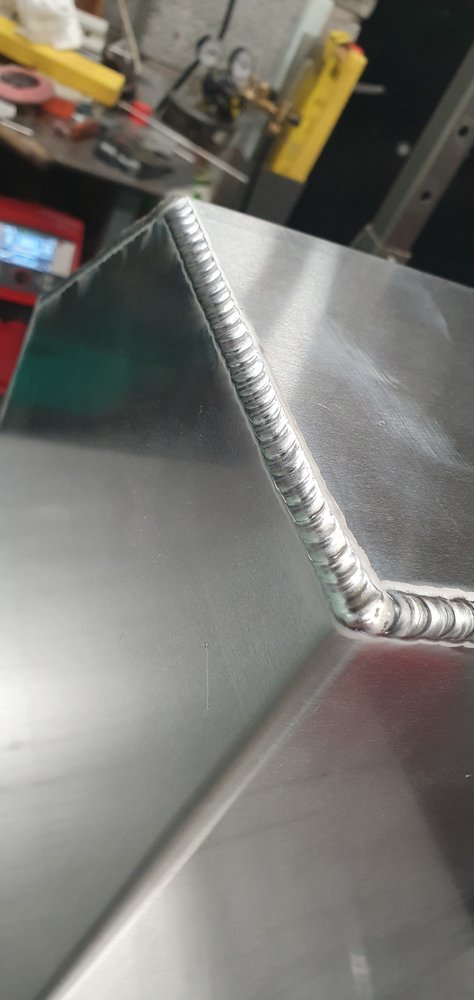

looks smart though , if you dont have a bead three spots on the end of a pipe will do the same job, although its hardly needed on this occasion.
