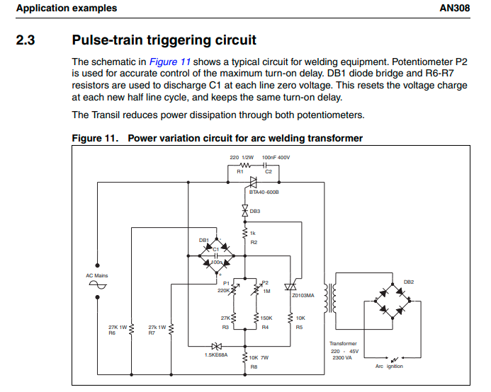

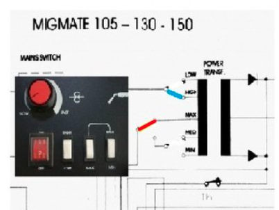

Switches are shot on my inherited ancient SIP MIG so was considering replacing switches with a primary side triac controller.
Trawled around for a schematic suitable for inductive transformer load found this nice one from ST for exact purpose of a welder.
Thought it might be of interest to others.
Note: The badly named and symbolised DB3 is actually a Diac.
