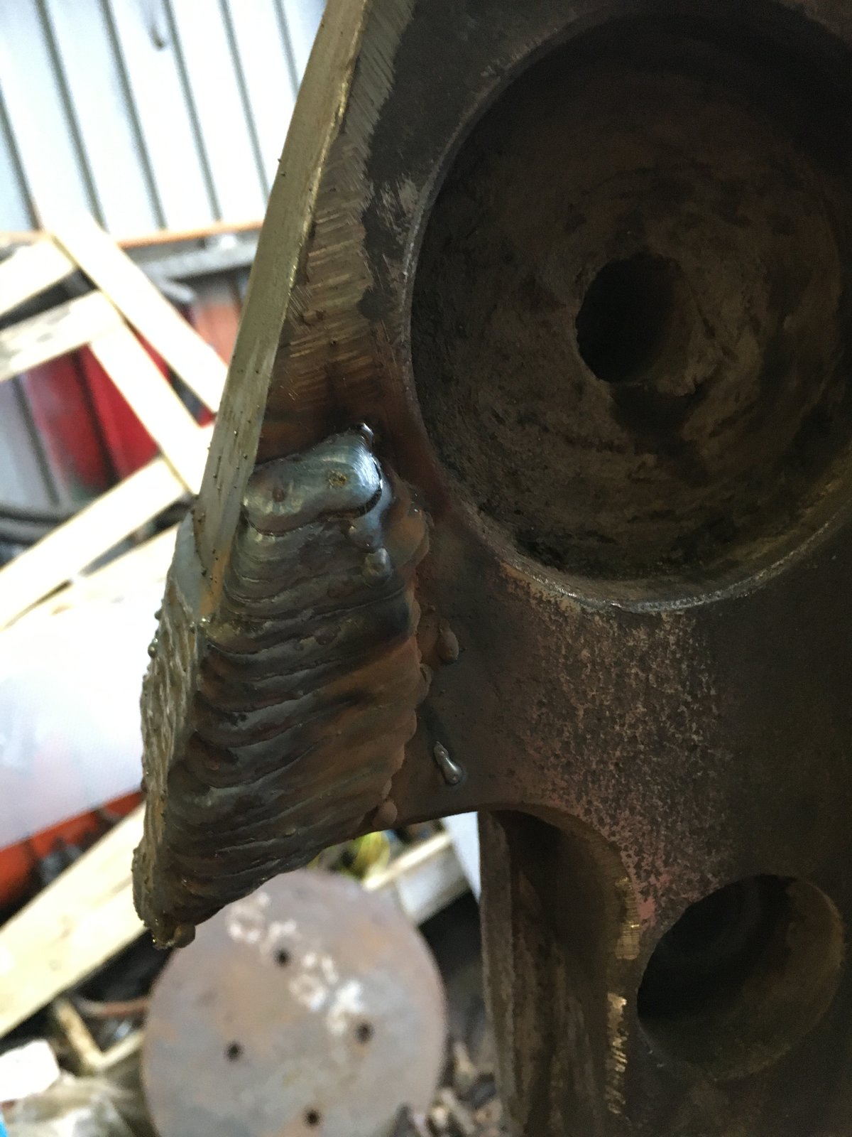

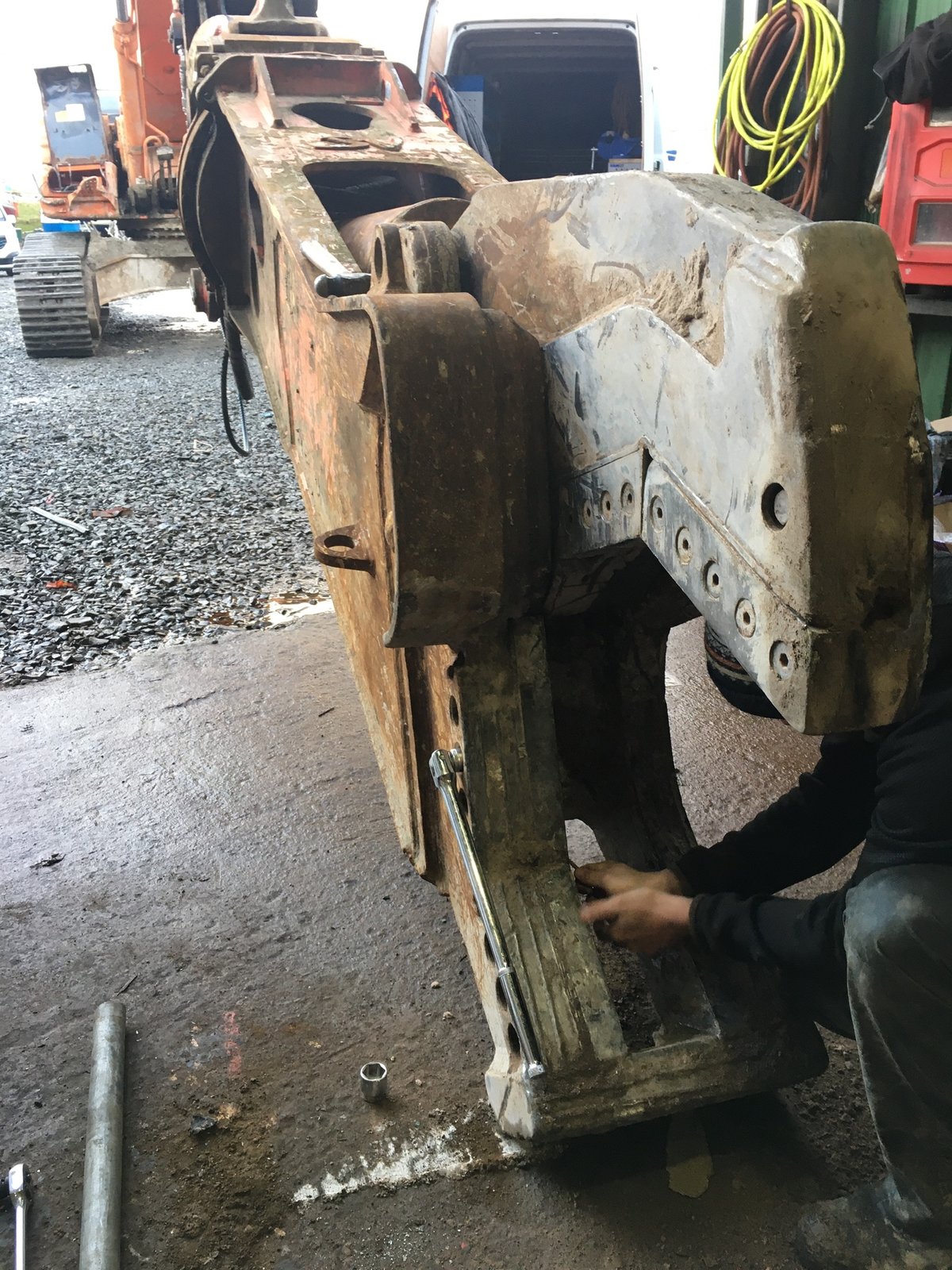

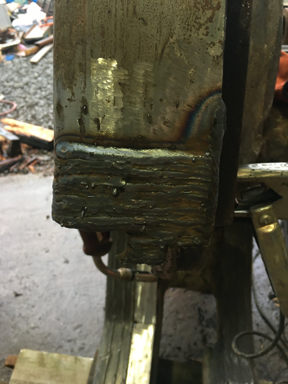

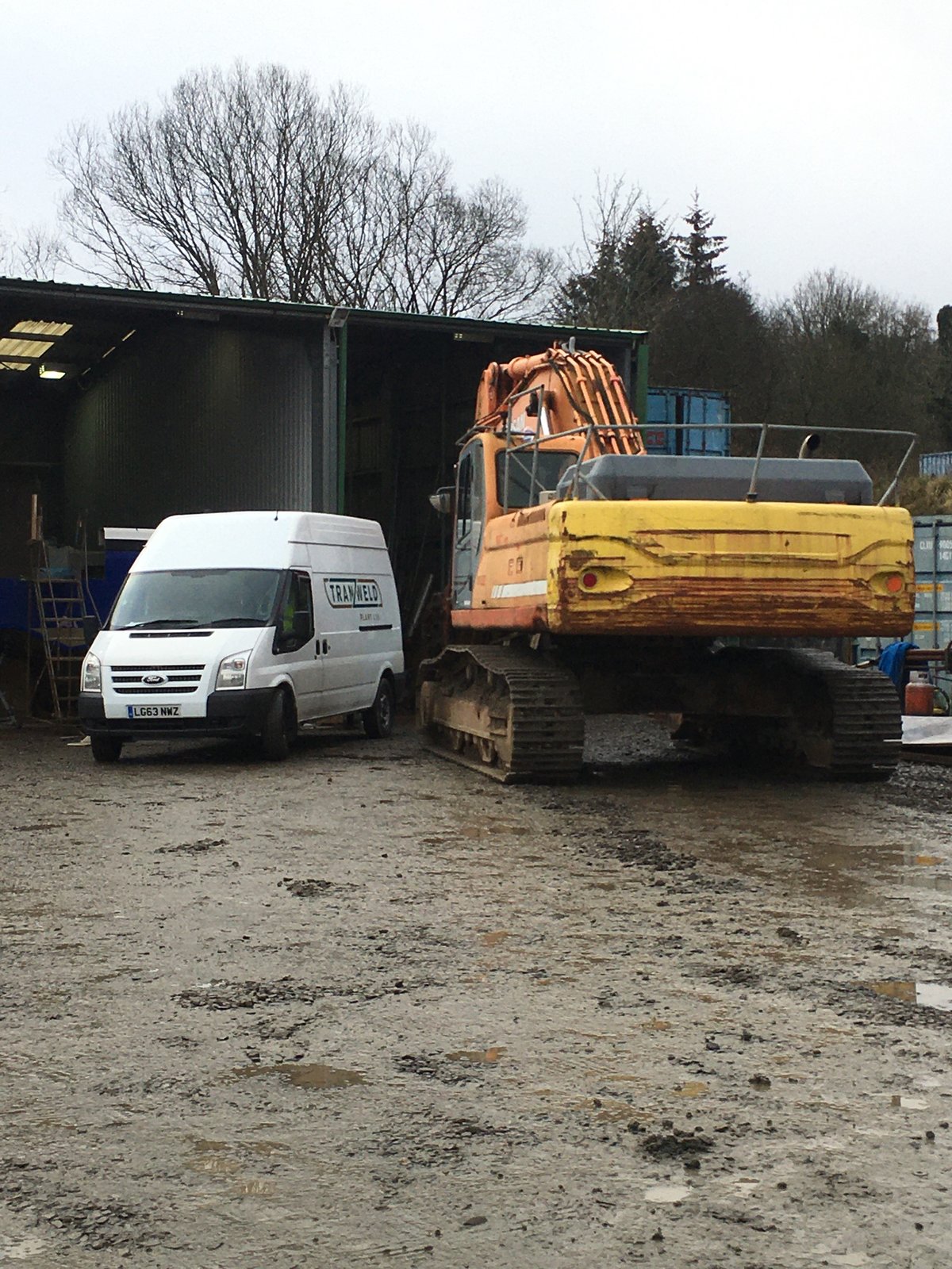

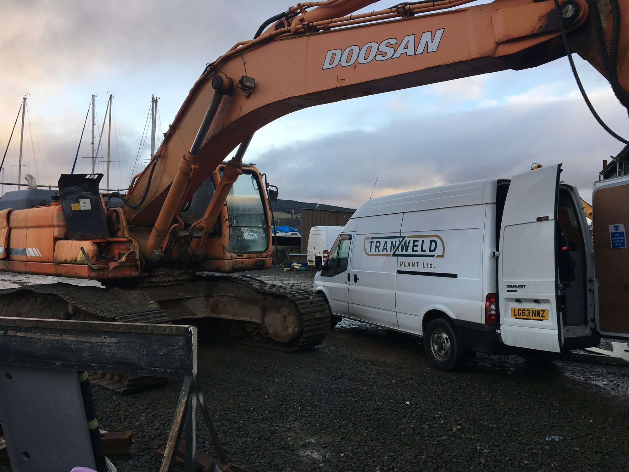

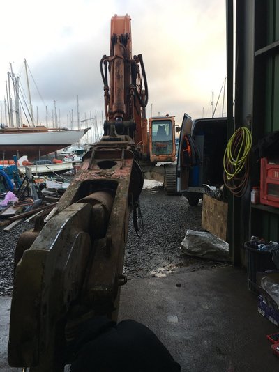

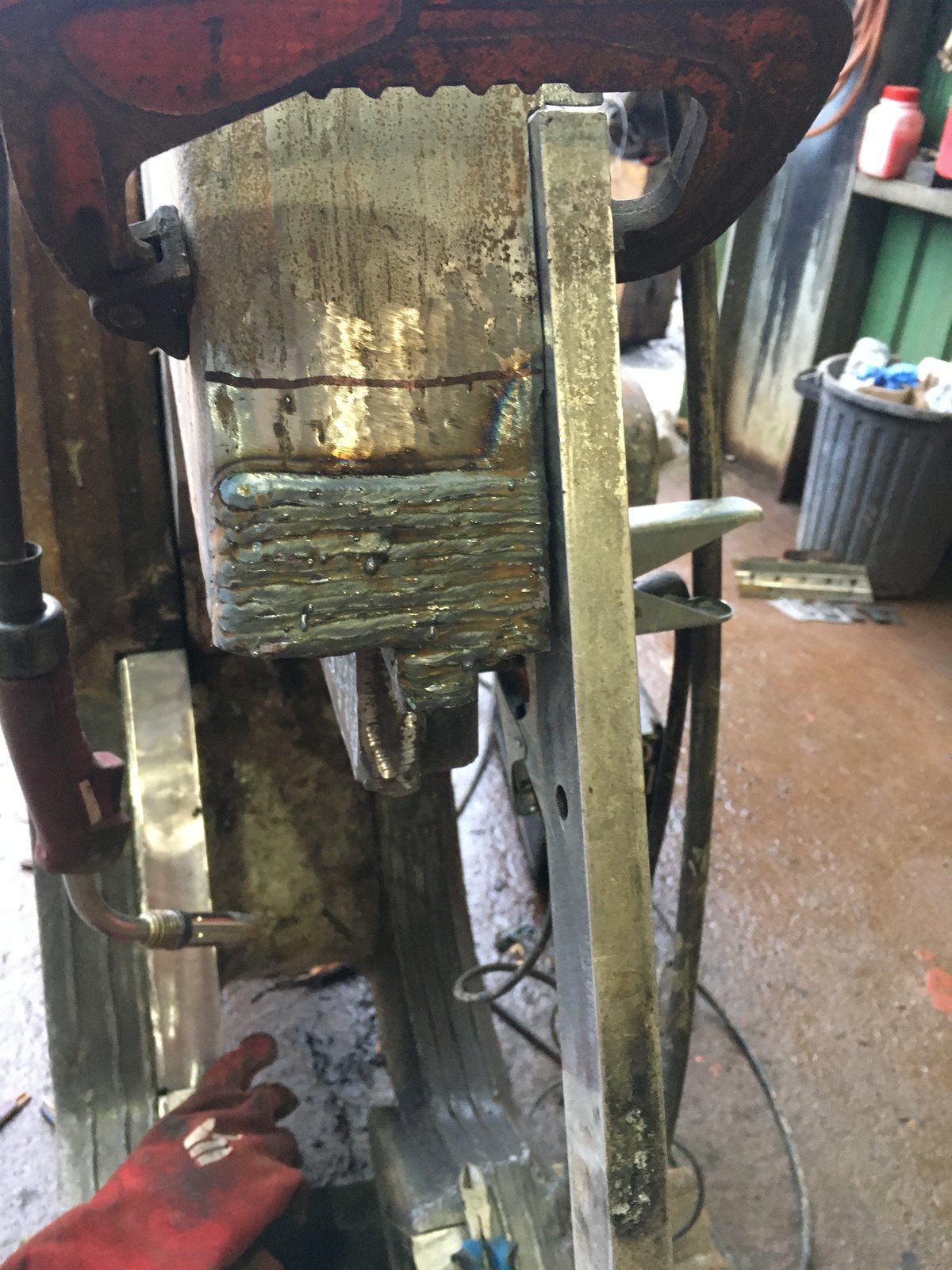

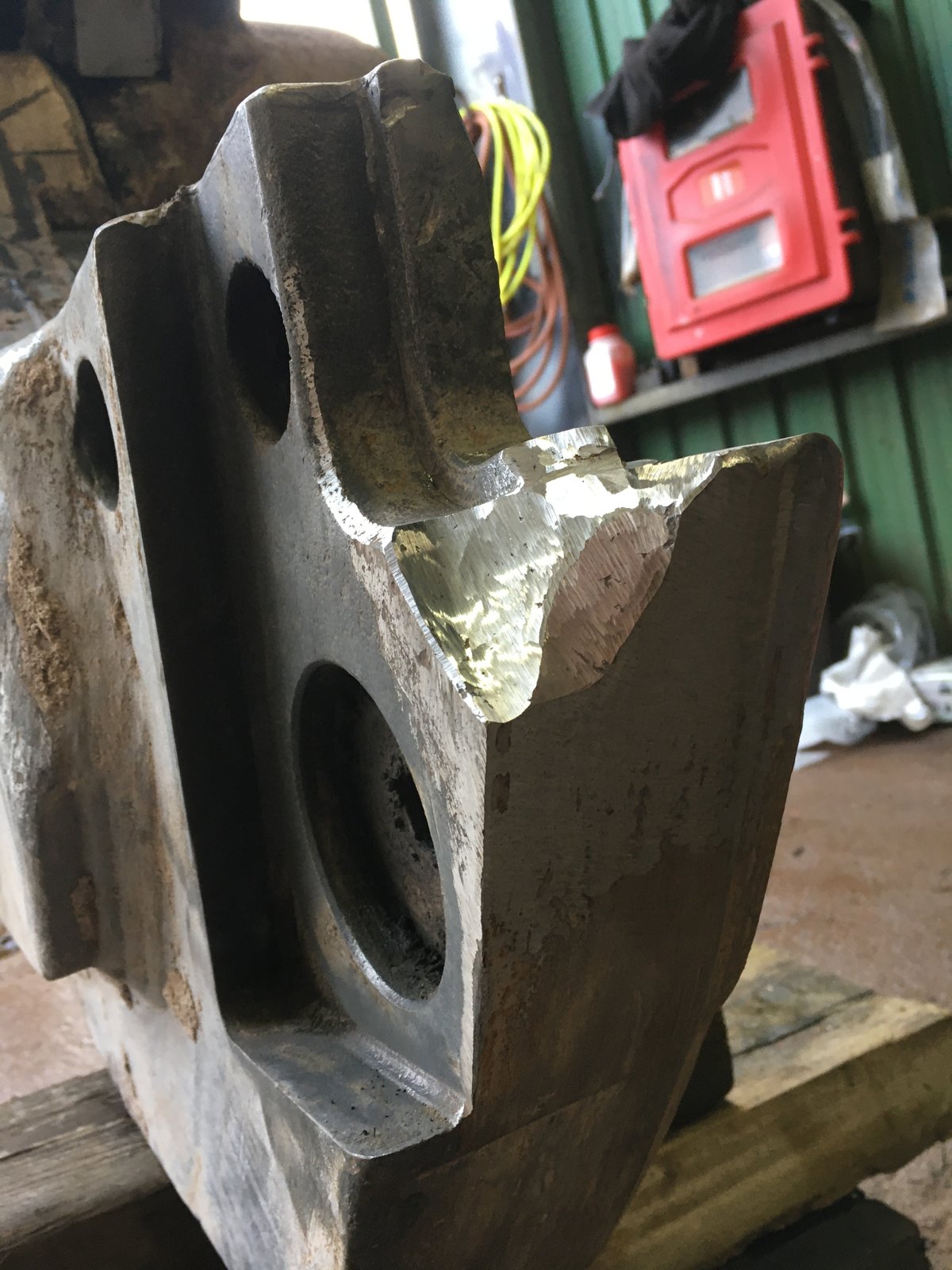

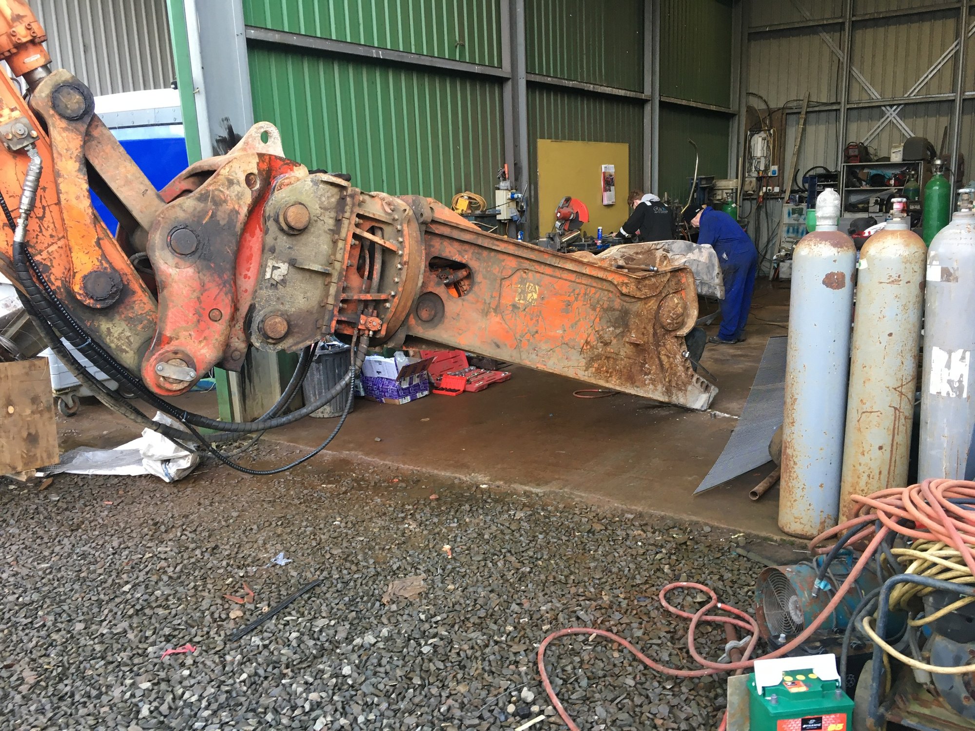

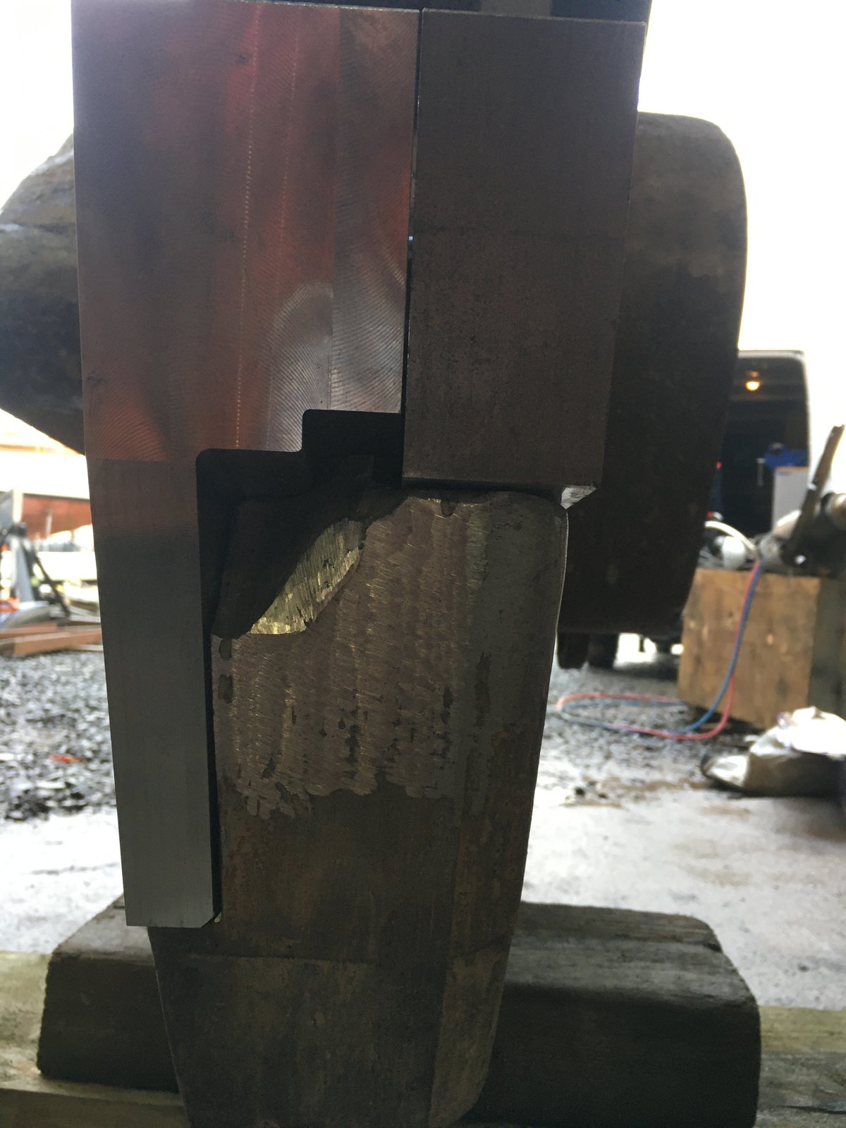

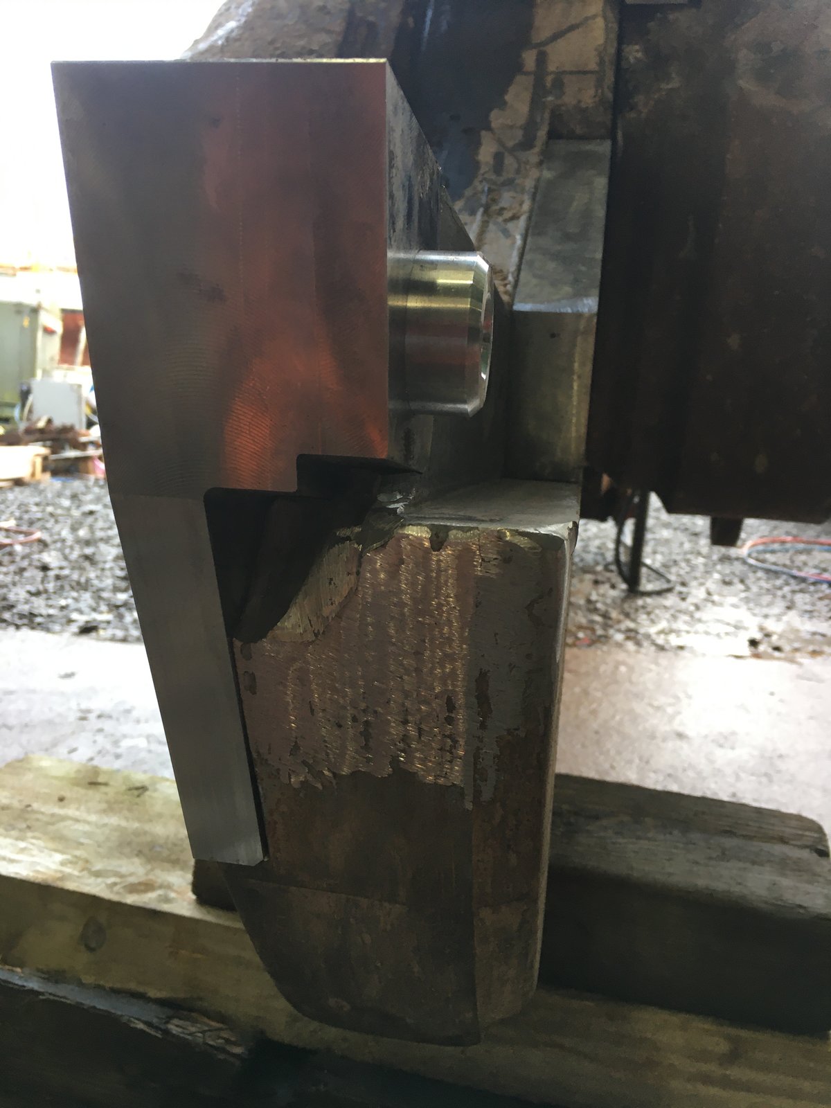

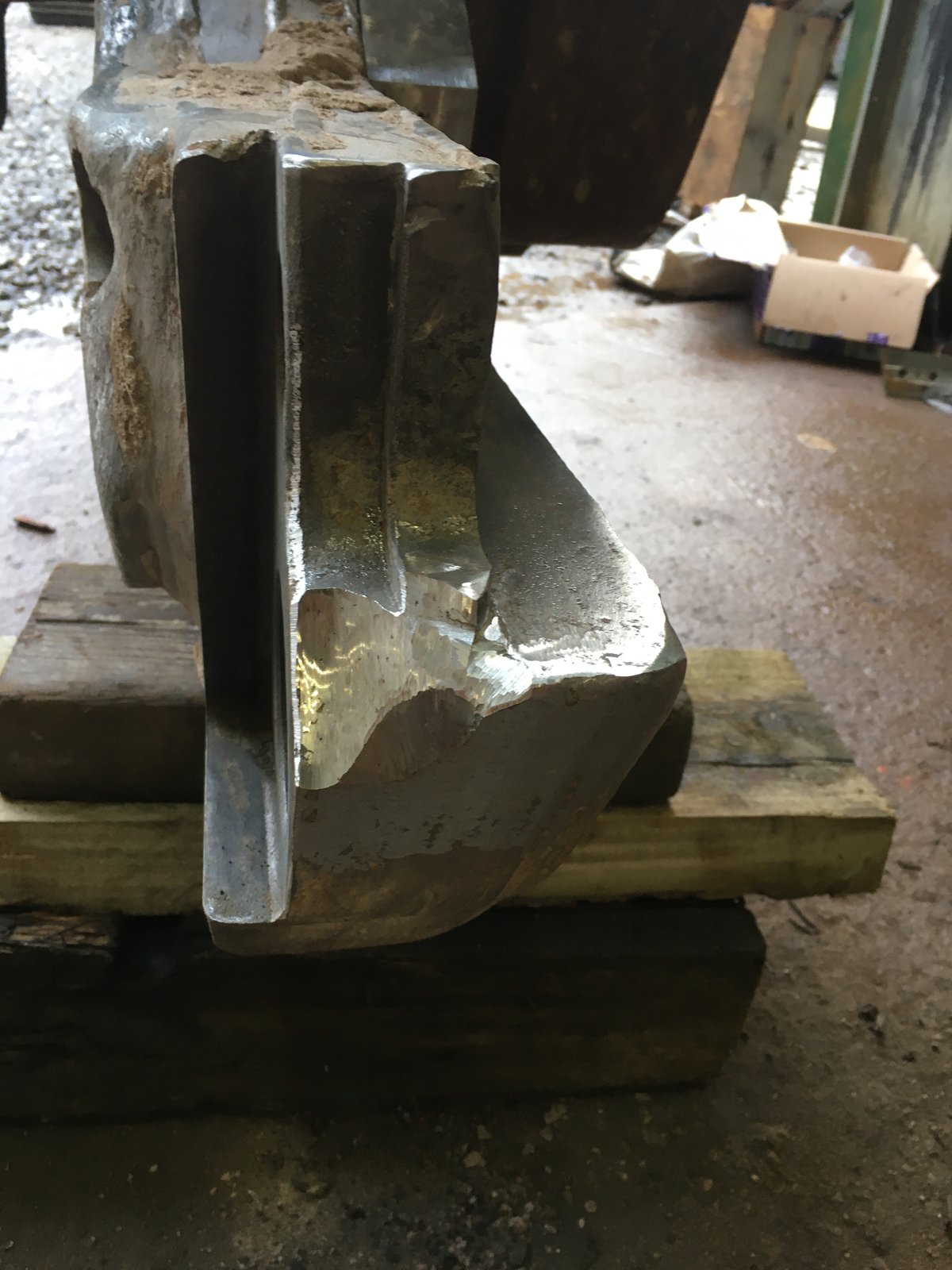

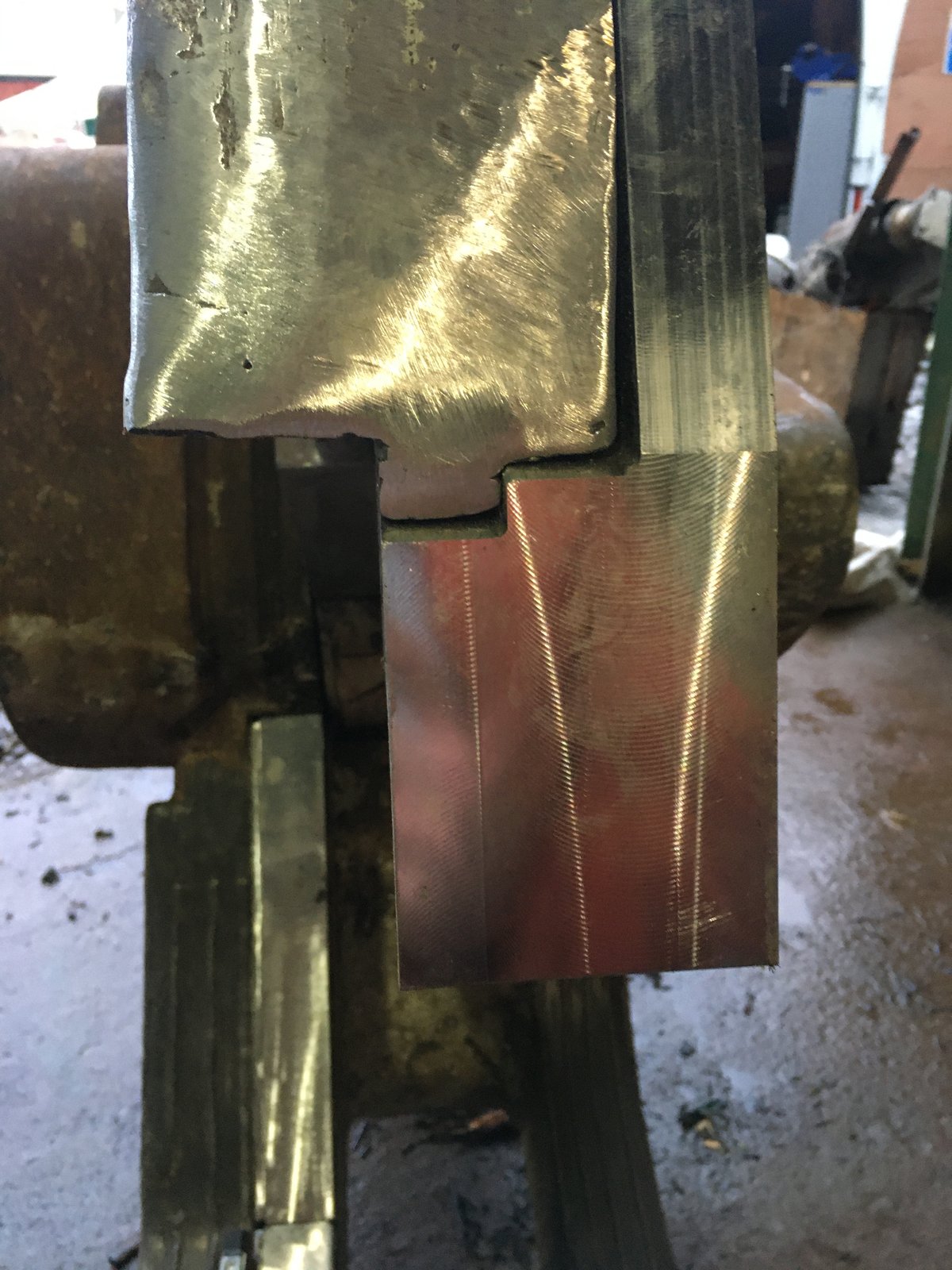

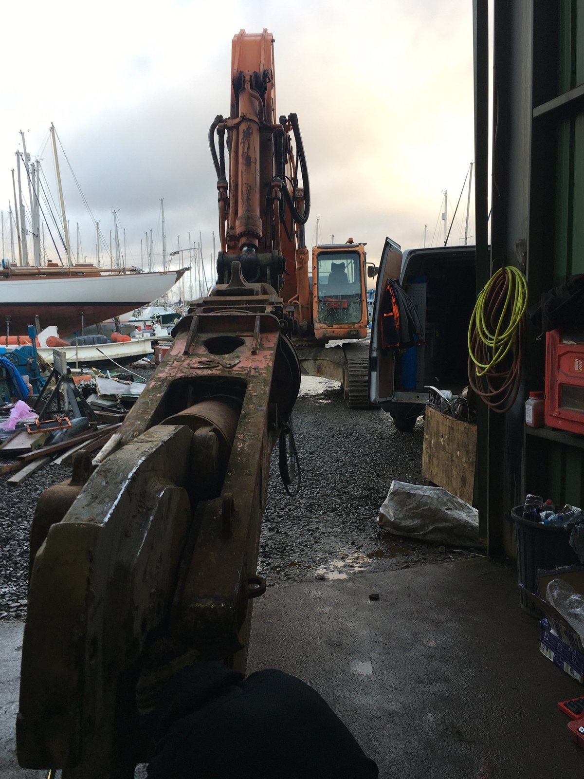

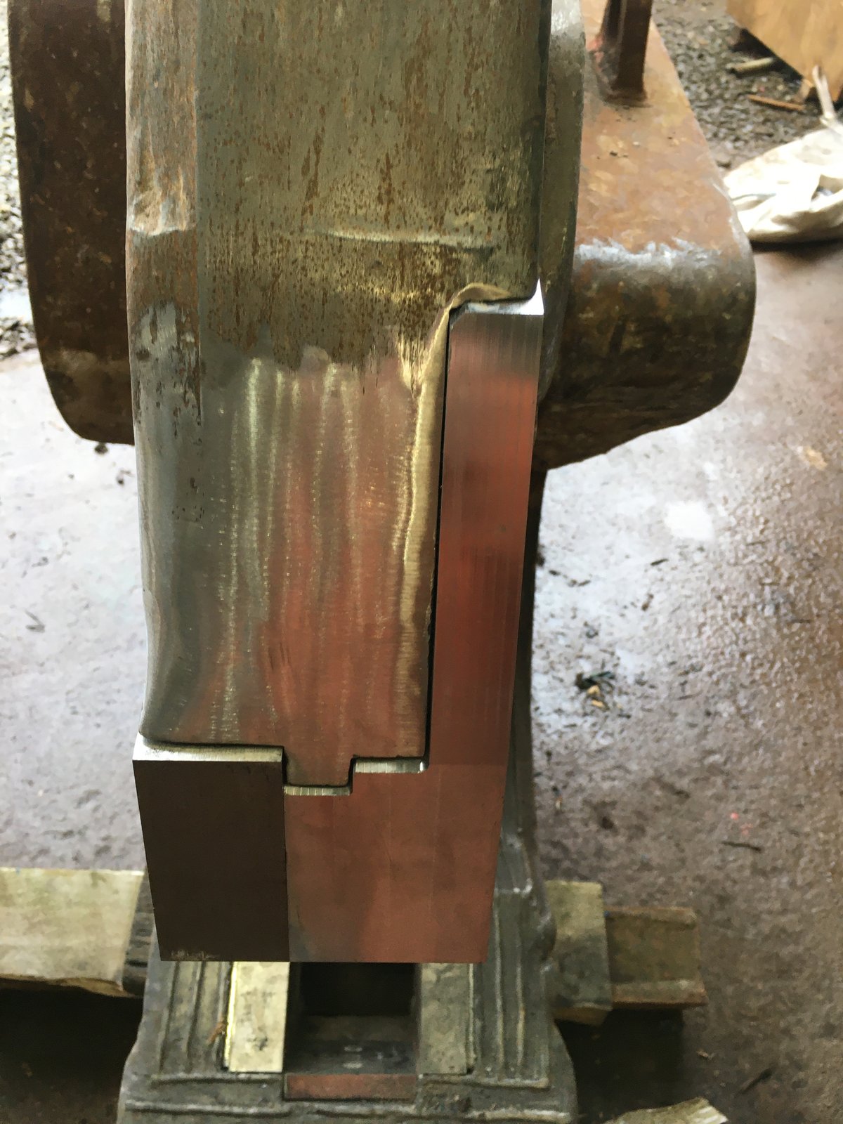

I had a repair up in Argyle (Rosneath) Thursday & Friday to repair a set of Trevi Benne shears for a boat yard who scrap old worn out ships. The place had just been bought out and the new owner is getting his gear back into a decent working condition. This shear had been used with a damaged from blade and as such had chipped a big piece from the top beak.
My job was to turn all the blades, build up the top beak and dress to suit the new blade. I set off at 2am Thursday and worked through to 6pm, then was back at it at 7am til 1pm before getting back to Manchester at 5:30pm last night
