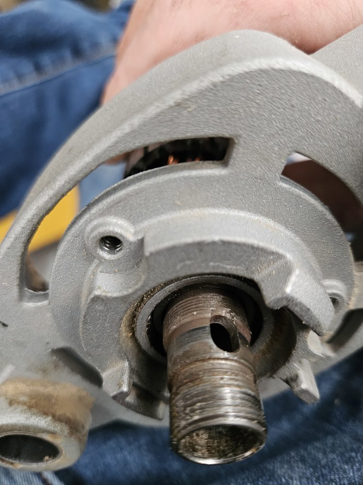

Just used my router, and notice some float in the spindle causing an inconsistent cut.
Had it a while, but not done masses with it.
Pulled it apart and it looks to be a part missing. No way it could have come off as its within a housing.

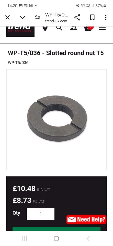

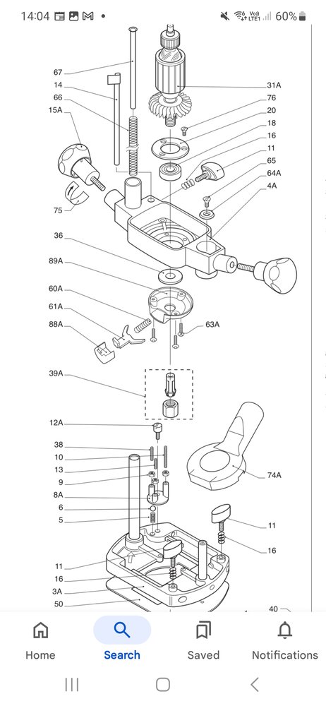

No36, a nut which i gather would screw against the bearing, but images of said spare look like it wouldn't fit.
Any of you woodworkers got a t5 you could snap a pic of? (If it's a v2 it's behind the spindle lock cover.)
