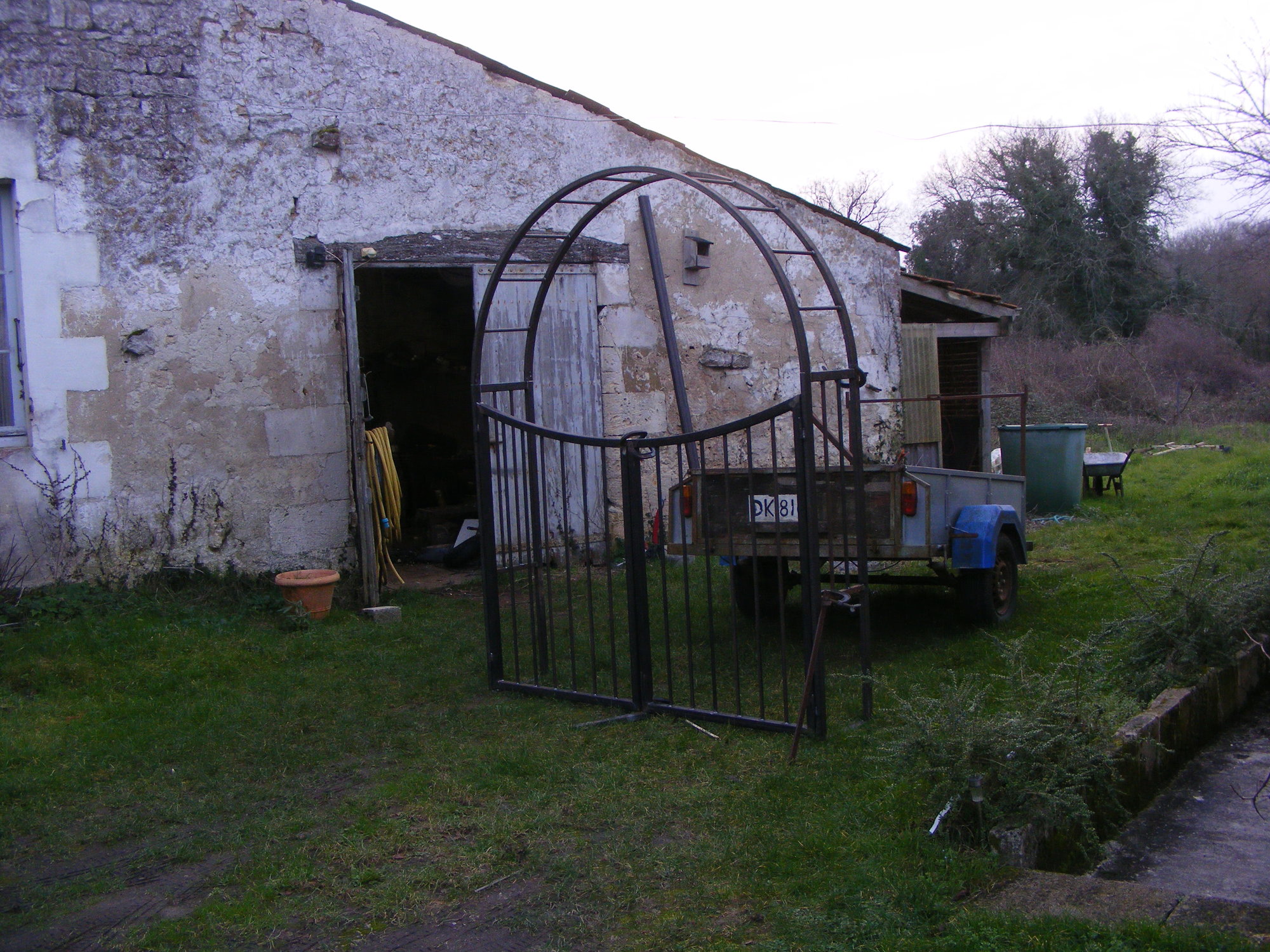

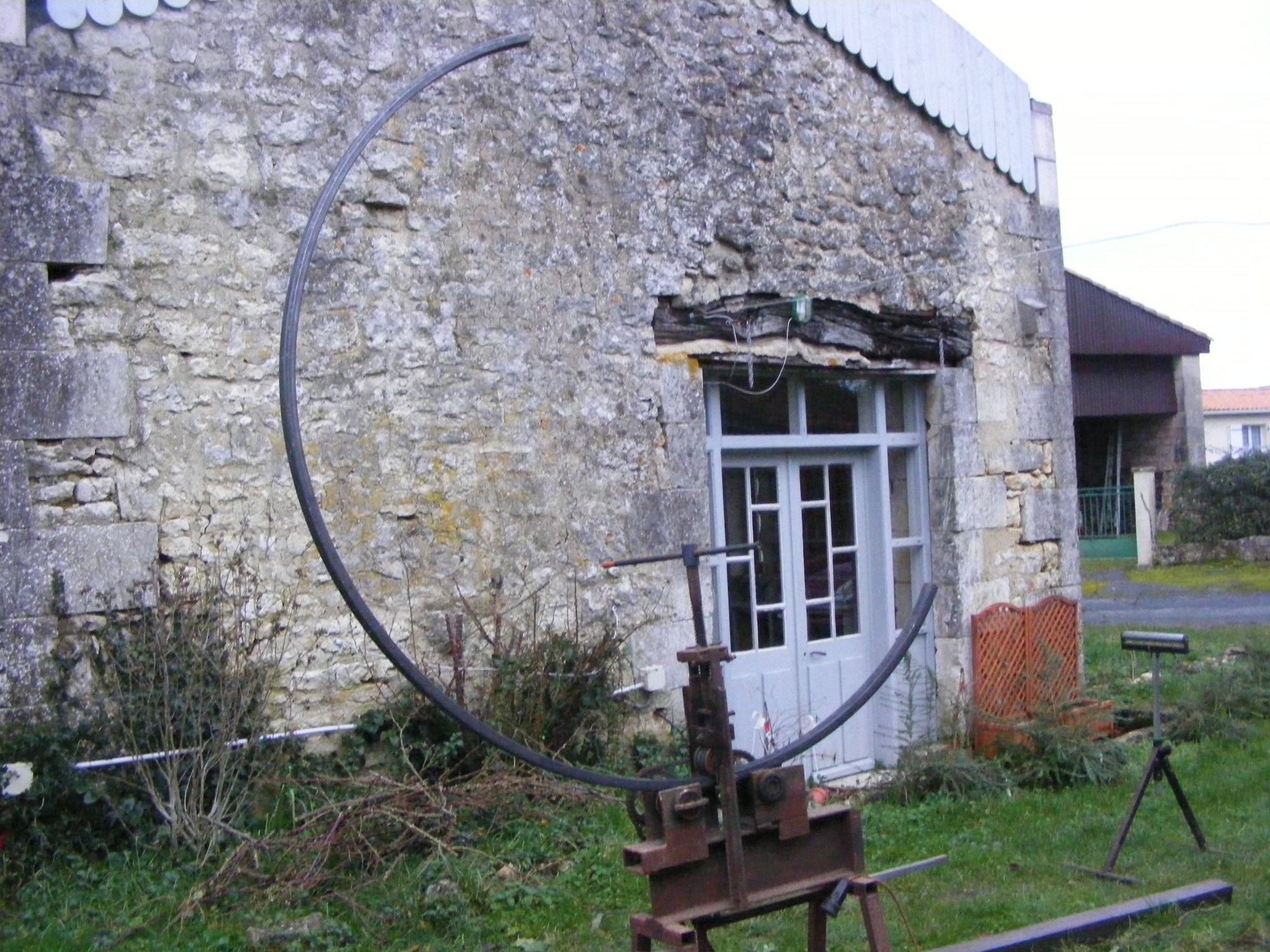

Rools say you have to protect pools with unclimable gates up to 1,100mm. Client wanted something to grow a plant up, so I suggested something similar to the photo, but with a flatter curve over the top. 'Japanese' style.
Client decided to go for the semicircular top.
Frame tubes are 40x27mm and the cross pieces 17mm round tube, as are the verticals. All the joints are drilled through to the frame tubes for the galvanizing, so no holes visible. Top section bolts to the side frames with sleeve joints.
Off to the galv place tomorrow....
