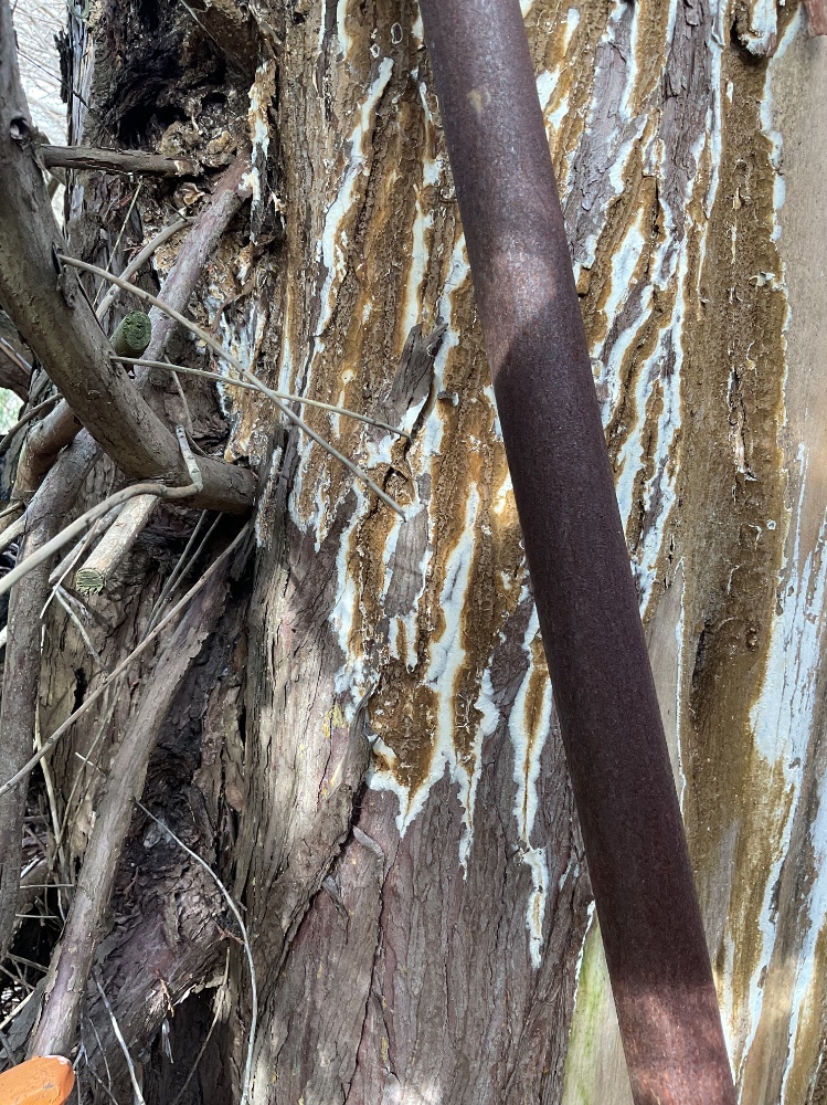

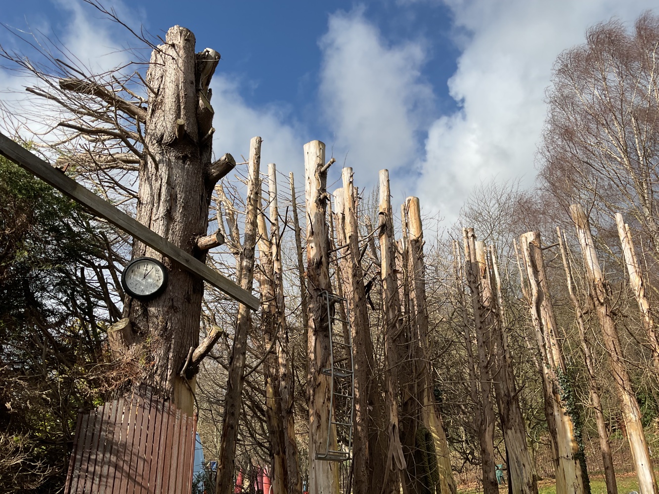

I’ve a leylandii row of trees to fell,want to replace them with a 2m high fence using 100 box posts that screw onto the stumps! I want to make short pedestals to keep the wooden parts up in fresh air,then also to be able to plumb the posts,stumps are mostly about 300mm diameter,I would like to fix to the remaining ones I chose which will be at 2-3m apart along the 15m row,these trees were topped 3 years ago and despite starting to self peel their bark , are secure. Is the fence likely to remain stable for the next 30 years say,or will the stumps rapidly rot ,destabilising the fence?
