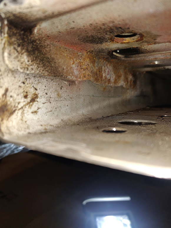

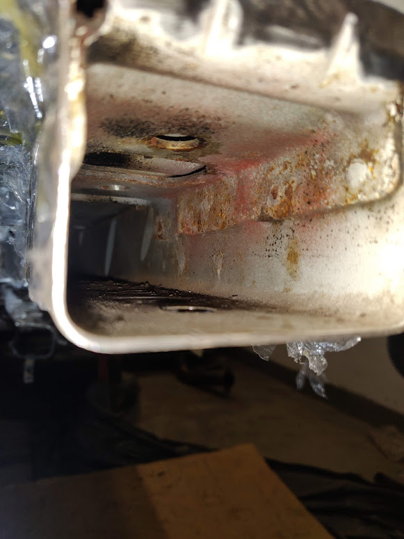

Hi again lads,
Need some opinion on this one: rust in the sills, other not reachable spots. It's not rusted through, no holes. So no cutting and welding at this point. Blasting is also not an option in my situation. Dremel tool will probably do the job, but how to treat it afterwards.
Plan A is:
1. remove as much rust as possible with dremel grinding bits.
2. deox gel rust remover (multiple times if needed).
3. Epoxy mastic applied by brush? Maybe more corrosion oriented like Jotun barrier 90 instead of jotamastic 87?
Also maybe there's alternative to brushing? Special tool to get primer in tight spots?
Thanks!
