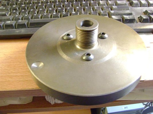

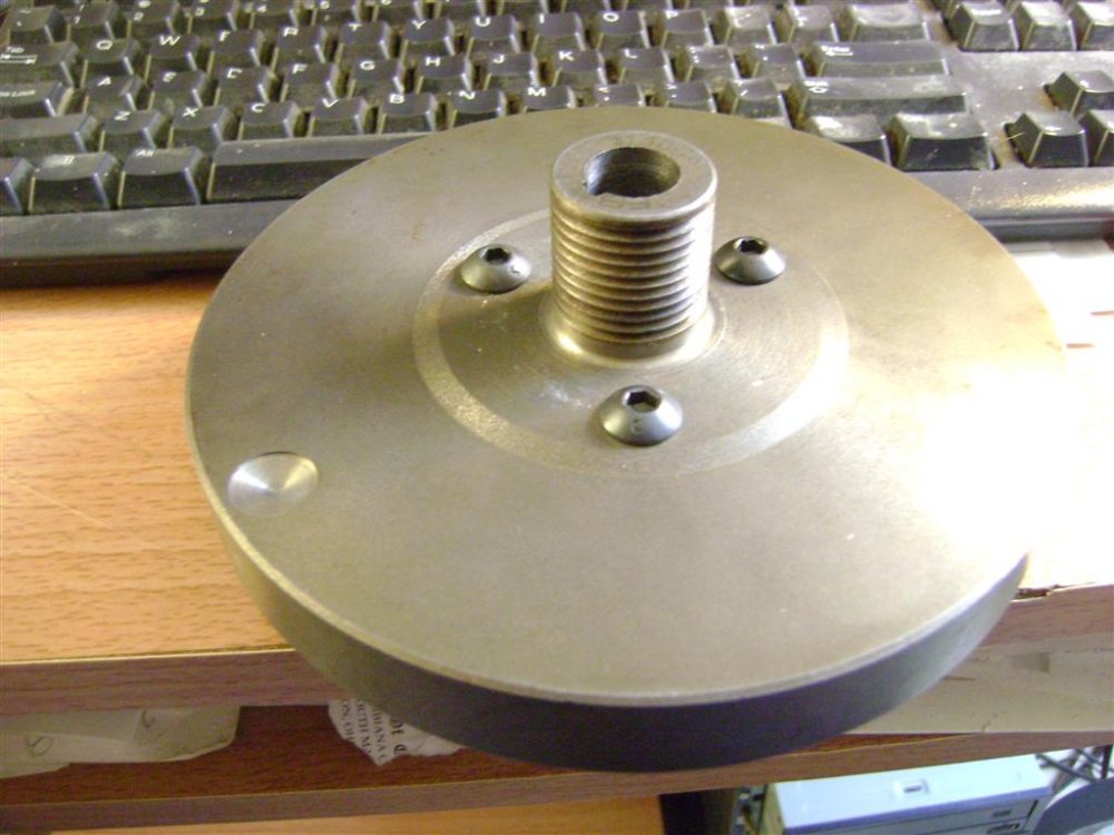

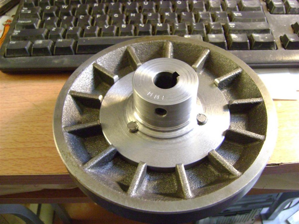

Treadmill motor swap flywheel reworked.
Made an adapter to bolt to the cast iron flywheel to adapt a larger motor where the orig was threaded on. Made up a hub with a flange and cut the ribs from the back of the flywheel to fit...Bob
