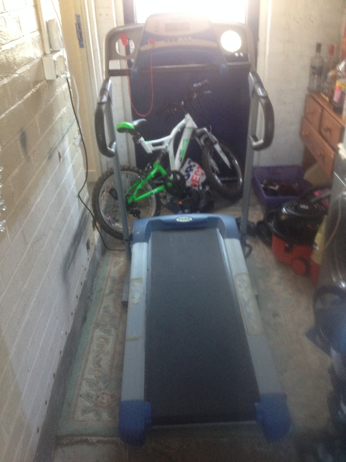

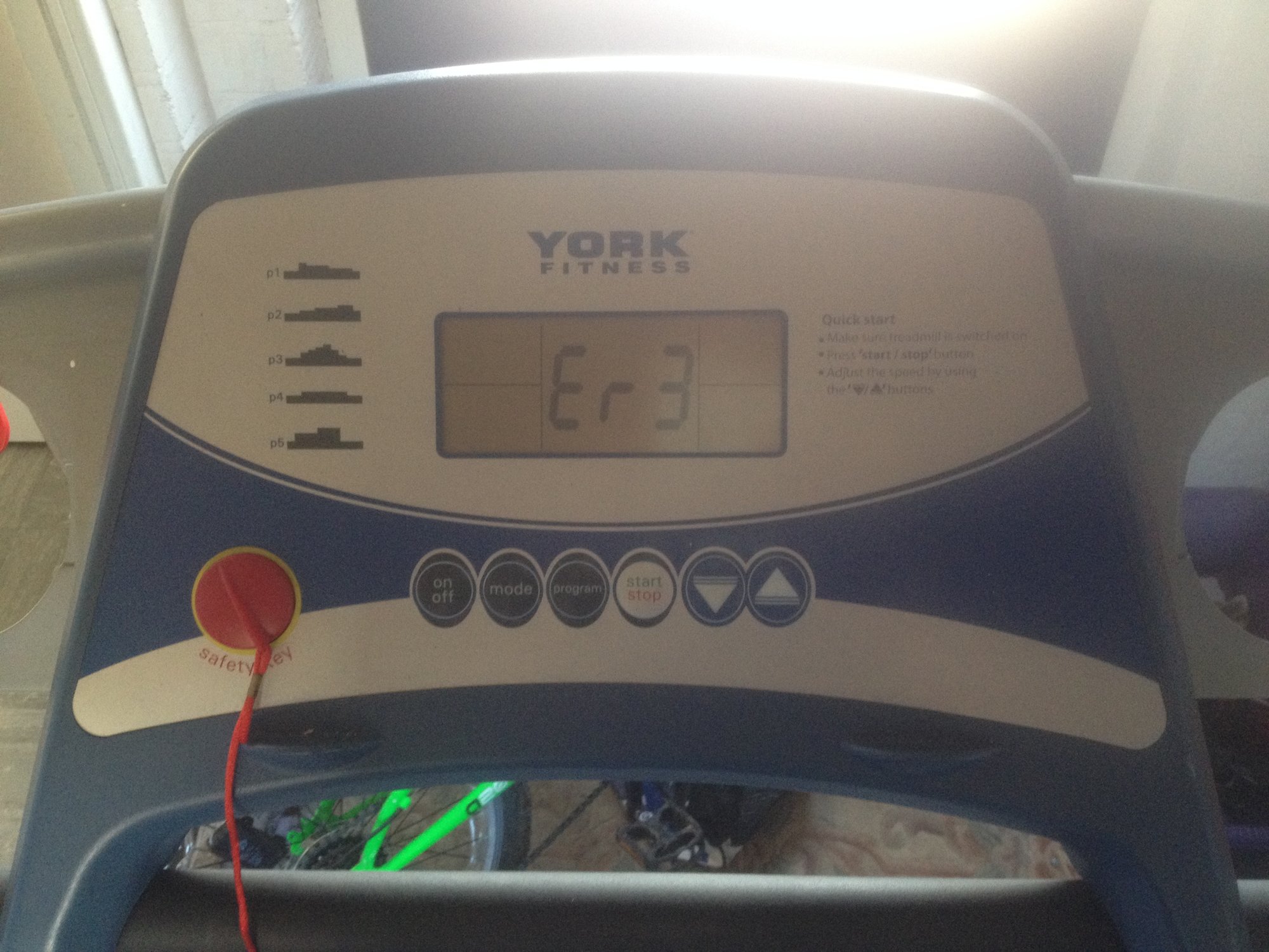

H Hammy Member Messages 57 Location U.K. May 2, 2018 #1 Got a York fitness treadmill but after ten seconds moving error 3 starts displaying any 1 have any ideas help much appreciated image.jpeg 269.9 KB · Views: 111

steviec_lj Rust Welding Professional Messages 2,796 Location Barnetby, N.Lincs May 2, 2018 #3 According to google, it’s something to do with a speed sensor on the front roller. Probably full of fluff or out of alignment.
angellonewolf Member Messages 9,026 Location bristol england May 2, 2018 #4 after a quick google search poss the speed sencer beaten to it try blowing with air compresser might shift it

H Hammy Member Messages 57 Location U.K. May 3, 2018 #6 Thanks gave it a clean adjusted the sensor but still nothing probs scrap

angellonewolf Member Messages 9,026 Location bristol england May 3, 2018 #8 looking on line you need only a small gap look on line if its just out side this will not work

H Hammy Member Messages 57 Location U.K. May 5, 2018 #10 I Bypassed the sensor altogether and also still the same just decided to get rid. I do like the idea of a sander tho
