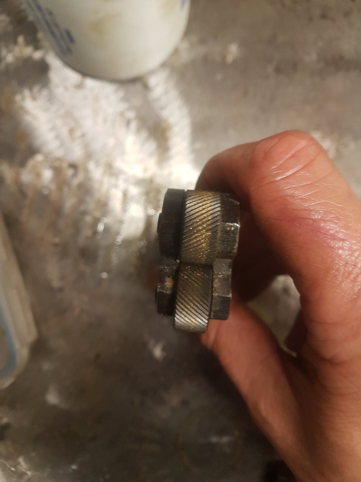

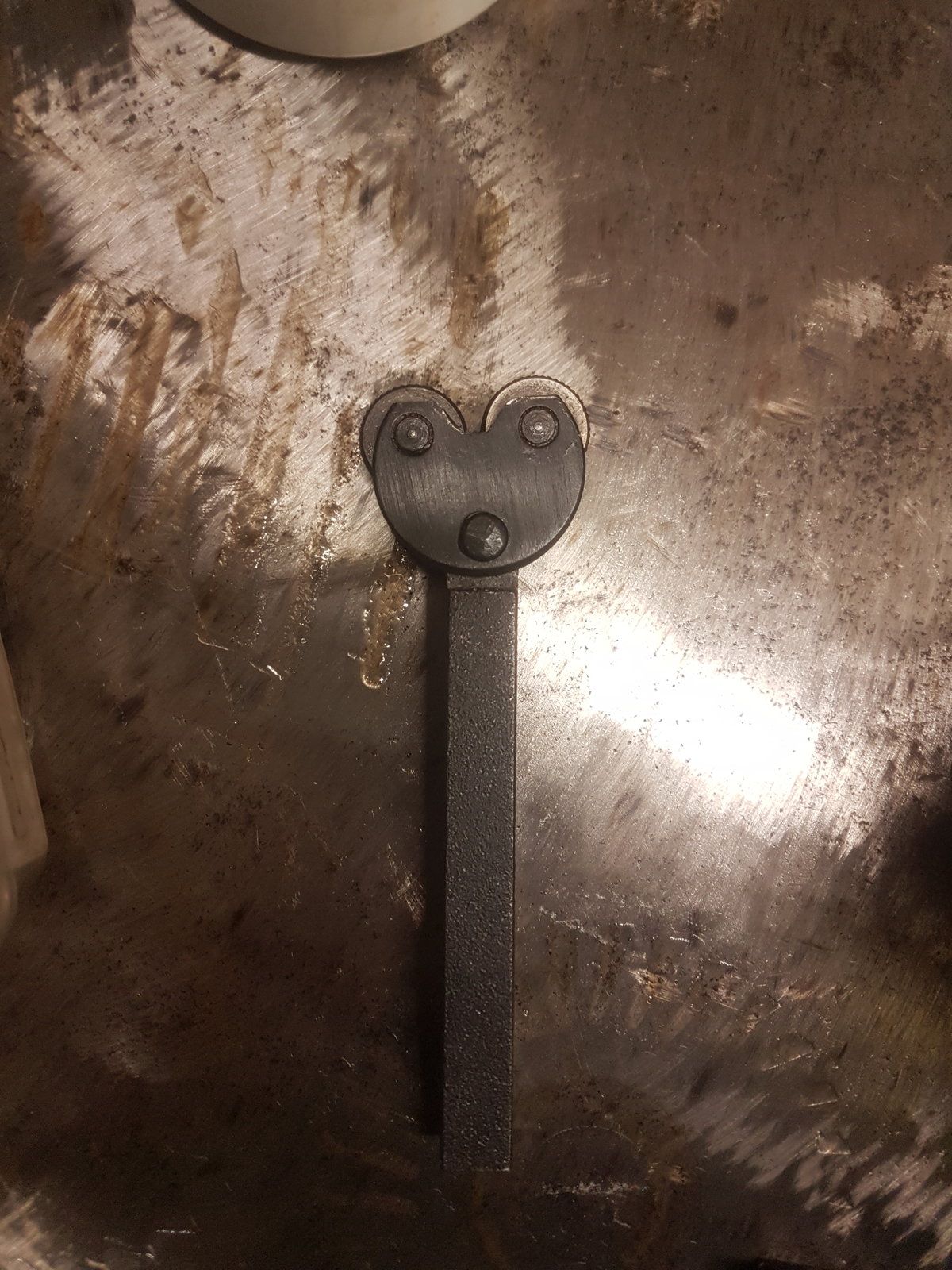

Cut knurls sound good.thanks that looks like a better idea
Not that I have tried them, I bought some but haven't made a holder yet.
not sure how to use it properly yet either
There is no way that it can be used it's a bad design .. it will make a nice doorstop ...I'll take it off your hands for a fiver plus P&P .
thats a big boyYa need one of these. View attachment 201939 View attachment 201940
Ya need one of these. View attachment 201940
Cromwell tools do the wheels. I brought some new old stock wheels off ebay.Got one, but I would like to get a set of straight knurls for it. Do you know of a source ?
Yep, the proverbial Testicoli Canem, what I use and a lot kinder to the lathe than the bump knurlersYa need one of these. View attachment 201939 View attachment 201940
does one just keep tightening the wheels as it is turning until the desired effect is had
I shall have to try it out thanks. slow speed I take itPretty much, yeah, I find a few passes (not disengaging from the work) with a tighten up in between works, use some heavy cutting oil (or flood coolant if you have it, clears the debris that otherwise can get caught and pressed into the work)
