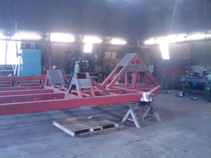

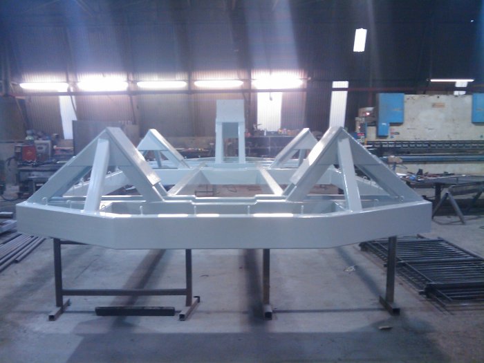

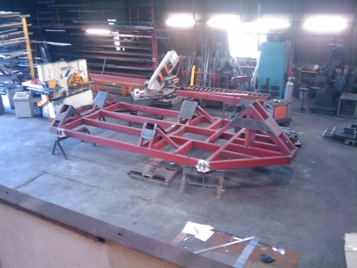

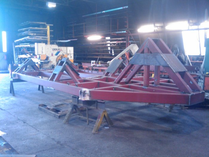

Transport cradle so the delicate fibreglass bit that sits on it doesn't get damaged.
Been working on this on and off for a couple of weeks now. Its just awaiting final inspection and paint
Paint turned up today, so probably next week it will get a bit of paint.

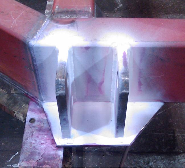

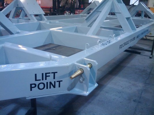

Proof load tested yesterday, i missed that. Weighted down with about 8 tons of steel, then each corner lifted up, one at a time to strain gauge read 6.8tons, to be sure the lifting points didnt come off.
Mostly 200x100x6 box, and 12mm plate, just about all fully welded.
Entering it for the Turner prize, along with Malcolms
