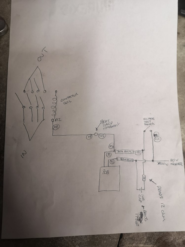

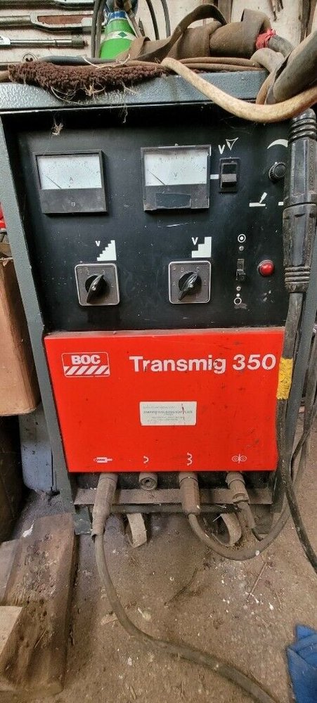

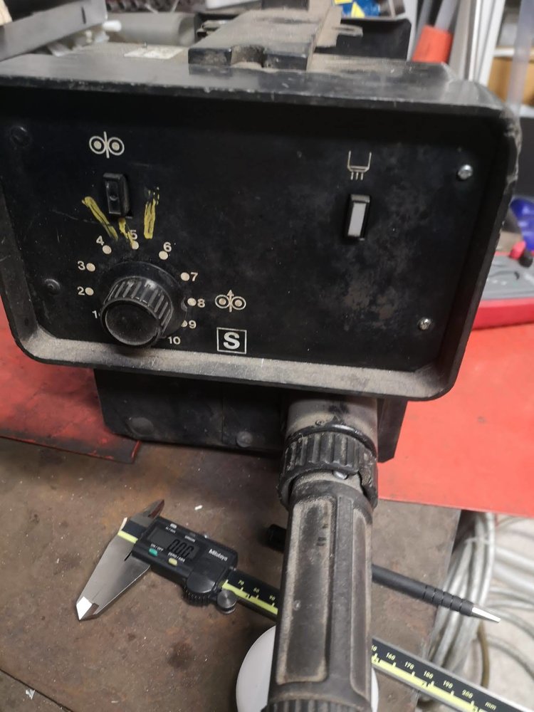

I'll try and keep it as simple as possible, Its a BOC Transmig 350 and a Transmatic 2s wire feeder.
-The Gas solenoid and wire feed both work when the individual buttons are pressed on the front of the Wire feeder so both work correctly.
-I can hear the contactor come in and voltage rises when the Voltage test button is pressed on the front of the 350s unit. (Gas solenoid is also applied at same time)
The probem seems to be, When i press the button on the euro torch, the wire feed works (Indicating the euro torch is working fine) but neither the contactor or the gas solenoid comes in. This leads me to think that there isnt a signal going from the feeder unit down to the main unit. So i continuity checked the umbilical cord between the two and there is continuity between them all. Now, Without a schematic for the welder im fairly stuck. Can anyone provide any help?
The transmig 350 picuture is one from the internet but its the exact same, I didnt have one on my phone. The feeder unit is my actual one.
