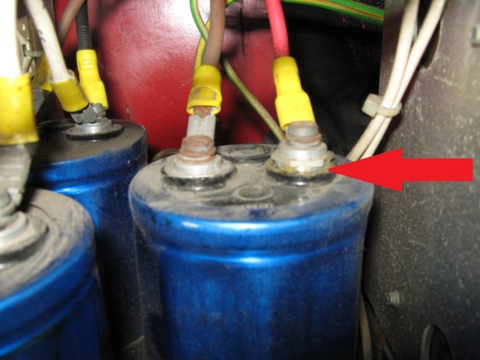

I bought an old transmig 140 a week or so ago. i fired it up today with some .8 wire and a bottle of argon (as i have no co2 argon mix) and a bit of scrap 1" box section set the power and wire speed to 4 and had a play.
it had no penetration and was just a line on lumpy blobs stood proud, i grabbed my hammer and managed to knock them clean off. after fiddling with the controls i can get it to work fairly decent with the wire speed on 4 and the power on 8 but both settings only go up to 10 and it seems unusual for there to be such a massive variation in power setting and wire speed.
i know its a fair old beast so i took the side panels off when i got it and had a quick look around inside to make sure it was all good before i fired it into life.
what would cause it to lack in power output? surely it either works or doesn't work at all.

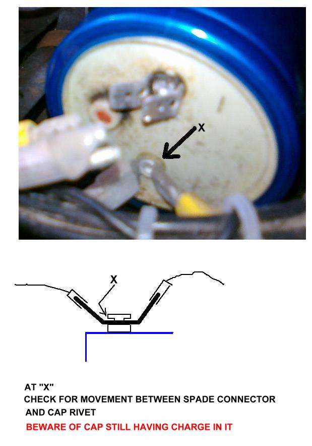

Any hoo the one that "looks higher" is ok it's the other one that's the concern. It has got very hot (due to arcing?) and the plastic has softened and the terminal has sunk! Yes the plastic will be high melting point so goes to show how hot it got. You might be lucky in that the cap/s are ok (don't rush out to buy replacements there not cheep) the "yellow thing" will prob be a milar type capacitors that are there for suppression (look in you electric flymo, will have similar device, stops the crackel on your tv) The m/c looks to have a fair bit of corrosion inc most of the connections. I would one at a time pull the spade connectors off the caps, get a small file and clean up to bright metal. Then undo the large nuts that connect the very thick connector and diodes taking note of any insulating spacers and the order they go together and clean with file these connections. Same with the connections to the case through to outside. How good are you with a multimeter?
