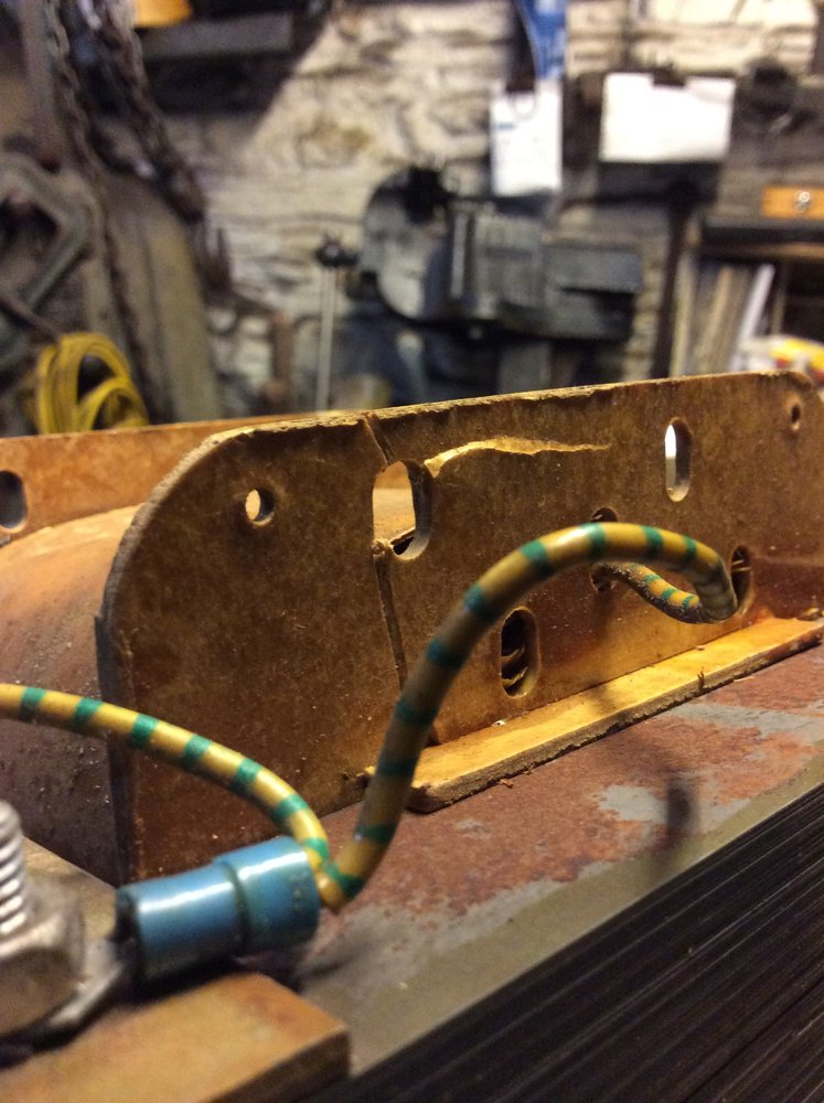

One of my 110v transformers fell off a stanchion,dropped 2m hit the concrete,so it now trips the mains,opened it up,pulled the lump out yet can’t find anything wrong,no arcing marks either,is there something simple I can test,or is it scrap,it’s only 37 years old!
) a couple of 3kVA and three 5kVA 110V trannies.
