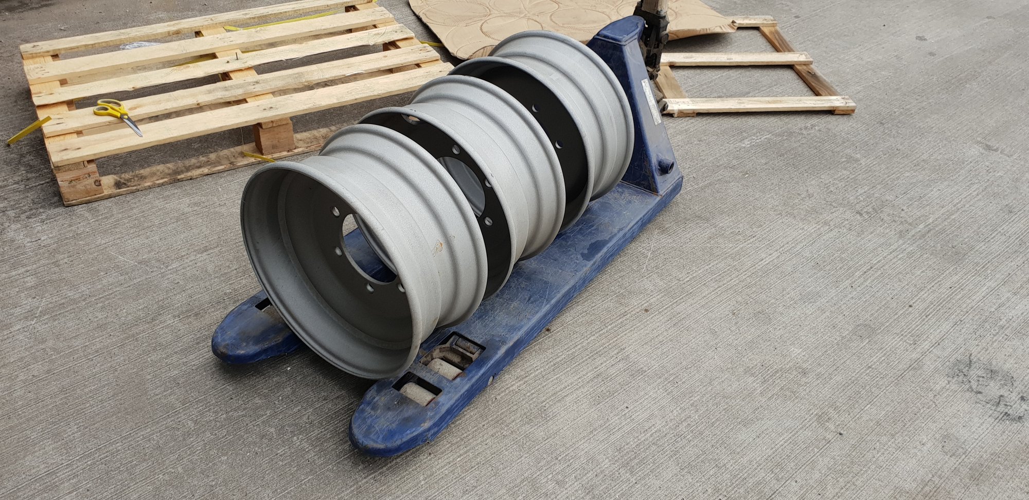

Finally bit the bullet and had them custom made by Aspect wheels.
Saved £30 each by having them bare shotblast finish. Didn't want powder coat so going to use Jotun 87 AL as a primer with a pu topcoat.

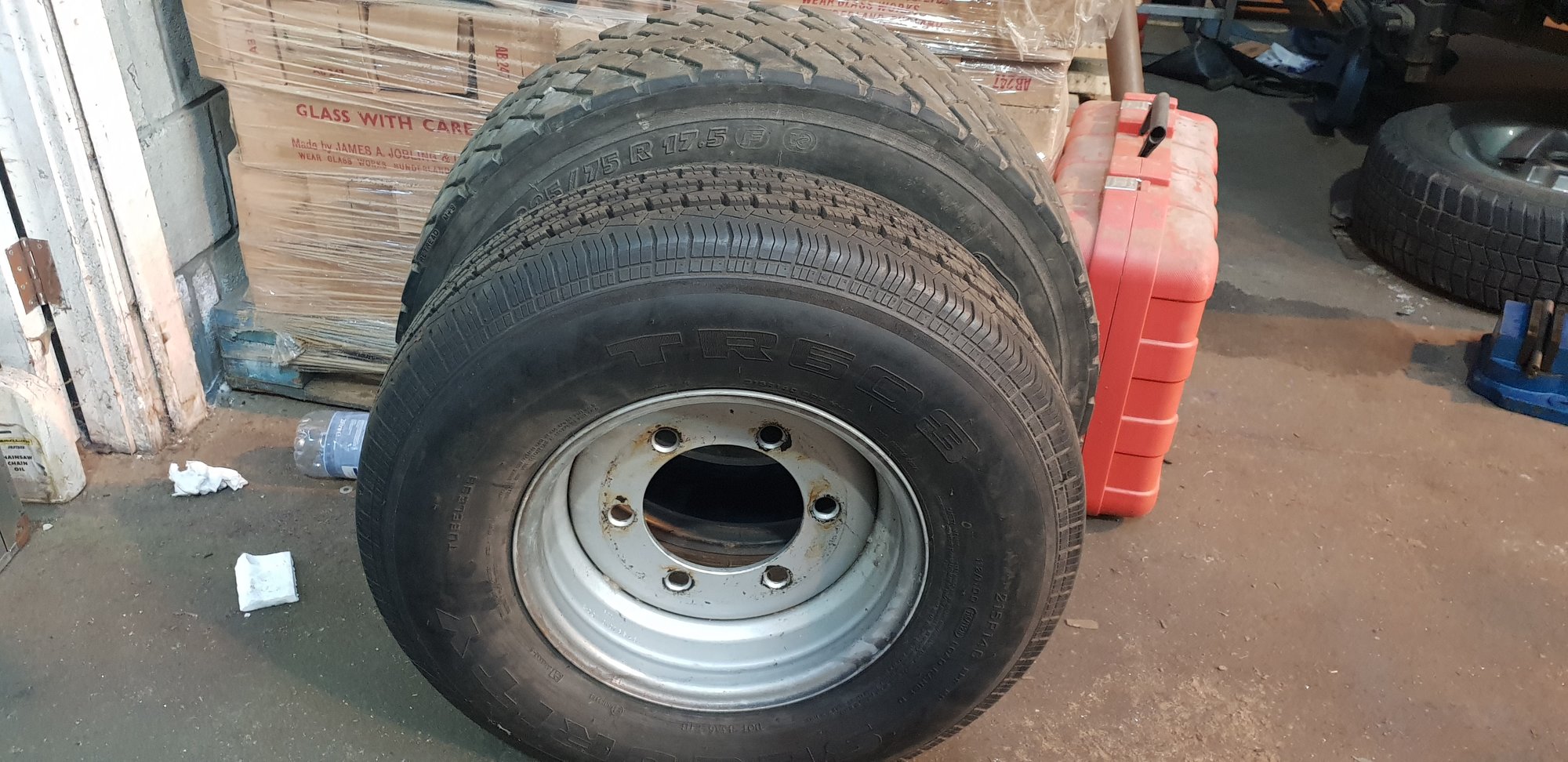

Seriously heavy duty wheels. Nave is 12mm thick. They weigh about 35kg each without the tyre. Lorry tyres going on them 245/70 x 17.5".

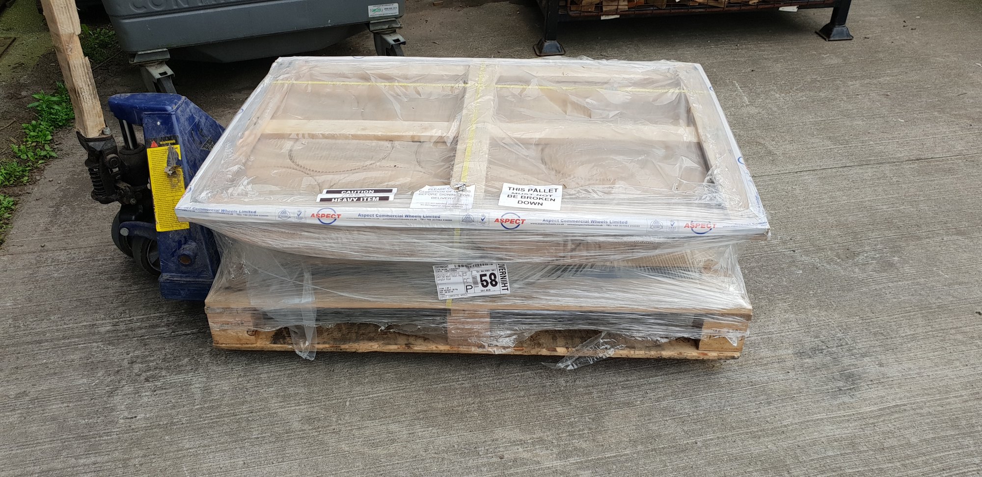

2 main wheels and 1 spare. Arrived today very nicely packed.
