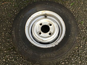

I know they're around, I even have one 13" with 4x4" but someone stuck it on a 4x100 and mushed the holes a bit.

Minor wheels were 14", A35 & Spridget wheels were the same PCD as the Minor ones, but 13" it used to be a standard mod on Minors, fit wider 13" in place of the 14's, the rolling radius worked out about the sameMorris Minor wheels were the same PCD as the Mini, ( 4" ) if my memory hasn't let me down,
ISTR from the dim and distant past that Viva and Imp wheels fit.
yep got some old rostyles on one of mine ( with die grinder cuts for the grease nipples)HB Viva wheels definitely fit a Mini hub.
