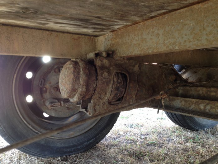

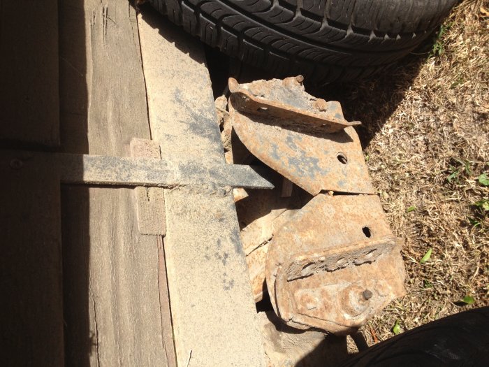

mini ones were air bags that were sealed,so are these hydrolastic then?
minis were not air bags they were either plain rubber or hydrolastic and those metro units on your trailer are hydrostatic I dont know how they are linked but it could be that it just needs re filling / pressurising to lift it back up it looks like it could be a four wheel trailer so the two units on one side would be linked, I would think, you would have to fill it to see where it is leaking .mini ones were air bags that were sealed,
