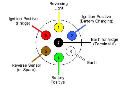

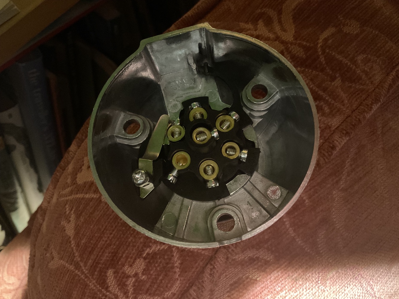

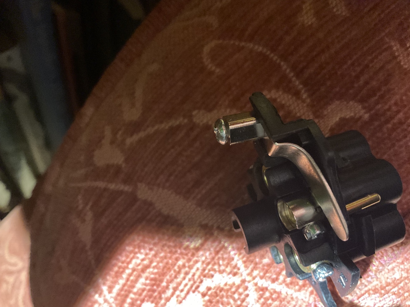

Never wired one with 8 wires,the extra,purple wire is to divert the current from the towing vehicles fog light to the trailer fog light. The supply wire from the vehicle wasn’t connected to the original trailer socket so I’m cautious to reconnect it to the new socket for fear of damaging the vans electrical system,2001 Mercedes 311 sprinter,would some sort of relay need connecting? Thanks.
