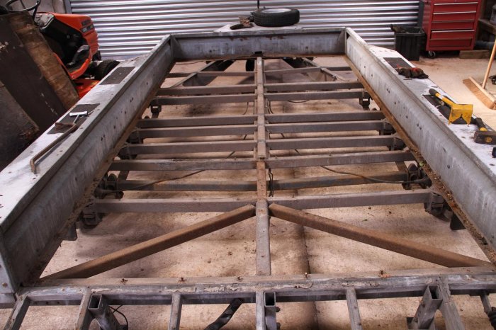

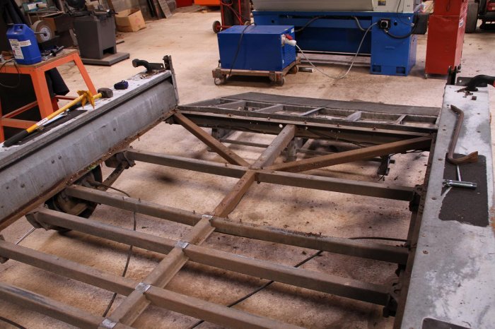

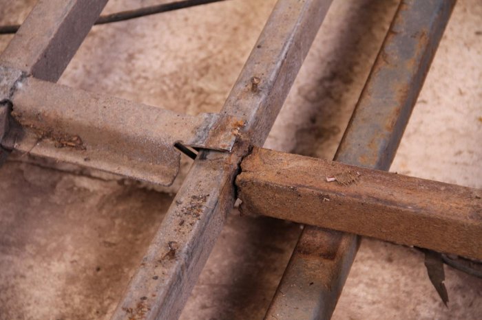

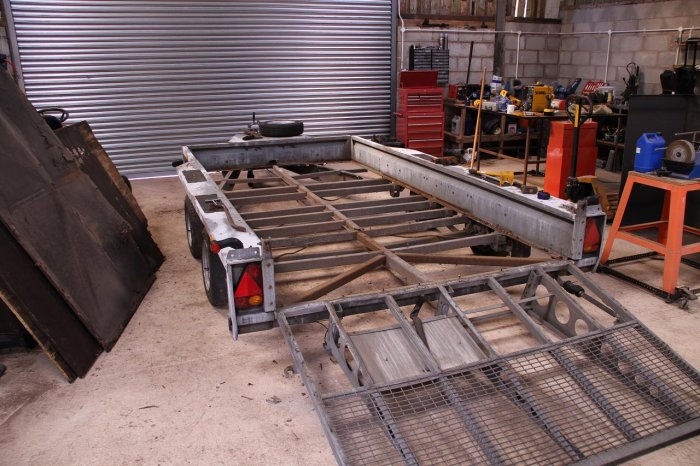

I got myself a new trailer the other day to lug my digger around. Its a 2008 Ifor Williams GX126. I knew it needed a bit of sorting. mainly flooring and ramp chequer plate along with a couple of bent cross members but the price was right.
I ripped the old floor off it yesterday and found the someone in its past had modified it.
Does anyone know how it should be, unless Ifor Williams employes pigeons as welders I am pretty sure that the two diagonal braces and the welded (well one side) center brace are not standard. I am wondering if there is a cross brace missing?
I have attached a few pictures, anyone any suggestions?
