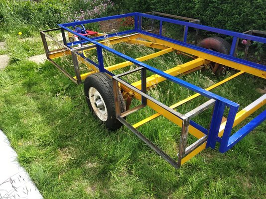

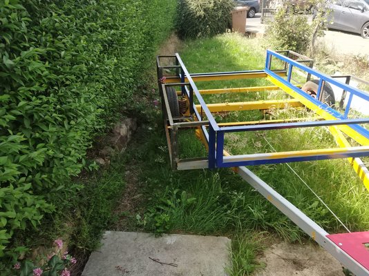

Lower tub welded up.
It has location "tabs" which are a tight fit around the chassis just to hold it in the correct placet, and its going to be bolted onto the chassis, rather than welded.
It needs painting first - and before then i'm waiting for a roloc adaptor for the grinder , since the polydiscs i ordered have a 16mm bore, rather than the 22mm i was expecting.
I've also ordered a "katsu" wide sander/burnisher.
I also have to touch up the "tractor enamel" as it's still quite soft - even after 3 weeks.
