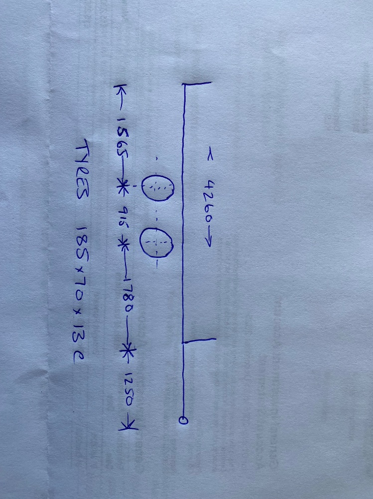

Hi,
I am building a twin axle trailer with a 6m bed.
Over the last week i've been double checking my calculations for where to position the axles to ensure the hitch weight is correct. One thing i can't find much information about is how far to position the axle apart. The plans i am working off say 90cm between centres, but this feels too close for a 6m bed. Google says between 1.3m and 1.8m, but i can't find much information to back this up (compared to where to position the axles along the bed 60/40 where there is lots of information and calculations available). Can anyone help?
Regards
James
Regards
James

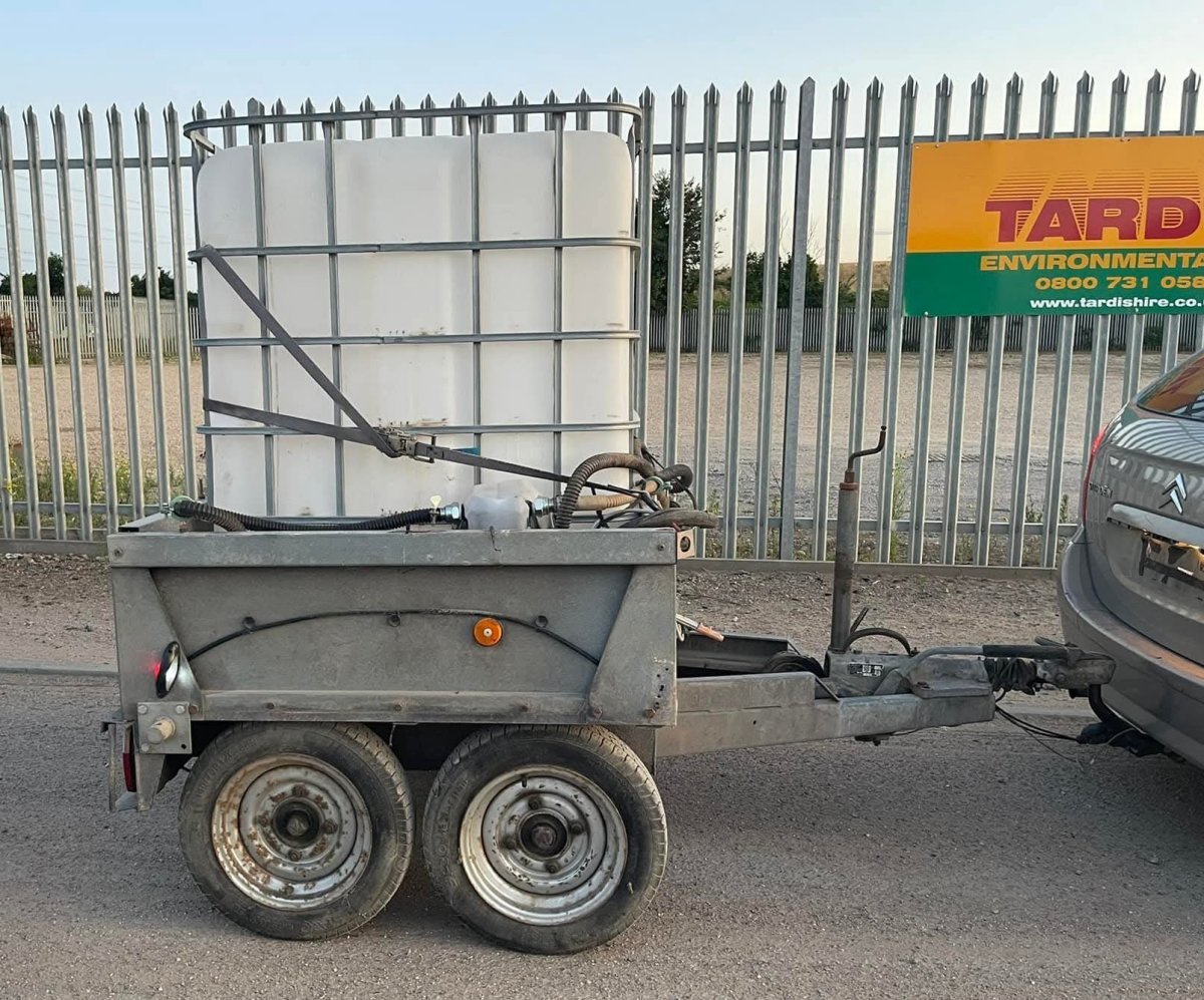

But round here they are mainly short twin axle trailer (horse boxes/short bed)
