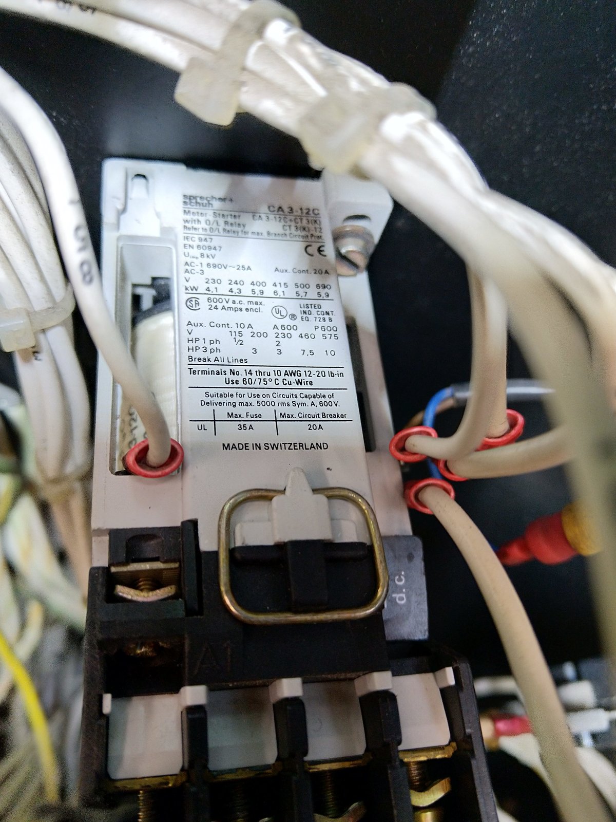

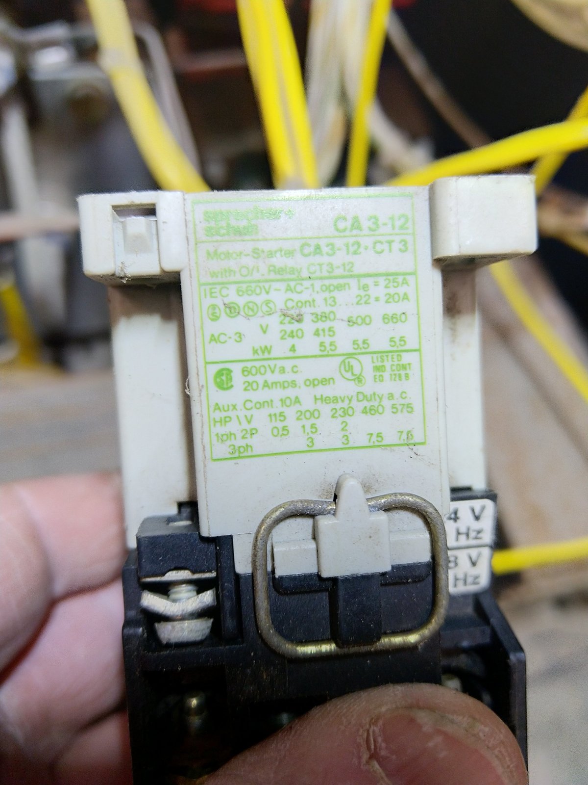

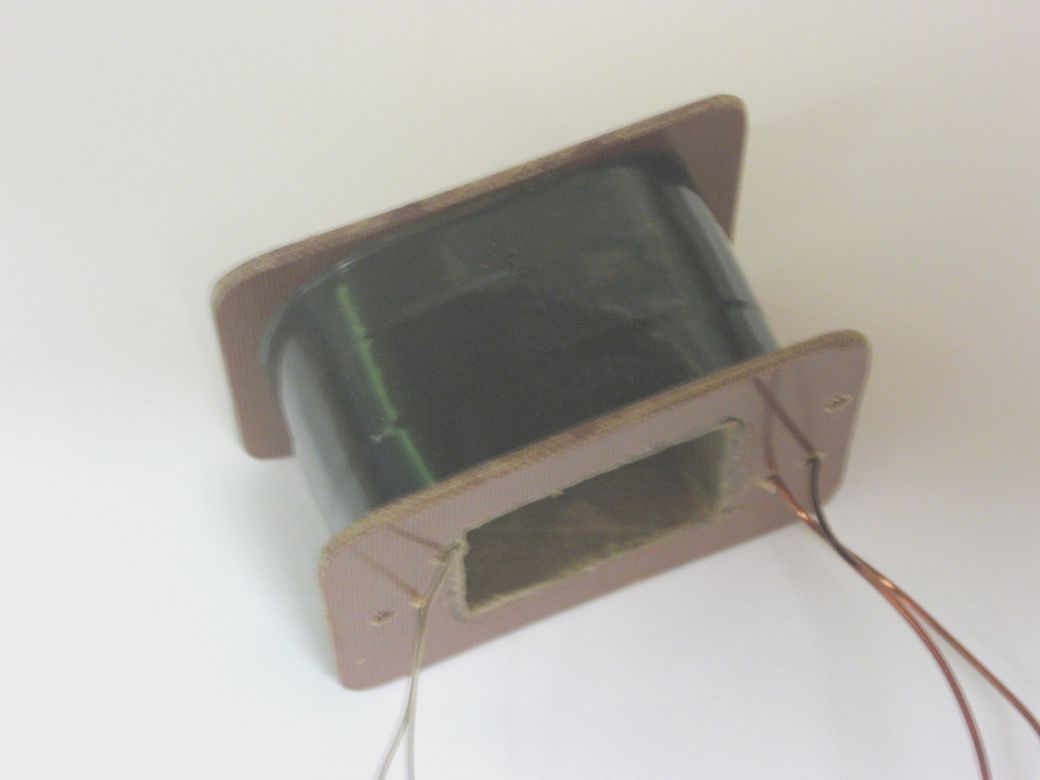

Regarding your contactor coil; you don't need to know what voltage it is indeed you need to know very little about it. Be very careful in removing the coil noting all connections which is important; a simple sketch with notes will do nicely. Once the coil is on the bench then remove the outer insulation to expose the first layer of winding turns; count the turns as they are unwound but an easy method is to count the layer before unwinding and make a note of the number; the coil will be neatly wound so now simply keep unwinding but note the number of layers; having unwound and noted the information the winding will then change to a different size of wire; many of the transformers I wound had a number of coils many even had "tappings" but by taking care and noting every little detail the transformer will be unwound leaving just the former (bobbin). As unwinding progresses the fault will make itself known as a break in the wire.
I could go on at length but it's possible the contactor coil is just a single coil of wire only having one winding making it very simple indeed to rewind; I've never rewound a contactor coil but feel anyone with an home workshop would find little difficulty in rewinding such a coil. The problems found to make it difficult are the embedded coils either embedded in tar or resin; tar can be melted which is an incredibly messy job but the resin types are disposable and need to be completely replaced.
I've seen many methods of wire winding and a browse of YouTube is sure to have videos on the subject; please don't feel intimidated by coil or transformer winding; having rewound the first successfully it all becomes so much easier; no one at all taught me or showed me I started from scratch and found transformers and coils etc to be very interesting. Rewinding is reasonably easy because all the information is already there; designing a bespoke transformer is much more difficult but I progressed into this and wound transformers for my own needs as in power supplies.
Once you have the coil out inspect it for identification details; many electrical stores selling motor starters etc carry stocks of assorted coils and you might get lucky.
As to rewinding such a coil once the wire is unwound then identical gauge new enameled copper wire needs to be bought; this isn't difficult because you'll need to very accurately measure the wire gauge (thickness) either with a micrometer or digital vernier caliper; weigh the original wire then buy more than this;

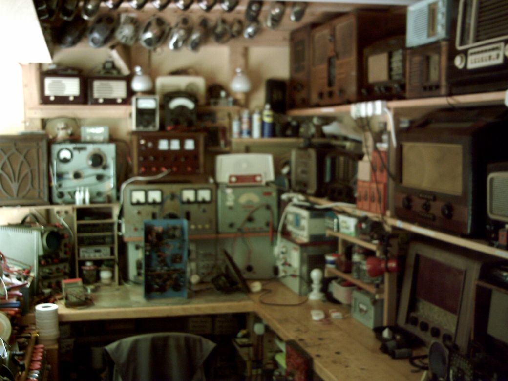

My radio shack with a vintage radio chassis on the bench; this work is extremely dangerous and I don't encourage any novice to follow my lead; one mistake with a chassis under mains power could prove the last mistake ever made. Sorry about picture quality many of these old pictures were taken in very poor winter conditions.

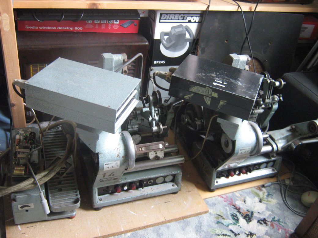

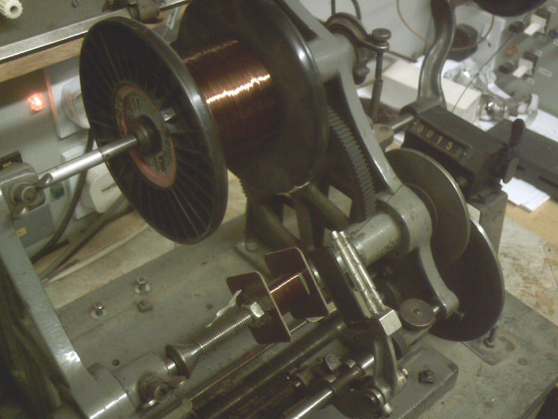

Two German Aumann electric coil winders.

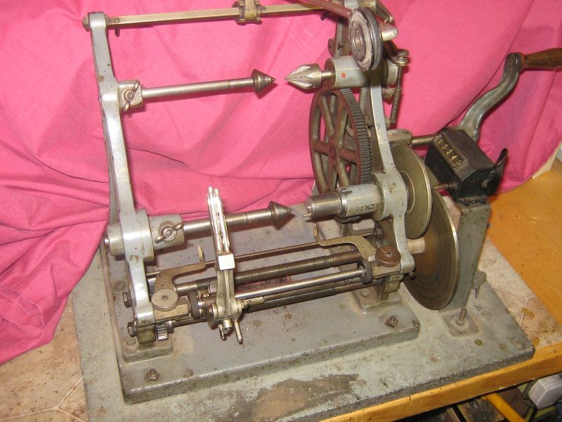

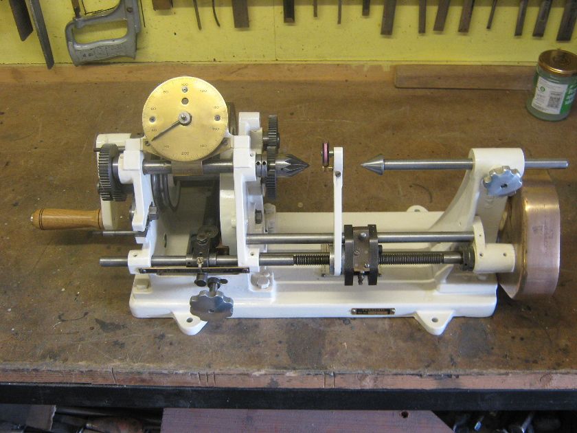

AVO Douglas manual coil winder which wound many of my transformers and coils. Please note there is a huge difference between a coil and a transformer; a coil is very simple and basic and I think the contactor will just have a coil?
I fully restored this very special AVO Wave Winder; I used to submit and have articles printed in "The Bulletin" The British Vintage Wireless Society publication.

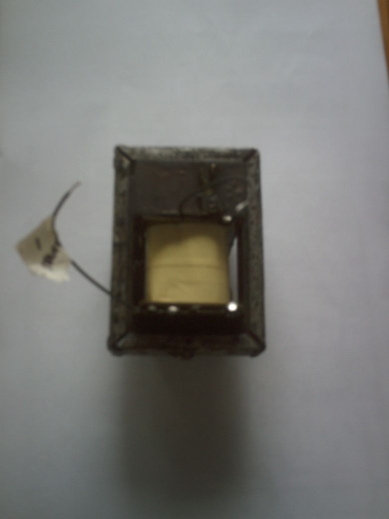

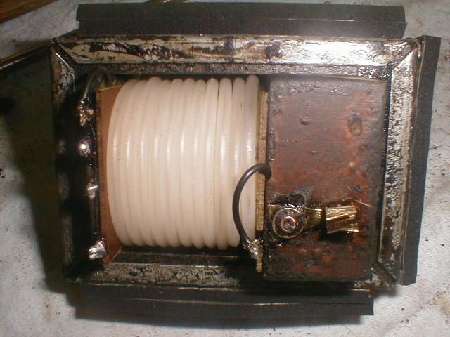

Here's a transformer wound from scratch with home made former.
Another transformer.
A transformer for a TV.

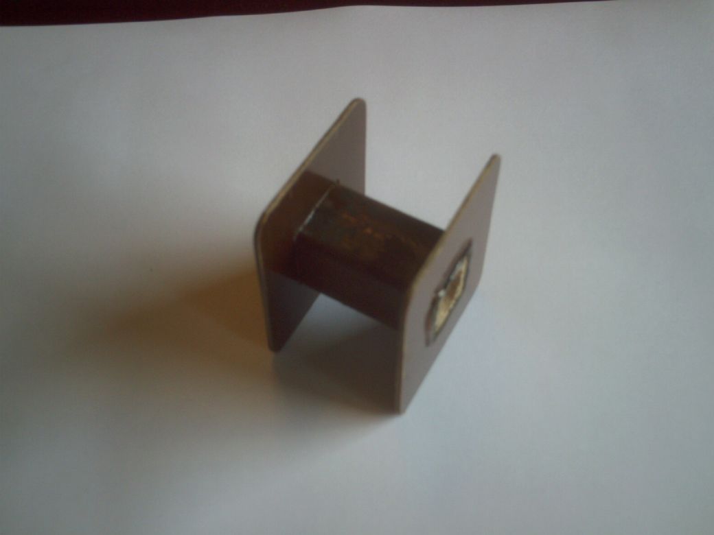

Home made former (bobbin) I made lots of these in many sizes the smaller ones often out of cereal cartons.
Winding underway; some on the small radio output transformers could have as many as 3,000 turns of extremely fine wire just in one coil.

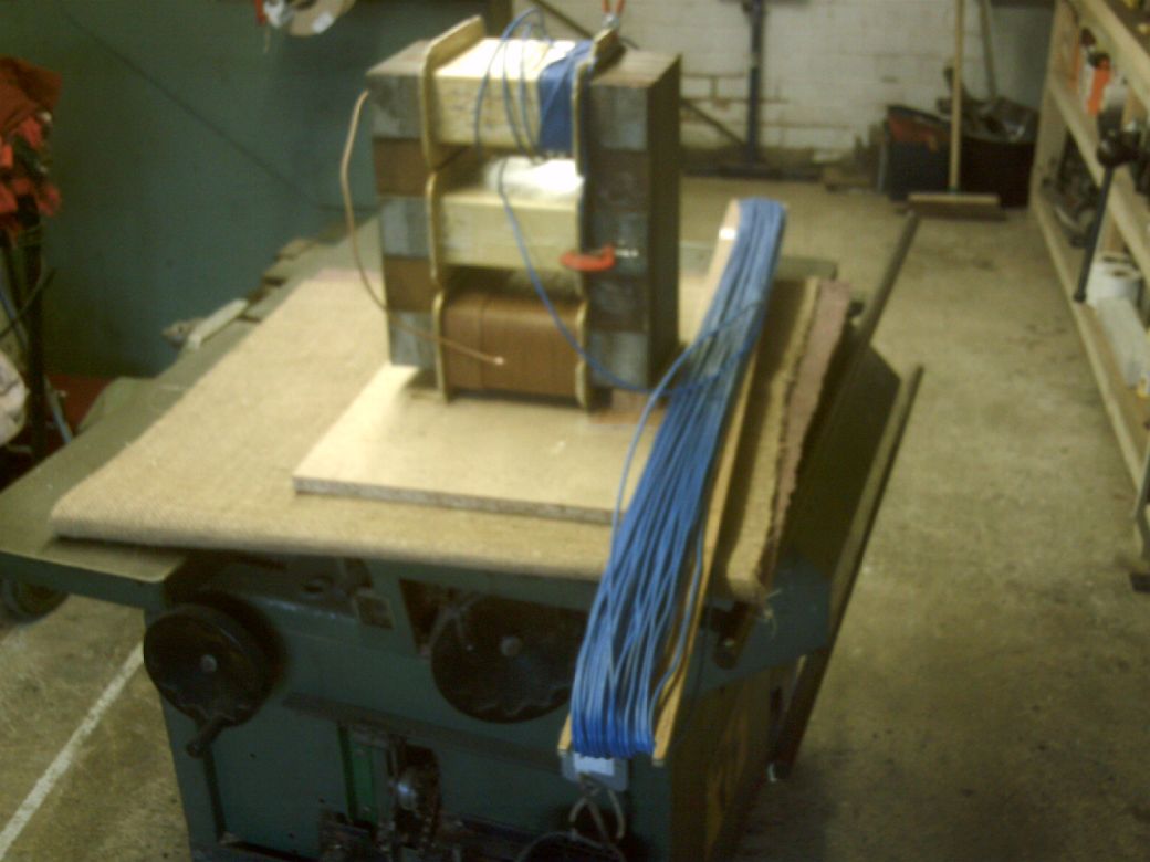

Here's a 75kg transformer being wound to suit my specifications; the wire here being household heavy conduit wire; the long item is my idea; it's what I call a shuttle to aid winding and it worked so well I'm credited with the idea.
