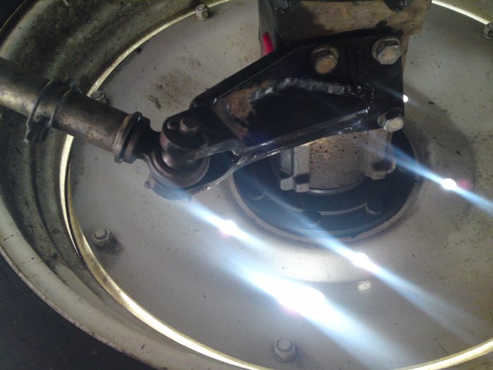

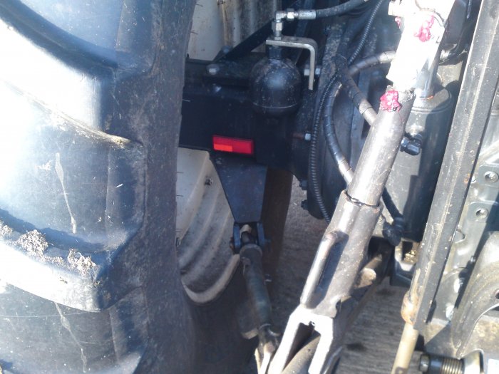

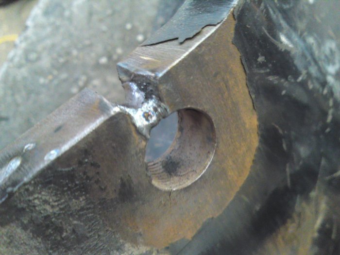

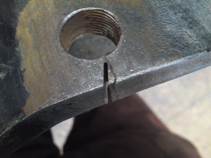

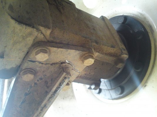

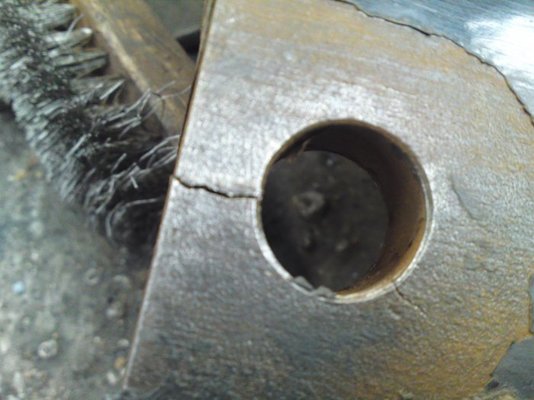

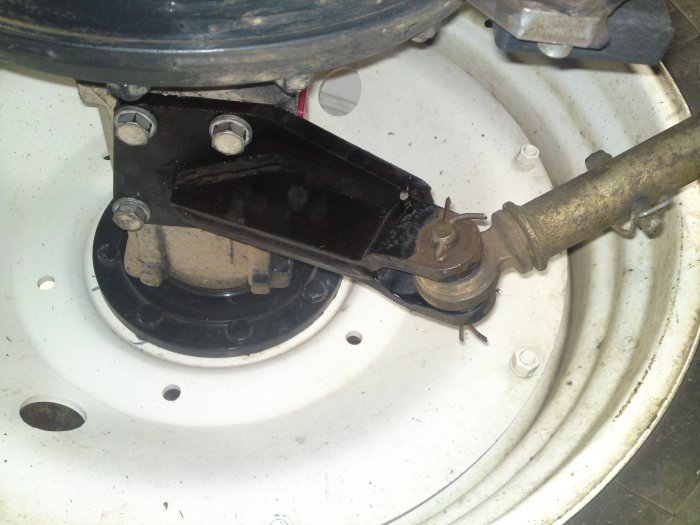

)He put it down to poor adjustment of the turnbuckles when ploughing (i.e it's the other person's fault!). You're right though, the bolt holes have had a hammering, it's interesting it's not common.
Jim.
looks like someone may have tighten the stays to much![]()

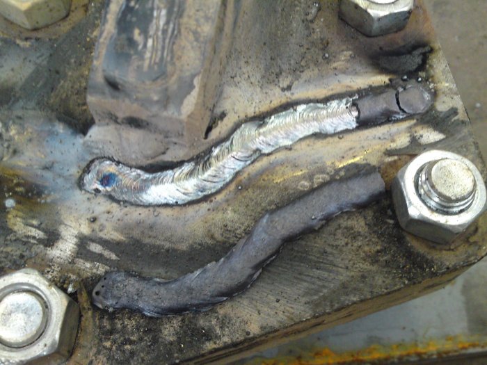

6080? IMHO the cause has been lose studs at some point especially as they have witnessed on the threads, 15 years as our local NH dealers welder and I would say Iv seen only one bracket fail, pretty proven as they've been the same since the FIAT winner days...
