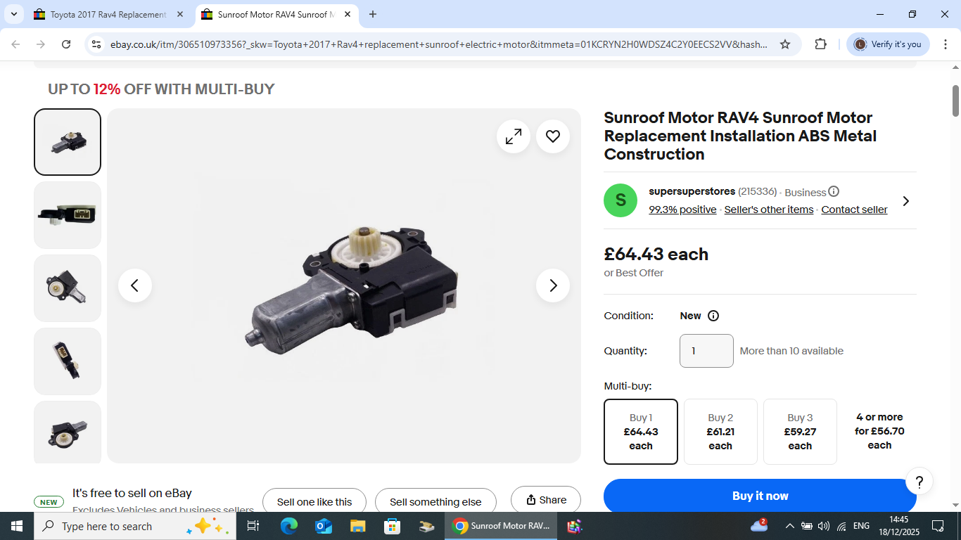

The garage say the sunroof motor has failed and are quoting a repair cost of £1500 including £1000 for a sunroof motor! A quick google confirms that is in the ballpark of price for a new genuine Toyota motor!

I always try to avoid cars with sunroofs and am not offering to do the work as I have no workspace undercover. Pretty disappointing from a Toyota main dealer never mind how do Toyota justify £1000 for a sunroof motor!
