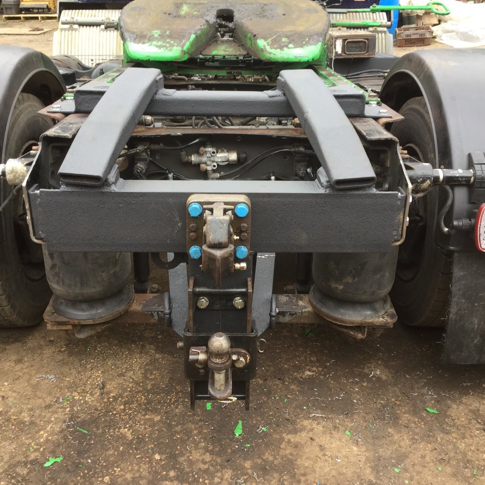

Been asked to make a conversion coupling for a friends LR,it has a NATO jaw currently,he sent me the photo below.

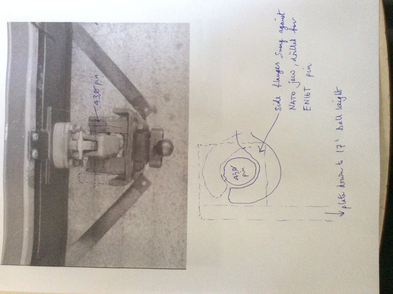

I want to make a deep channel,fitting snugly each side of the jaw,then drill for a 43diameter en16t pin,welded to each side flange,the nose weight and push from the trailer,can be absorbed by a thrust plate ,under the existing jaw mounting,then for sway restraint,2 ,braces as in the photo.
Or is a ready made conversion hitch available? Thanks.
