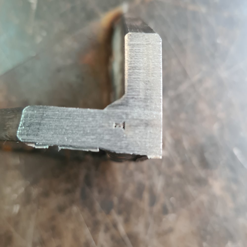

I assume that's a typo, you mean 200 Amps. However, that is low for MIG on 10mm plate with no bevel.10mm plate. 20amps
Indeed u are correct. I'm pretty new to mig and the machine . There's a volt adjustment. It was on 19.what is puzzling me is that there is penetration on one side and not the other ?I assume that's a typo, you mean 200 Amps. However, that is low for MIG on 10mm plate with no bevel.
Is your machine the Total TMGT1601? If so, the specs state max current is only 160 A, so if you read 200A on the display, it is flat-out and over-optimistic.
TOTAL Inverter MAG/MIG/MMA/TIG Lift welding machine 160A (TMGT1601)

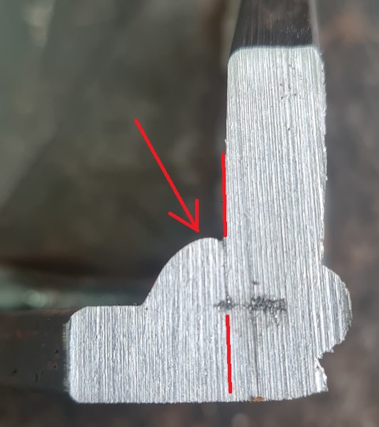

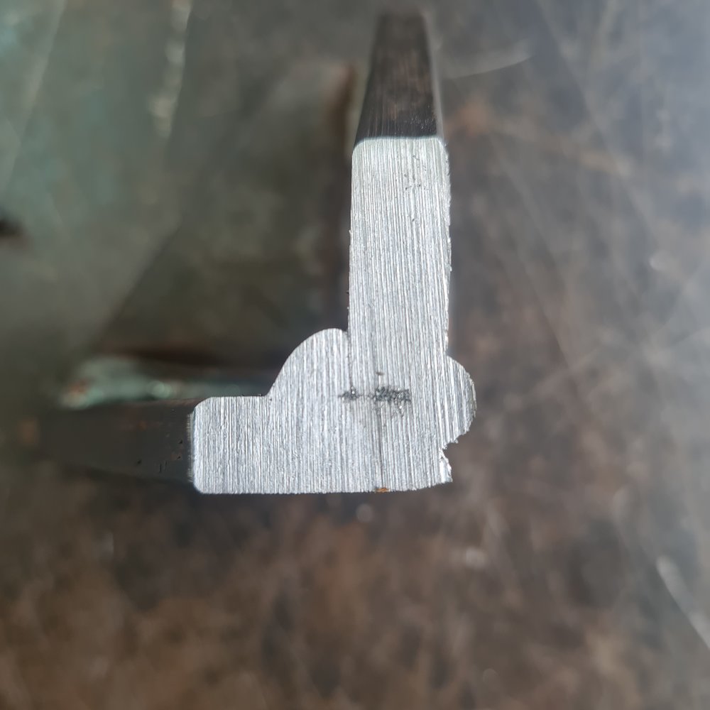

Many thanks. Makes alot of sense on all u say. Please excuse my ignorance. What does wetting mean? This was just a test piece and practicing.My view:
Cleaner is usually better but this is more lack of fusion and lack of joint penetration.

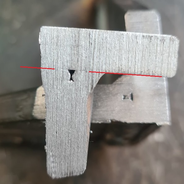

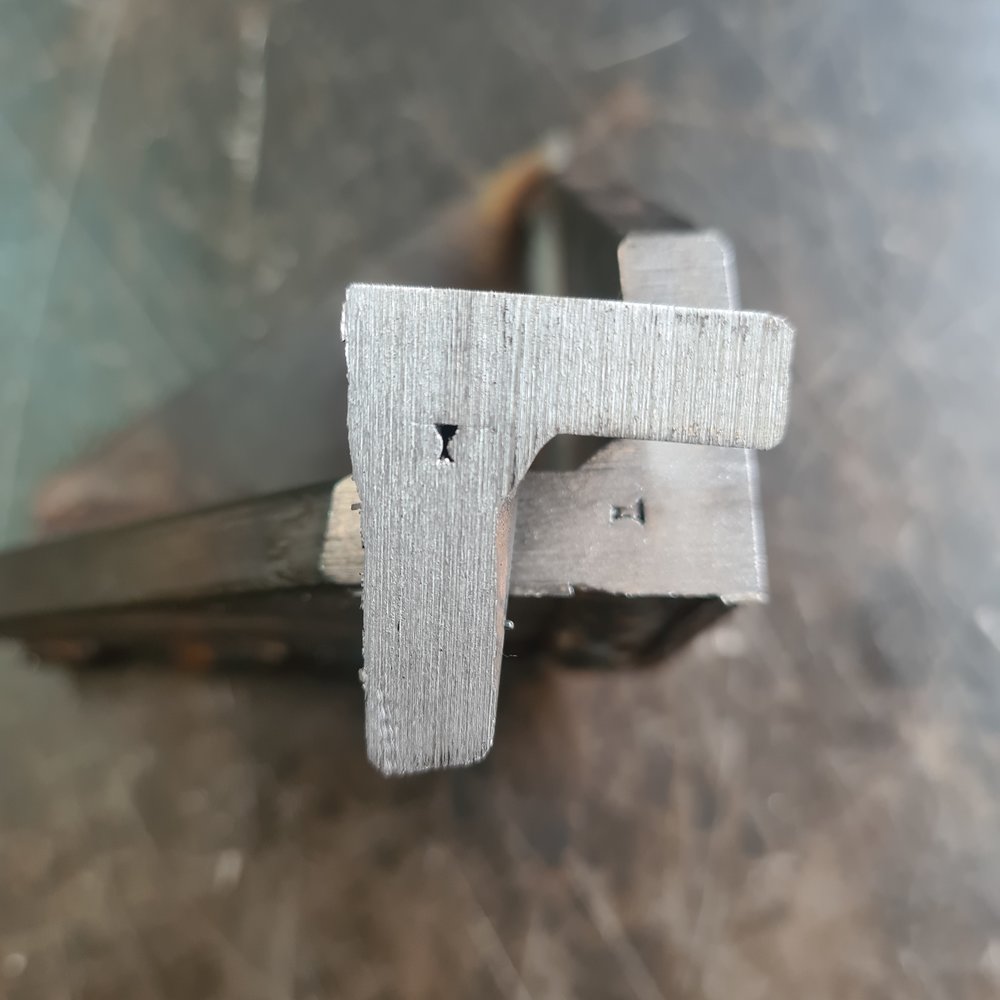

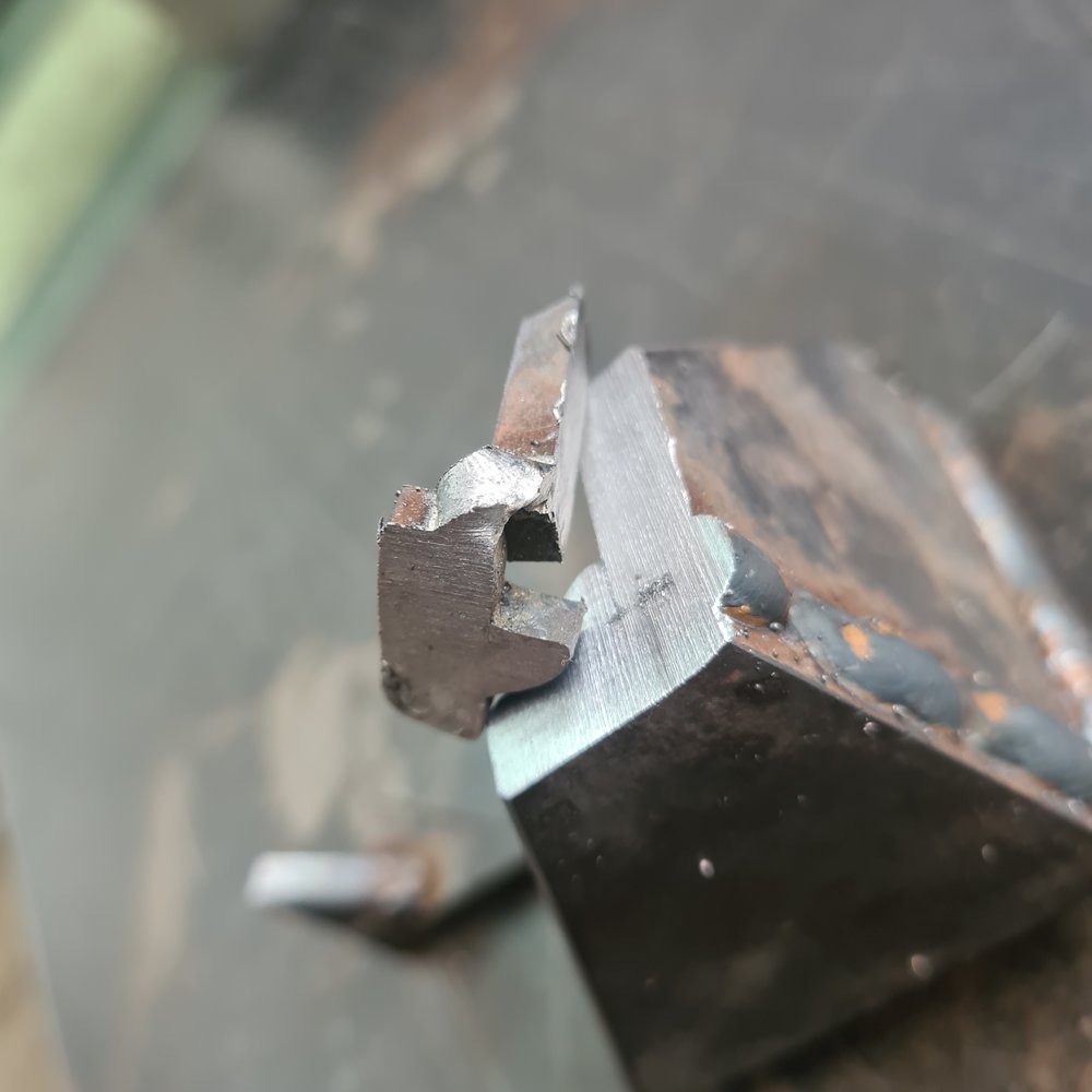

The void in the above image is a lack of joint penetration that might have been avoided with some joint preparation. In addition to cleaning, bevelling would achieve a better weld width to depth ratio and allow better joint penetration.
(I assume that since you have welded both sides, you were attempting full joint penetration - particularly as there is a gap.)
The line section between the two red segments shows lack of fusion. Torch angle would not have helped much because of the restricted access (no bevel) but more power (hotter) might have helped.
The vertical edge of this weld also shows pretty bad lack of fusion. Polishing and etching would make it easier to see. In this case, laying the torch down a little (to point towards the vertical plate) might have helped.
Again, there is a lack of root/joint penetration.
The top toe (arrowed) has a contour typical of a lack of wetting and the resultant lack of fusion.
I am not a welder so I apologise if my terminology is off.
