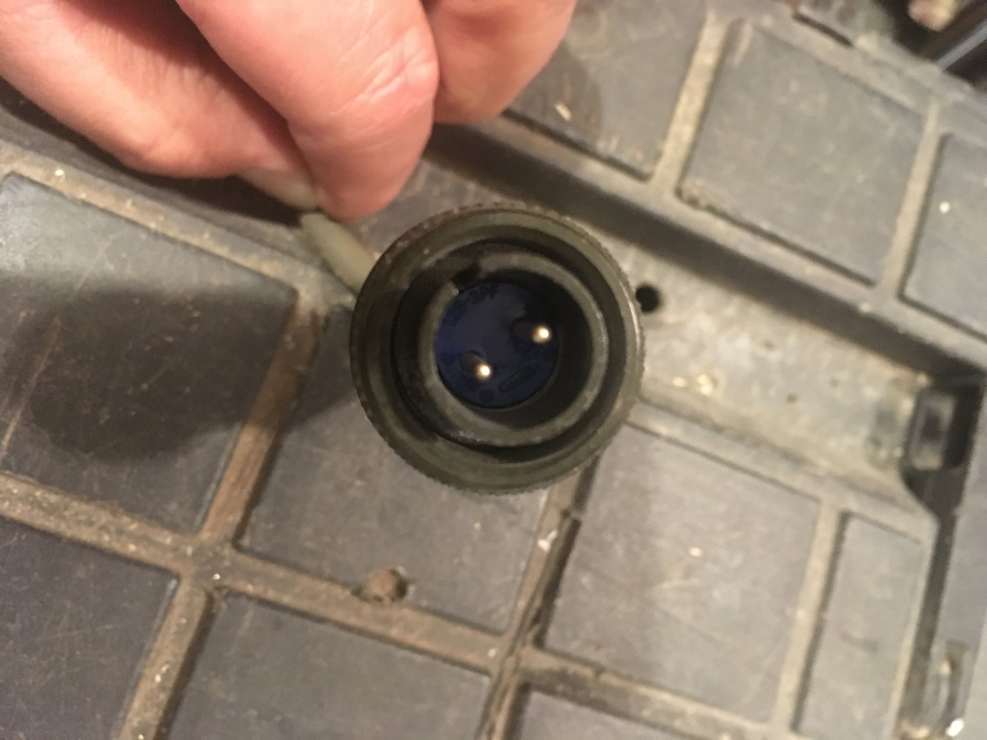

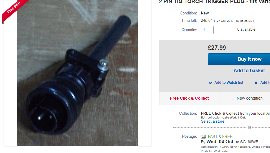

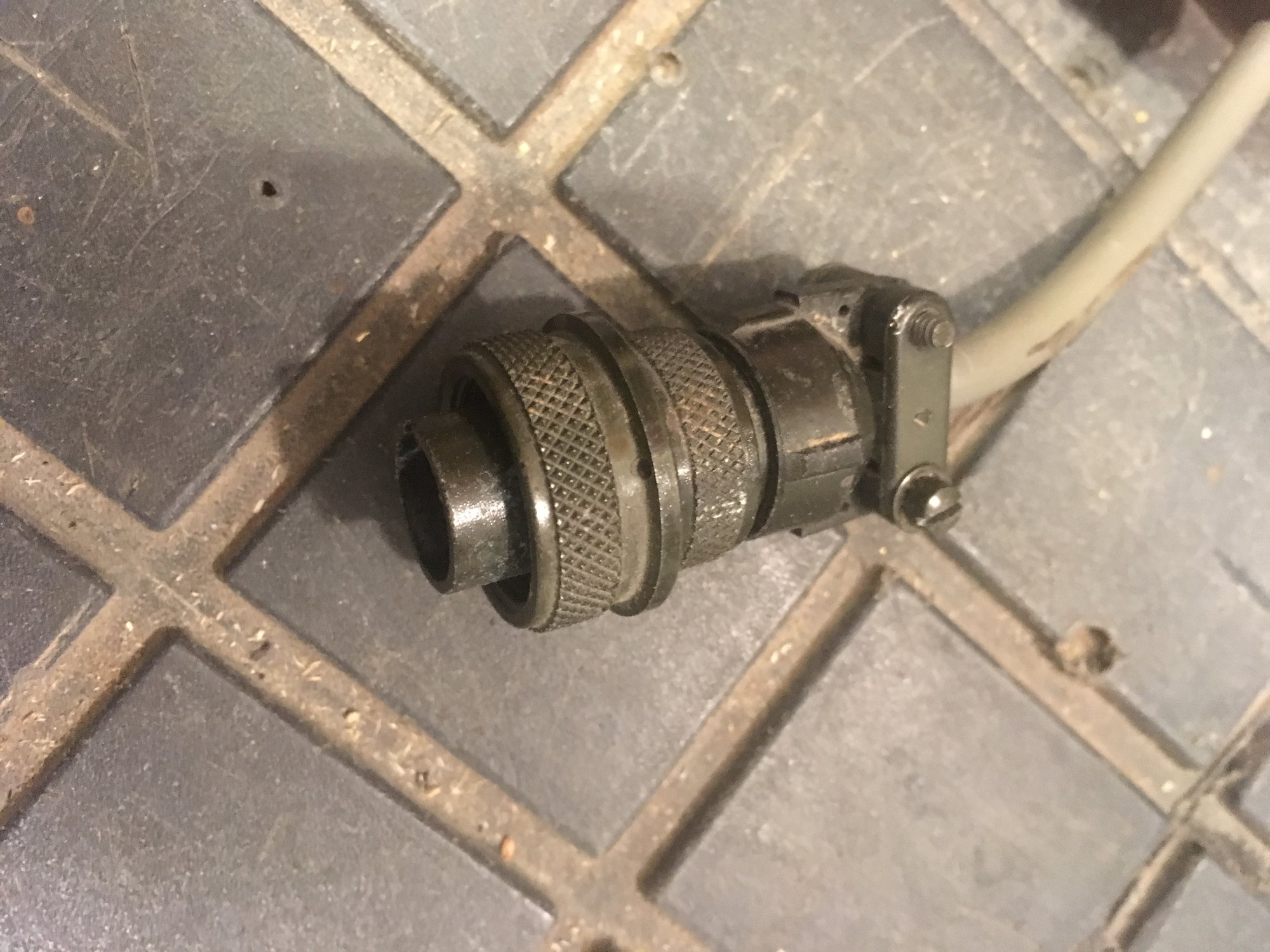

If the above links are not able to help I think that might be the way it will have to go, I think I have just found one on Tech Arc's ebay pageJust an idea and not the answer you are looking for but you could always cut the existing cable about 6 inches from the welder to make a pig tail with an easier to find socket, then fit matching plugs to both torch and foot pedal.
