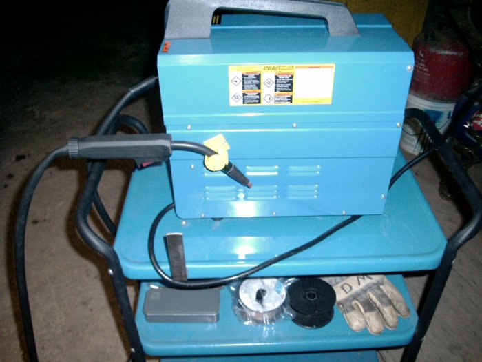

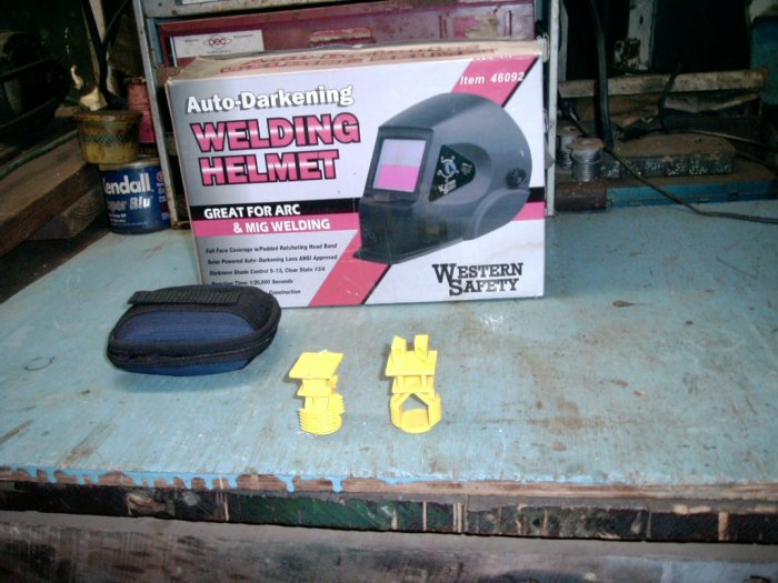

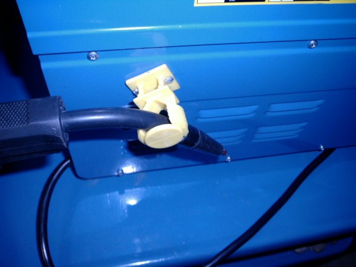

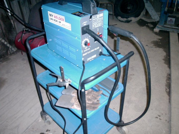

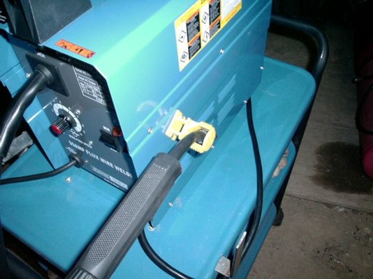

I have one of the so called "live torch" welders.You have to be careful where you set your torch when you are through welding or you might get a surprise.I usually hang my ground clamp on the side of my cart when done but I have to watch and make sure the torch don't touch the cart or it will arc,so to remedy this I made a torch holder out of a electric fence insulator and mounted it on the side of my welder case.It is made of plastic so there is no chance of an arc,work's pretty good.
