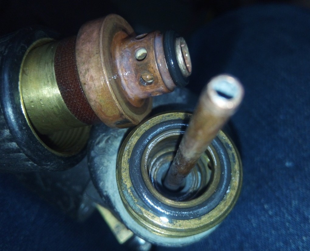

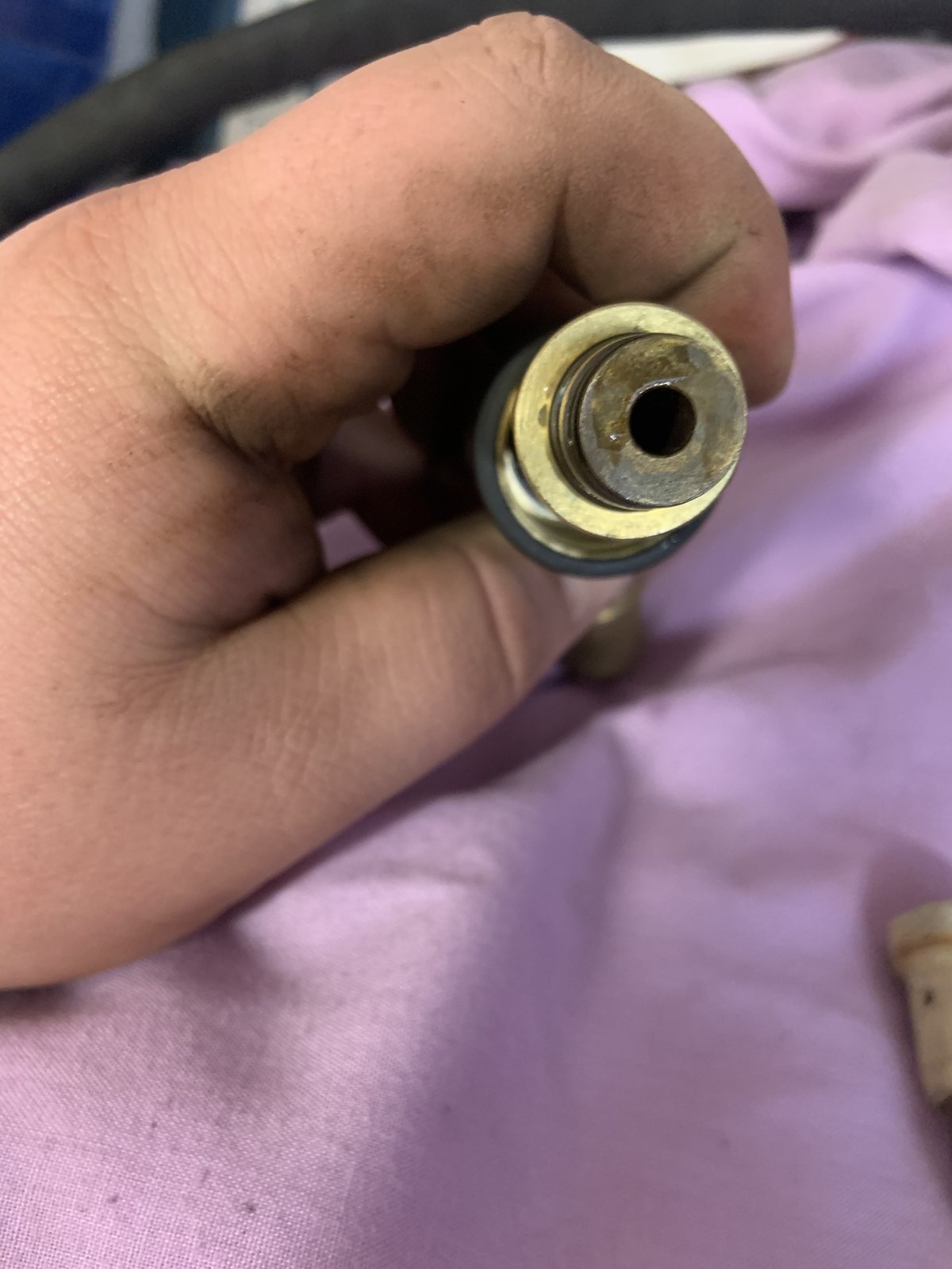

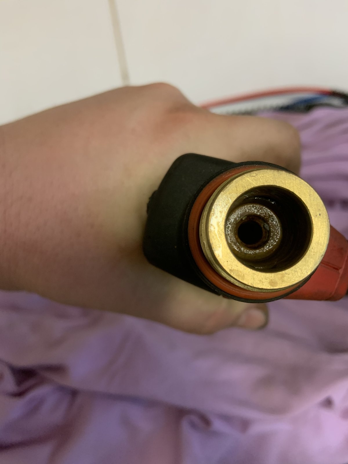

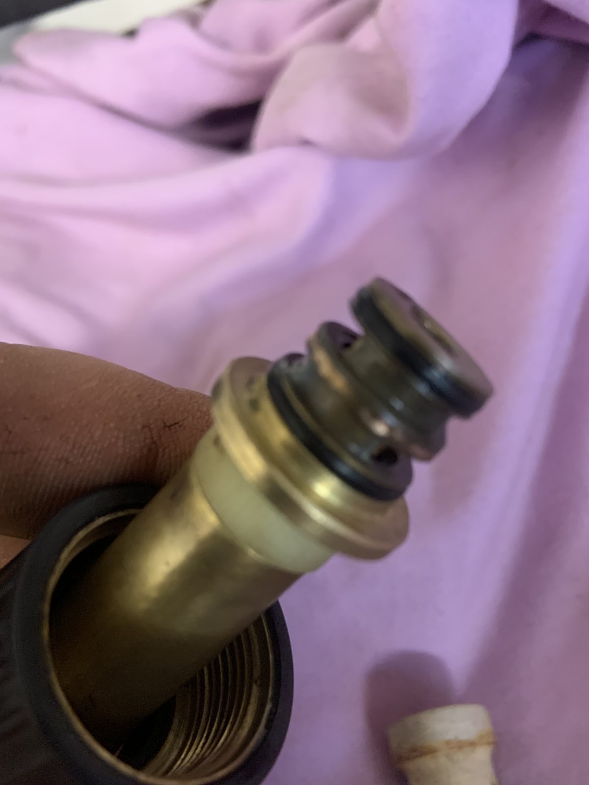

I have recently acquired an ex-Demo Lorch MW7500, ran into an issue with the liner.
turns out the coolant has been leaking past the swivel neck. I guess the o rings have worn or shrunk.
I’m trying to find the replacement parts but having no luck.
you can see the way it works from the photos below. like two channels, cold feed and hot return. The problem is if these leak, water/coolant can travel down the liner which is I think what has happened guessing by the rusted state of the liner.

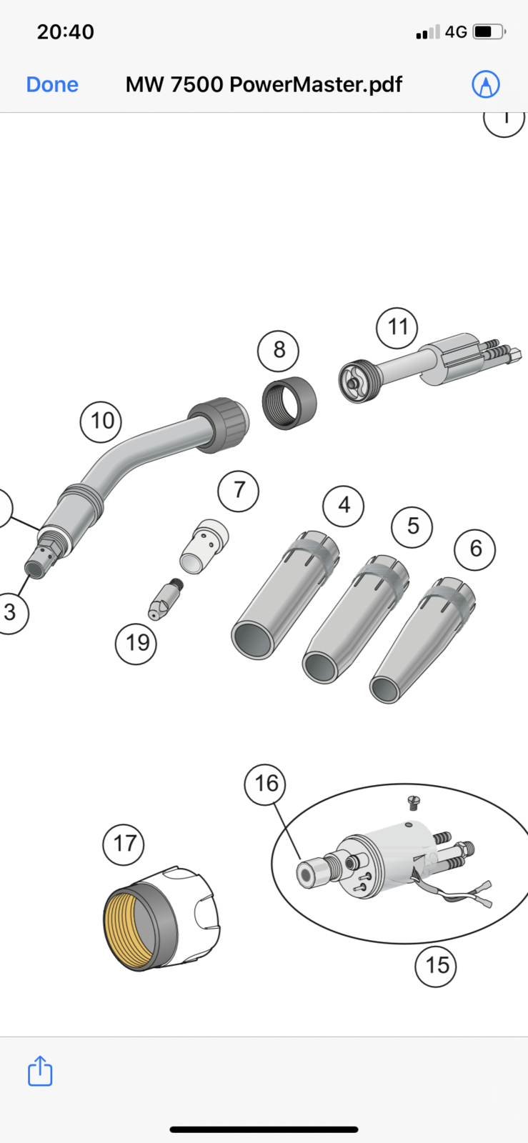

The Lorch parts list shows a different design to my torch unfortunately and binzels website isn’t very useful either.
Anyone use these?
