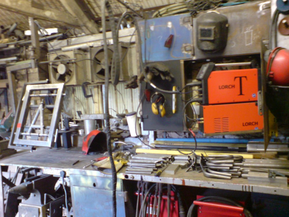

How do you stop the weight of the torch cable pulling on the torch when you arent able to sit when welding?
Also, what about out of position welds? Would one of those re-usable quick release cable ties come in handy?Run the cable over your shoulder and let about a metre of it droop down in front of you, just don't strangle yourself when you walk off for a slash.
Thats what i usually do, but find the weight still pulls on my arm and its a bit awkward at my wrist. Im interested to find how everyone else deals with itYou can snake coil it around your arm,carefully not to restrict flow of gas or liquid
I hang my torch cable from a movable arm above me when welding standing up.
It seems to take most of the weight...pic below.
