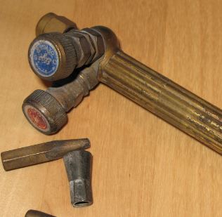

Hello from Alberta Canada. A friend of mine came into possession of this older Elga torch. Any idea why it has 2 oxygen knob''s?
This a total disaster waiting to happen.You have two oxy valves,not good, you and a left hand cutting nozzle,fueL gas,being fed from an Oxy valve.PUT IT THE BIN BEFORE YOU,AND OTHER PEOPLE GET HURTI would guess it's a botch up because the original knob was lost and they had a spare oxygen marked one and welcome to the forum.
Run away, run away"200bar" on torch ??
