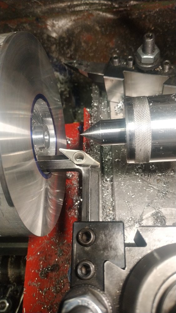

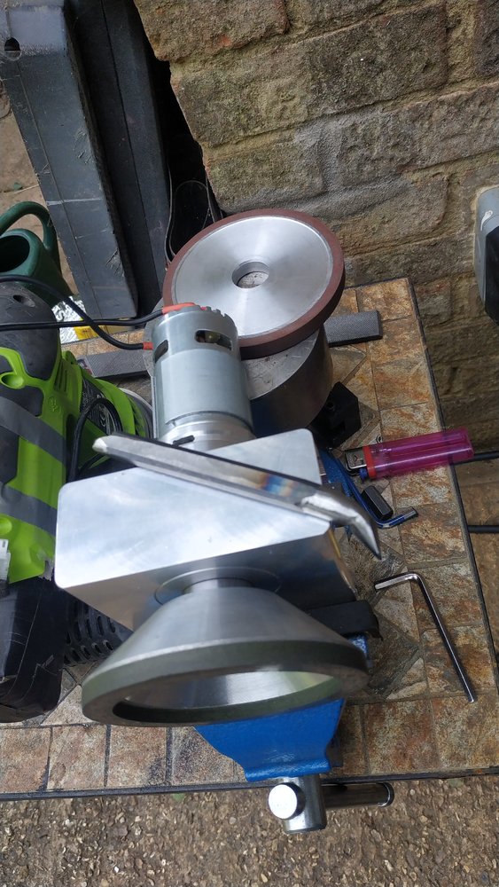

Large overhanging lump of aluminium, cant be turned without a support. Far too big for my steadies.
I could tap the chuck end for a draw bar? Would that be adequate to secure it without a centre?

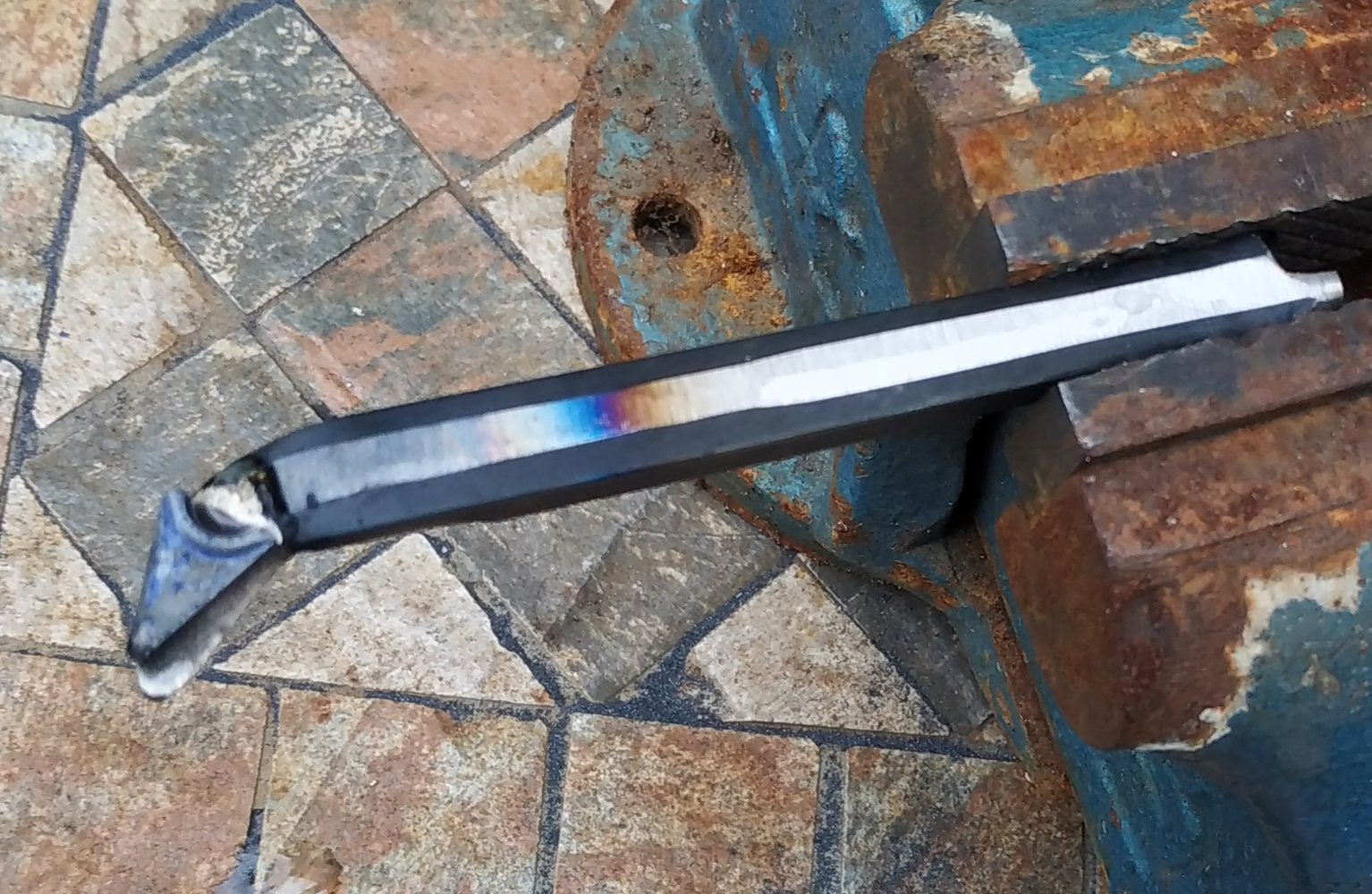

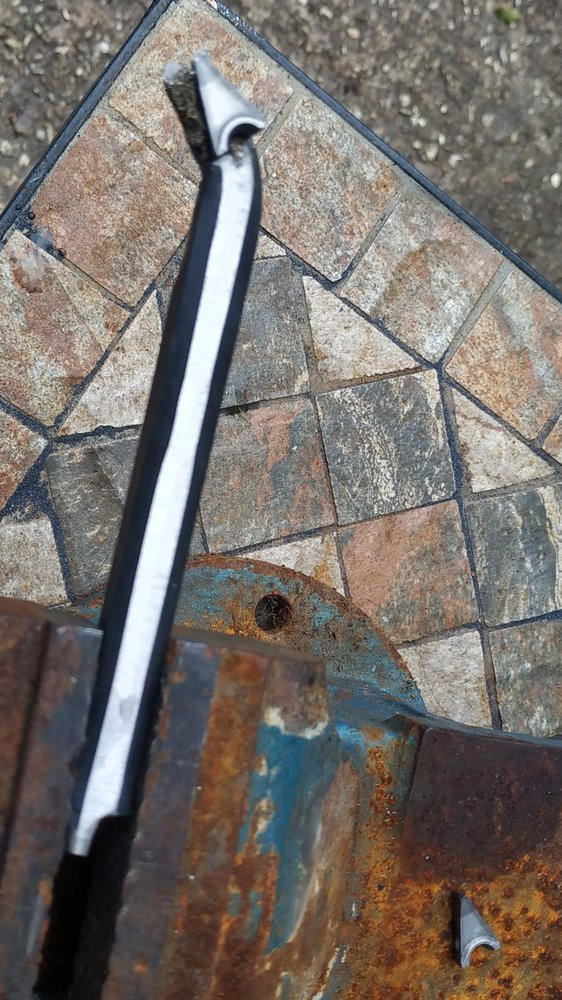

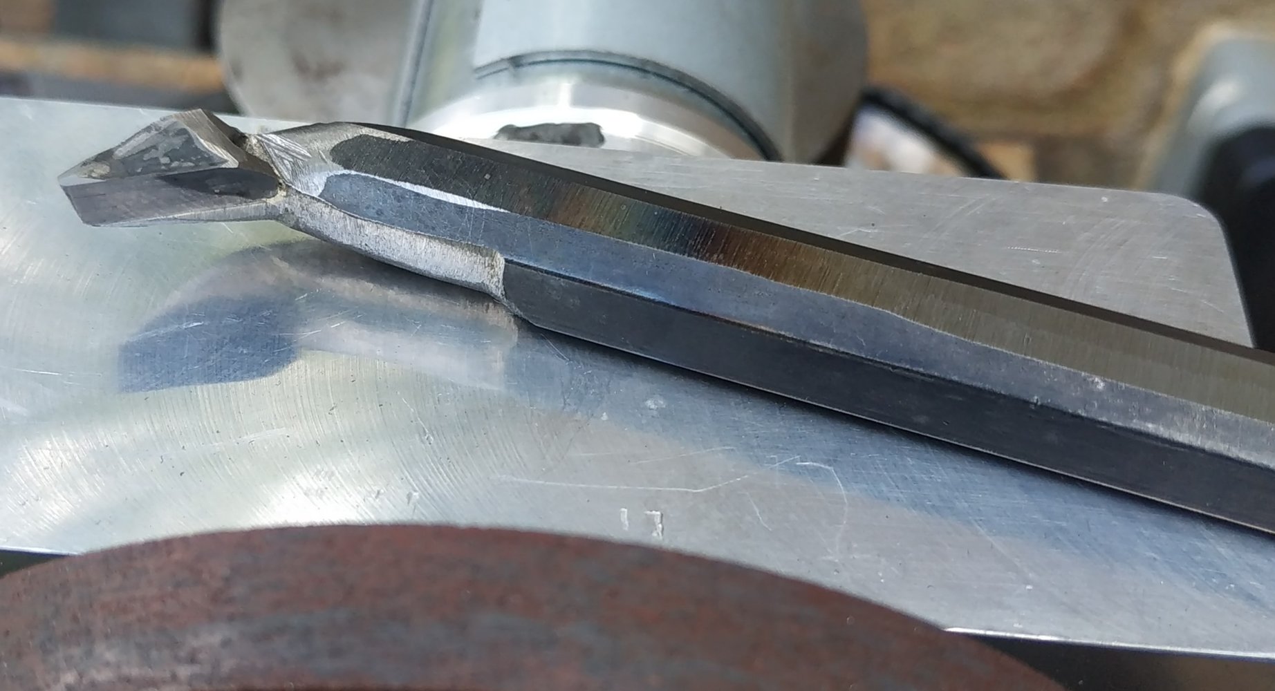

A left hand boring bar would help. Cant see any bent insert bars for sale.
I might braze an insert onto the bend of a hex key.

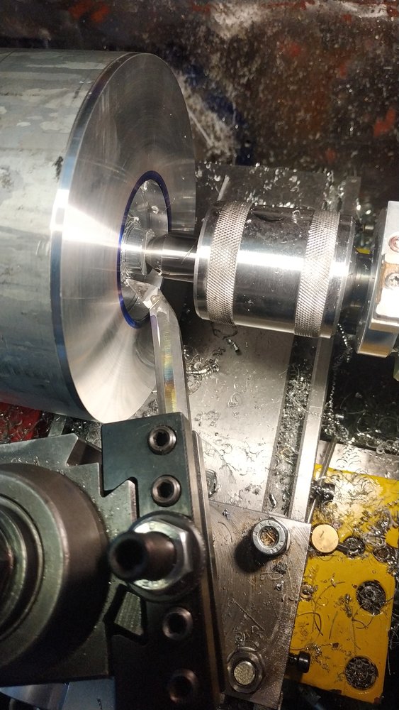

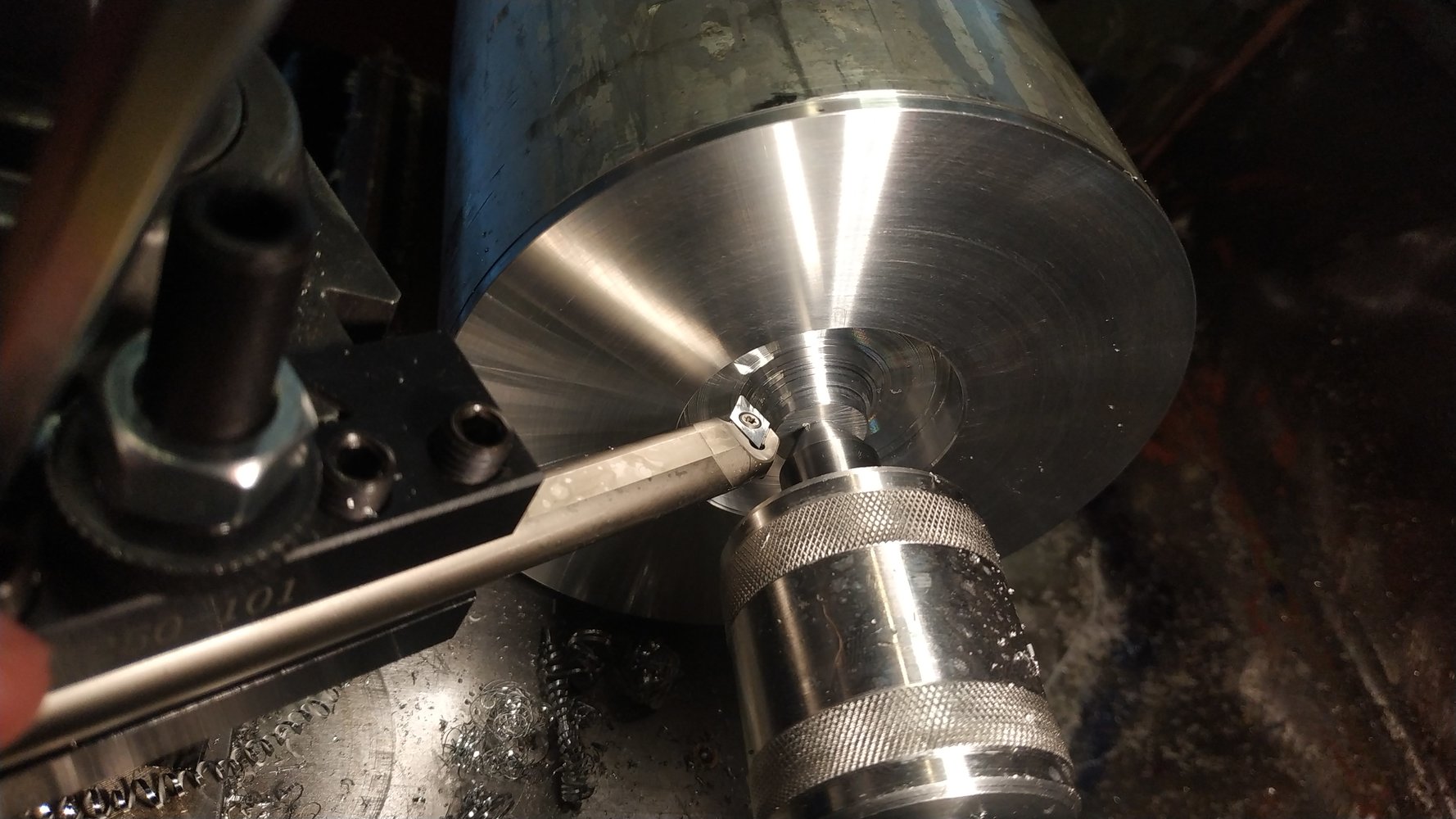

The plan is to eat the centre nub with cordless drills, but Im not deep enough yet.
