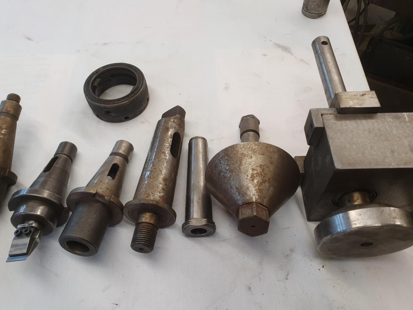

A few bits from my recent haul. Im not sure what type there are here? And what they worth
Thanks for that, quite a nice tool by the sounds of itMiddle one in second pic looks like a newall universal tool head.
Also sometimes branded as optical machine tools.
See Here page 18
Should do facing and undercuts etc. if it’s still in healthy condition. As Pete has suggested above…
