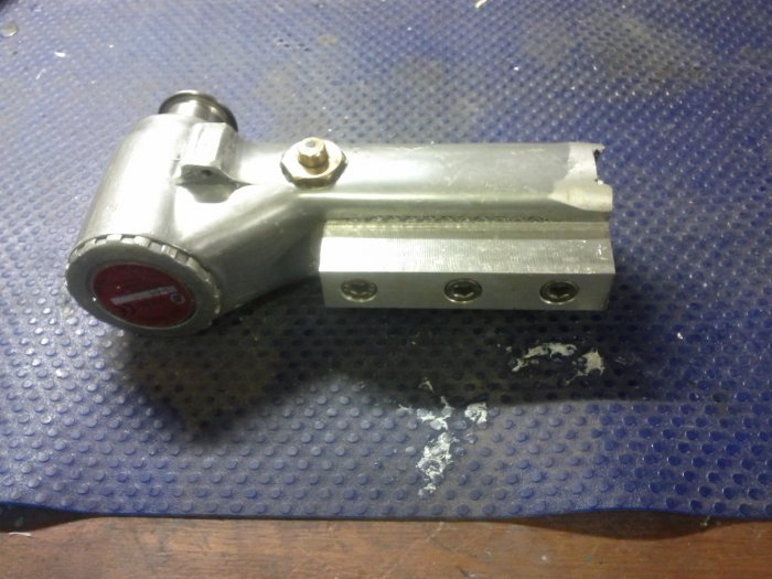

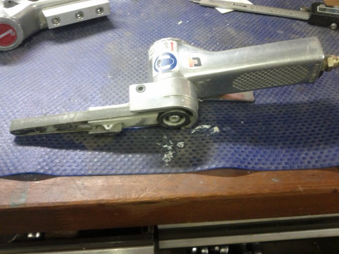

I've got a few of these Air sanders, the clamp that holds the arm to the gun, cracks, I have welded them up: they just found other ways to kill them.
RPM is 16,000 so should be good for this
http://www.mig-welding.co.uk/forum/attachment.php?attachmentid=33469&stc=1&d=1361777387
I didn't take any of the machining, all I did was mill a sallow grove for the 19x19mm bar to registor to, 3 holes for bolting it to the file, the holes in the file were placed so as to hit the webbing between the inlet and out galleries. M6 capheads were used.
http://www.mig-welding.co.uk/forum/attachment.php?attachmentid=33470&stc=1&d=1361777387

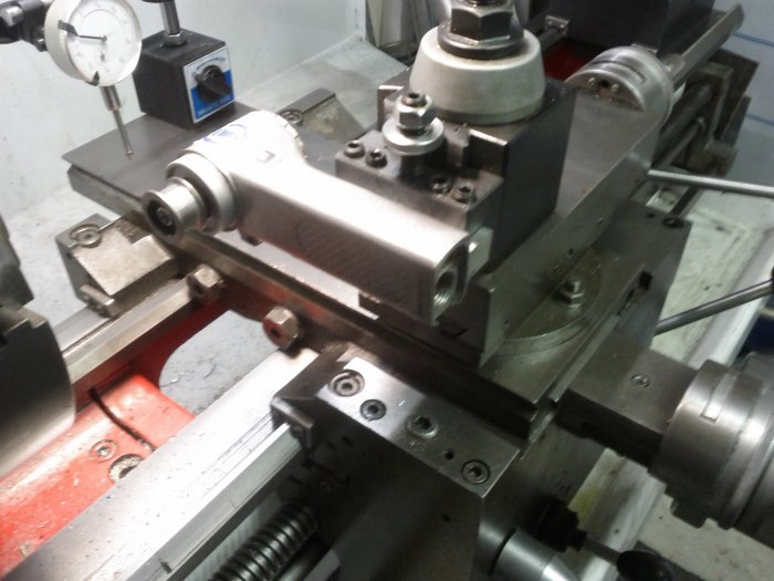

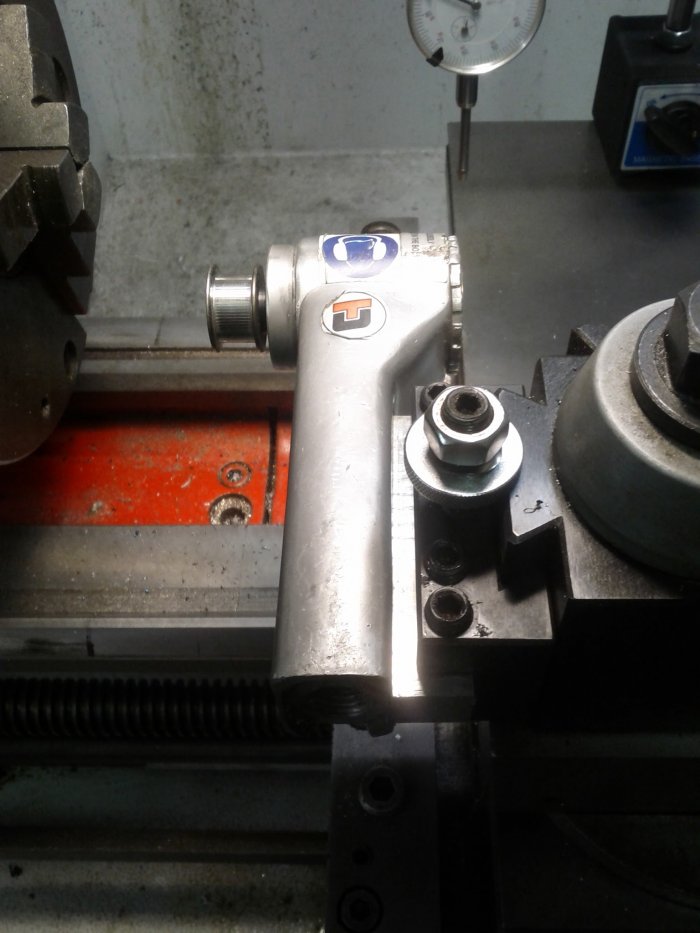

Couple of pic's of it on the lathe.
http://www.mig-welding.co.uk/forum/attachment.php?attachmentid=33471&stc=1&d=1361777387
http://www.mig-welding.co.uk/forum/attachment.php?attachmentid=33472&stc=1&d=1361777387
Just need to find some wheels for it now
