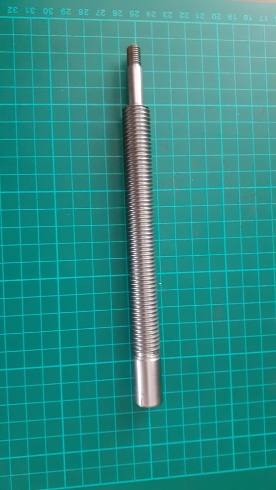

F fizzy Member Messages 13,859 Jul 14, 2021 #21 Holes spot on now and finish pretty good. No twist in bed. The level has an insane level of accuracy. Still made the Wyler sells for £3000! I didn't bother centering it accurately - I was looking for the change. Not much movement over 12".
F fizzy Member Messages 13,859 Jul 14, 2021 #22 Just had another play. I think I am there now. Pretty amazing for an old lathe. 10" long 2" diameter test bar. No tail stock.
R Rrobson . Messages 924 Location West Yorkshire Jul 14, 2021 #24 I don’t know about that. If you zoom right in I think your about half a tenth out...
F fizzy Member Messages 13,859 Jul 15, 2021 #25 Rrobson said: I don’t know about that. If you zoom right in I think your about half a tenth out... Click to expand...
