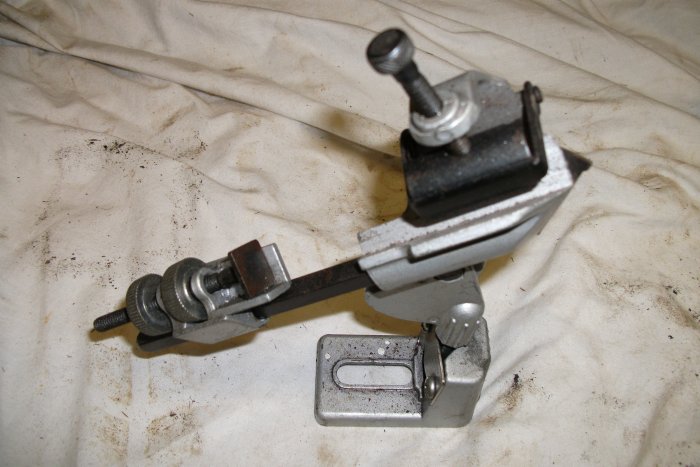

I have bought one of these and i am getting a very odd result with the primary grind
I get the rake in the reverse direction
The bar is parallel to the wheel axis
The jig is at the right angle
The drill is aligned with the right marks
I tried a copper bar in the jig and it is above centre
But i constantly get rake going the wrong way
