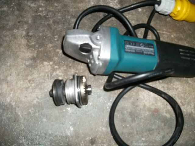

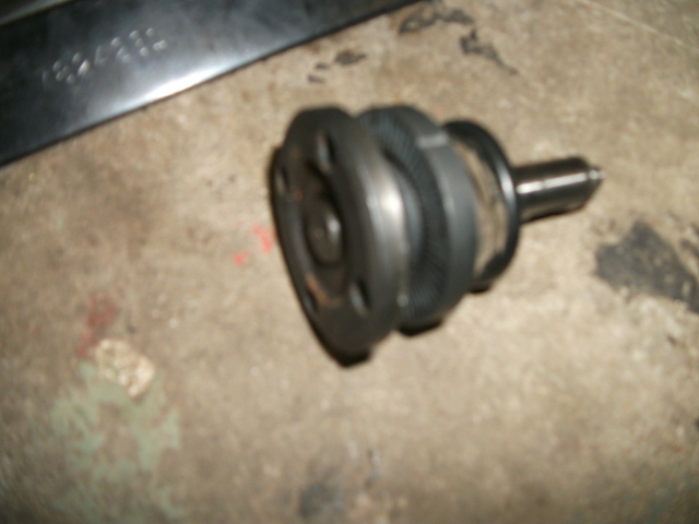

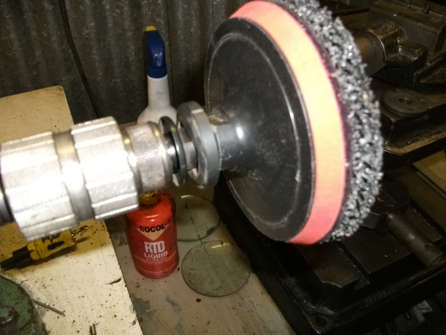

a quick and cheap way to get an arbor is buy or scrounge a burnt out angle grinder i got one nearly new for a fiver
just use the head of it and remove the gear wheel and it fits strait in to a half inch chuck .it takes all popular size disks and threaded for polishing mops and cup wire wheels ect
