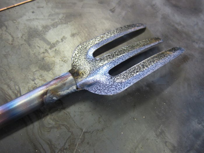

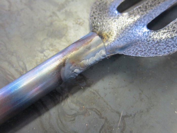

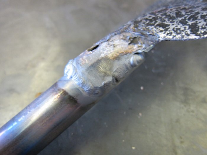

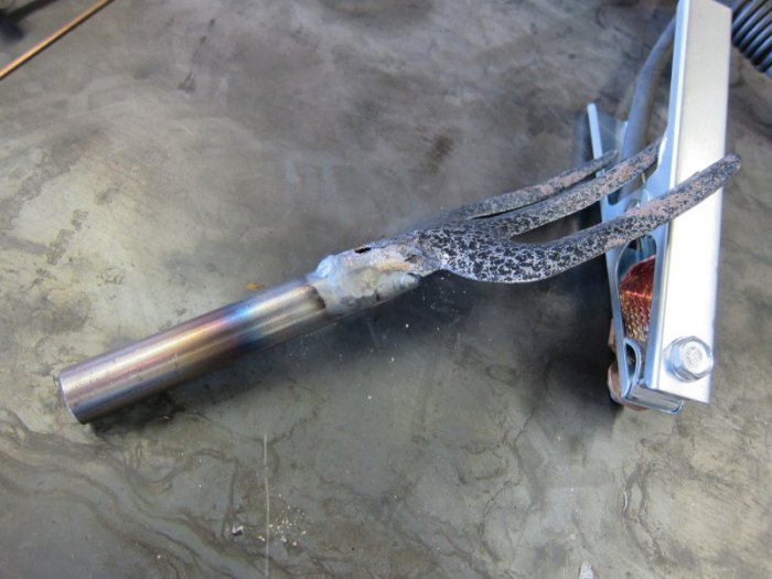

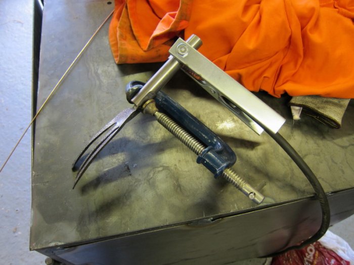

Was in the garage today, decided to repair the really cheap hand fork (had a poorly attached plastic handle that was even more poorly attached after I gave it too much grief).
Anyway, quick clean up later and started welding it. Pleased with the solid result, especially given the thinner nature of the steel of the fork material.
Of course for the cost of the gas, and probably the metal tube, I could have bought a new hand fork...

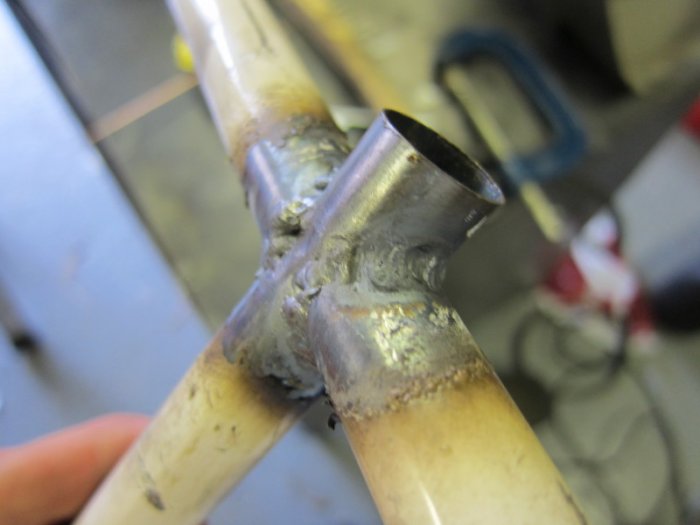

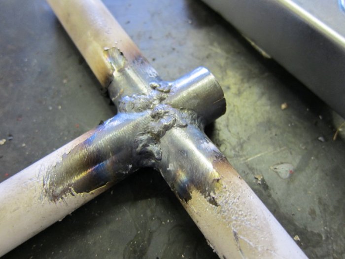

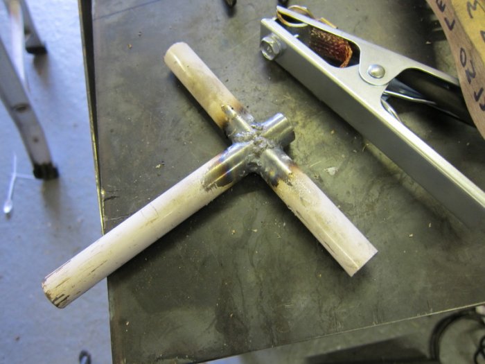

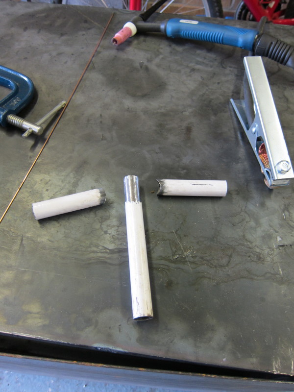

The second bit was a piece of tube I needed to put some handles on. First tube junction I've ever done, and moving down thickness. So prepped it up, so the fit up was good. Then proceeded to weld it together.
Made my life harder using 1.6mm filler, should've clipped off some 0.8mm wire from the MIG. Anyway, got through it, using the pedal, had to fill a few blowthroughs as well.
After I'd finished, I got the calipers out, wondering what the thickness was. Turns out it was 0.5mm! I was quite pleased. Still plenty to learn, but it's progress. One side is airtight too, the other isn't quite, but I can see the pinhole where I didn't fuse the end of one weld into the start of the next.
