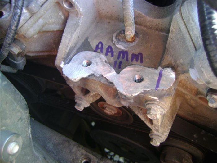

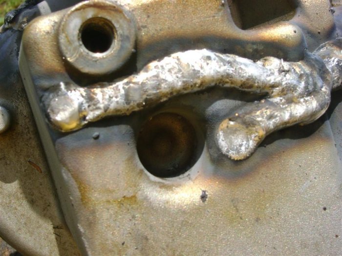

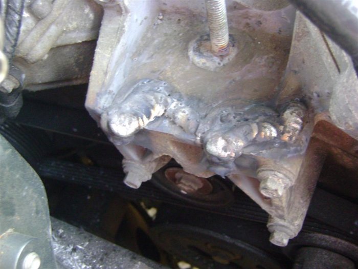

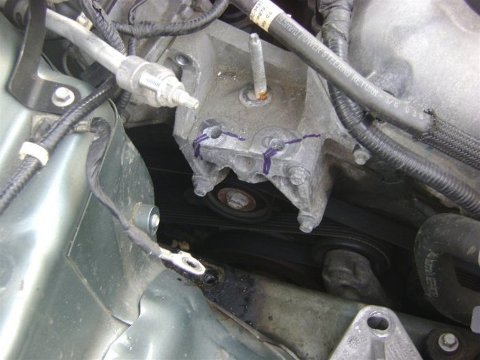

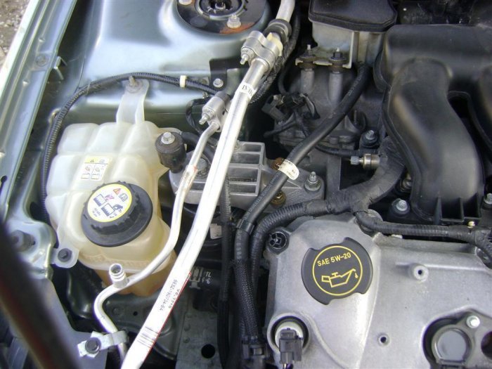

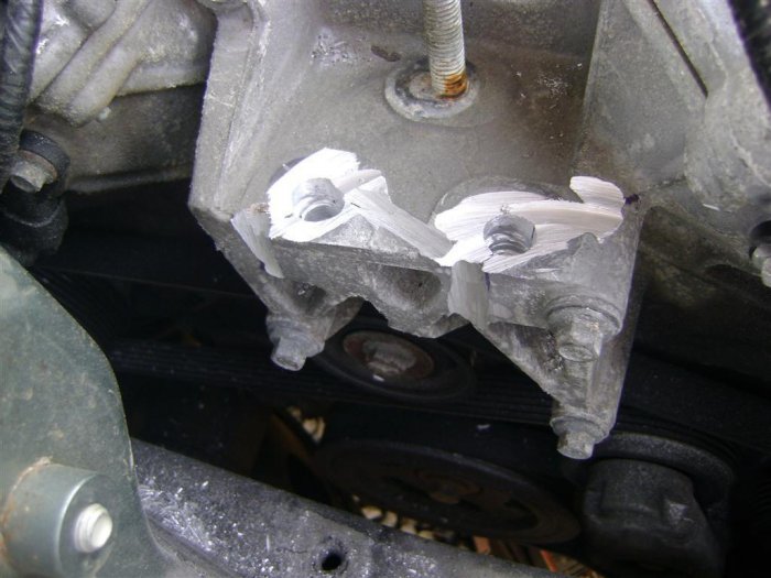

This customer has an '06 Fusion and hit a massive pot hole. Blew out both RS tires and damaged the alum wheels. It also broke one of the control arms as well as the motor mount which goes across the front of the whole engine. So he was refered yesterday to bring it to me hoping i could fix it in the car so he didn't have to tear out the V6 engine. He had the AC sucked out so i could take apart the lines and then i removed the radiator over flow canister and the frame rubber mount and the top of the motor mount that goes between the frame and engine. I veed it all out as good as i could and drilled the two stripped bolt holes bigger and tapered the tops to get as much weld as i could deep in the holes. Then i welded it with my 3035 spoolgun and 4043 .030 wire. Ground it down on the top and drilled and tapped two new holes and a half hour later he was good to go. Oh and forget textbook alum mig welding as i couldn't get the spoolgun in for the proper gun angle so i had to wing it...Bob
