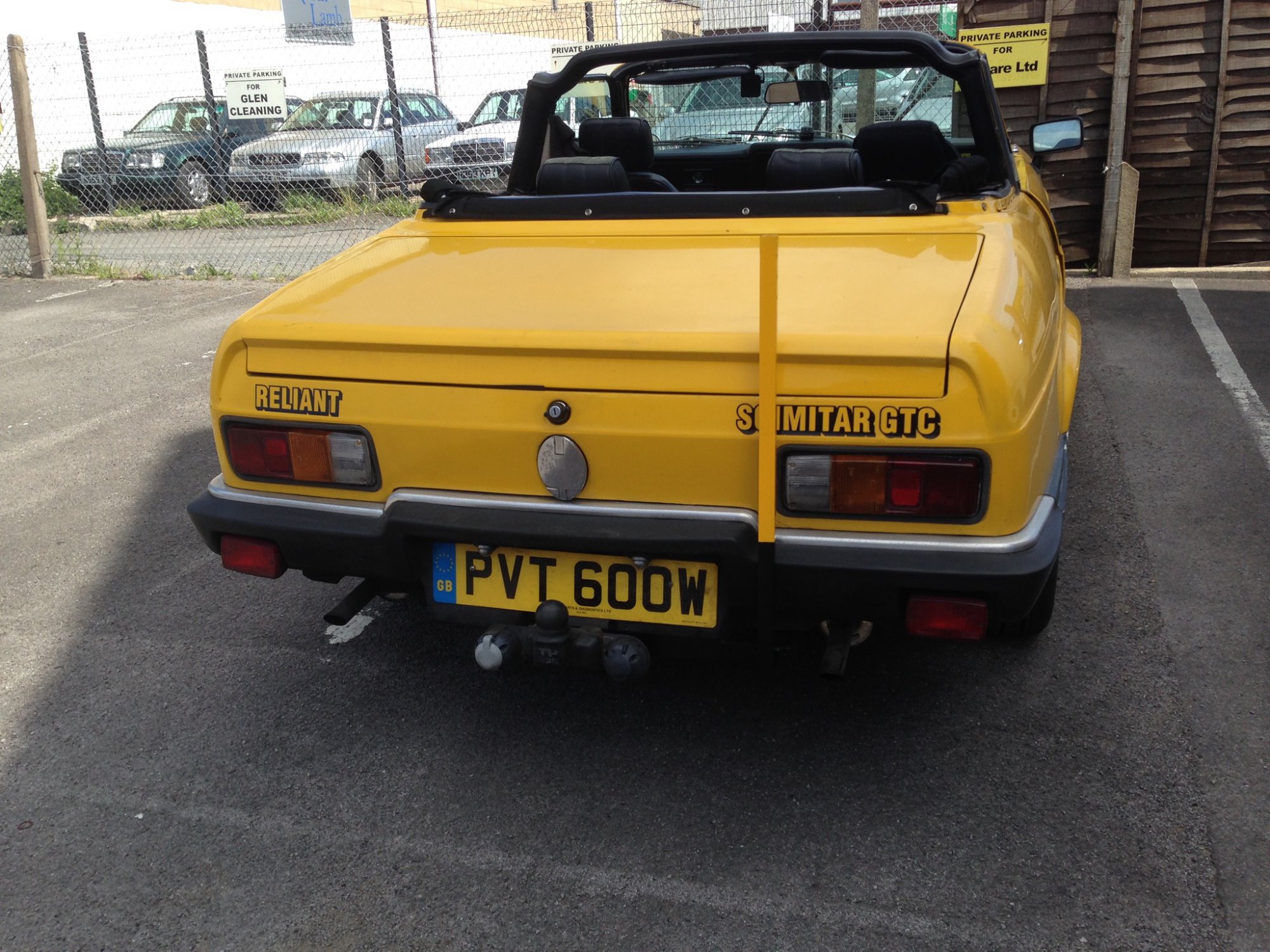

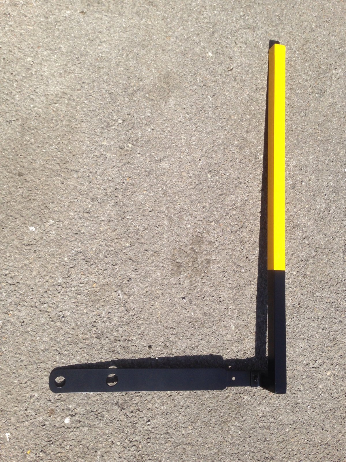

Building a mobile mount for a dual band aerial for the car. I decided it was good practice to use what I had lying around, so got some inch square really thin stuff and some 3mm plate.
The inch square I cut and mitred and only blew a couple of holes in it. I was able to refill them so on a scale of 10, I think I could award myself 6. I then cut another piece and drilled it half inch diameter for the SO239, before closing the end off with it. Seemed to work out.
Then it was a matter of weldind the other end to the 3mm. I aimed for the 3mm and sort of washed against the thin stuff and again, apart from a couple of repaired blow throughs, it seemed to stick!
Once all done and painted, I decided it was an obstruction to the number plate so decided to mod it. The 3mm now is just a mounting foot but then realised that the only piece of 3mm I had left was too short. I was going to butt joint the two pieces together, but for some reason I laid one on top of the other and tacked them together, totally failing to get any penetration. So a bit more power and with the help of a passing pigeon, got a passable job, score about 3. Then I remembered I was going to butt joint them! Oh well.
So then I locked up and left it for another go tomorrow with a working brain.
