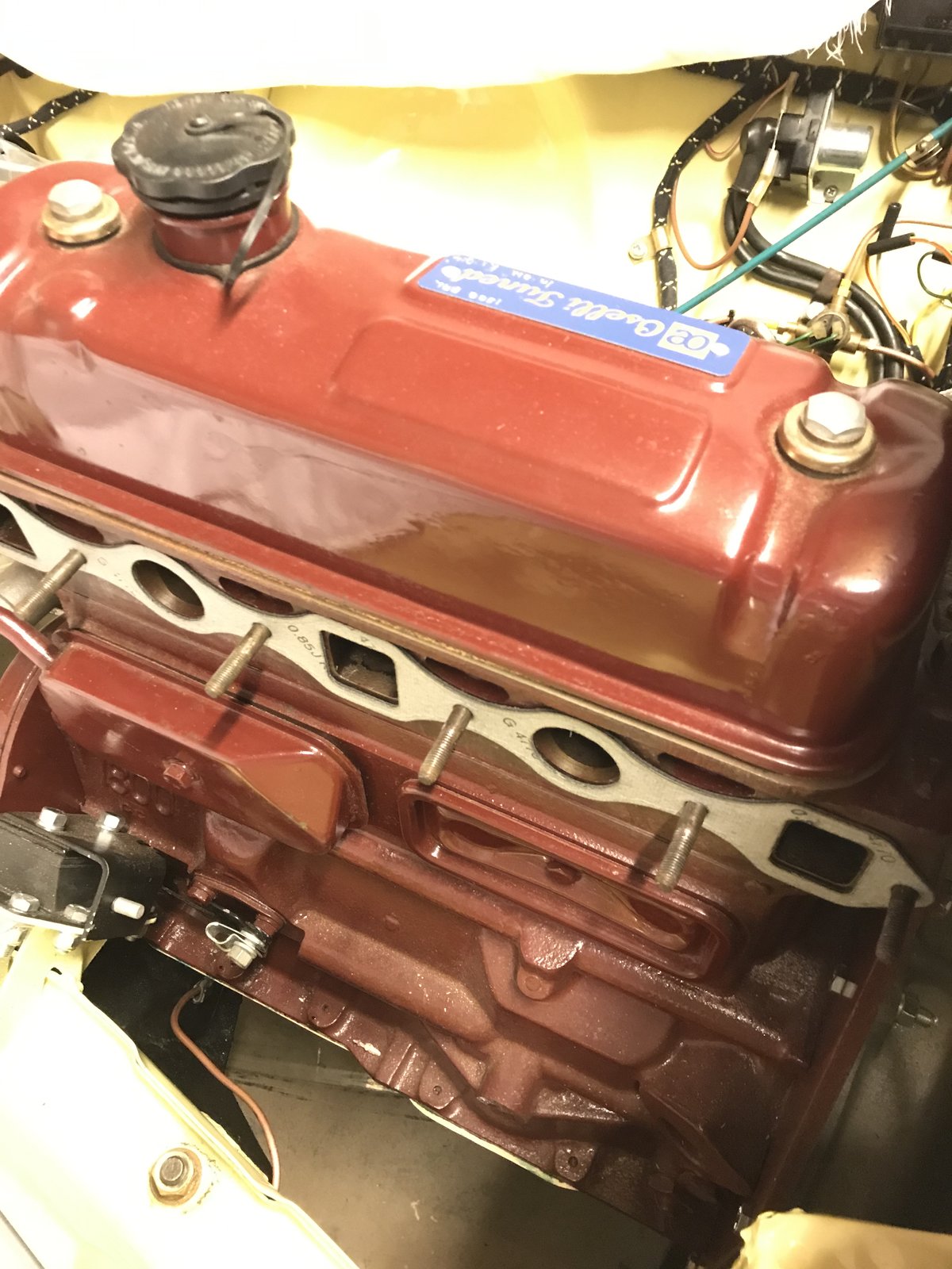

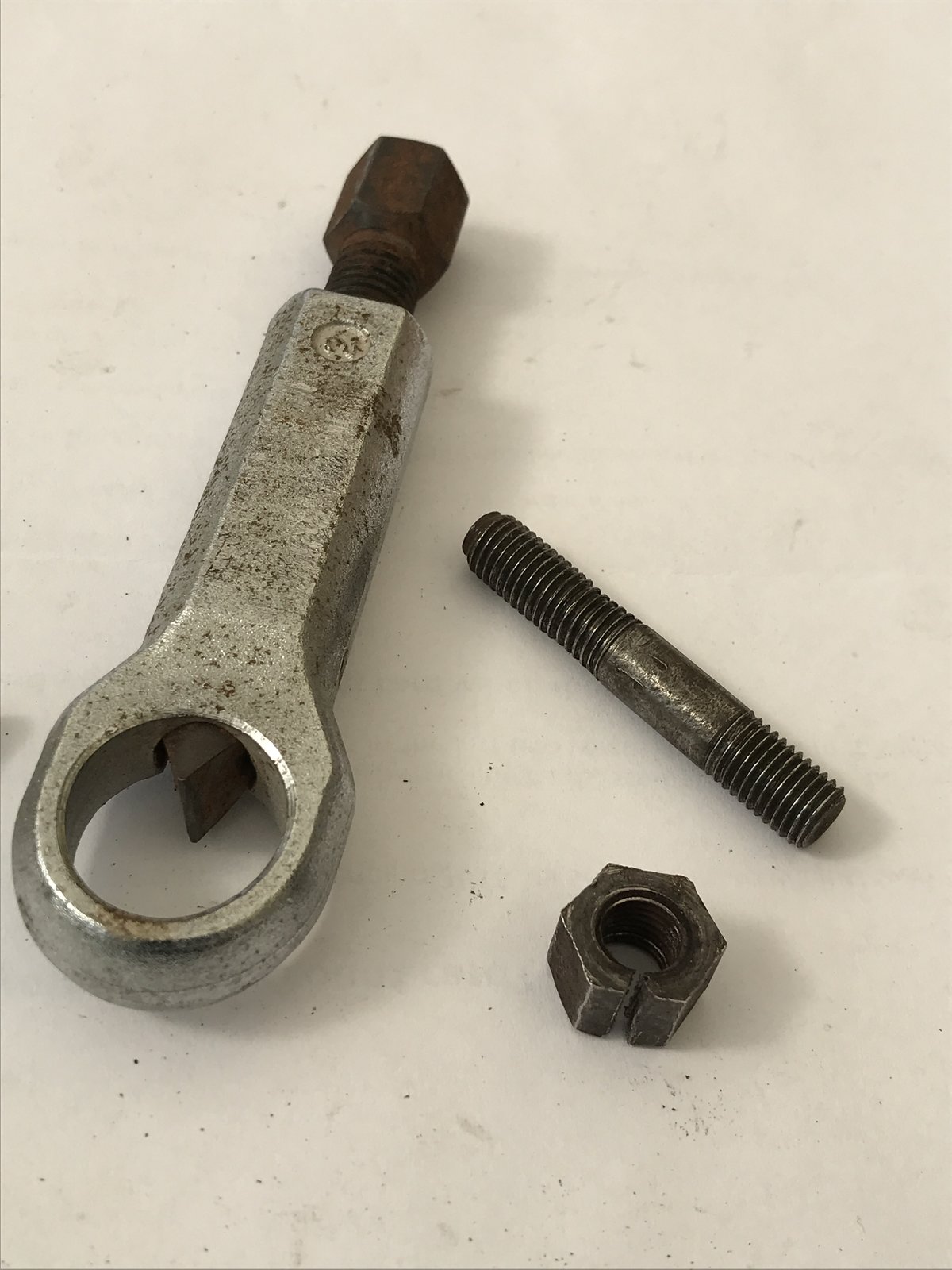

......I used a nut splitter to remove a nut seized on a stud.
This, after 24 hrs of penetrating oil, heat, then a pair of locknuts on the other end, had failed to encourage it to let go.
After a quick wire brush up and a light smear of copper grease, it went nicely into the cylinder head along with its 5 mates in readiness for the inlet & exhaust manifolds to be fitted tomorrow.
