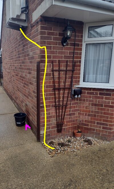

Id like to ask how your install drains and into what ?
Installer wanted to run 20mm plastic conduit straight down and onto that gap on the path, I feared damp issues and told him leave it, but it dumps more than I imagined ,bucket a day in winter...summer the sun might dry it as it drips?
What's the forums opinion if I was to run 50mm downpipe onto that small gravel area, I thought dig it out as much as I can and fill with gravel but would it cause agro with the house wall? I'm not where near any downpipes/drains and struggling to think of what I could do
